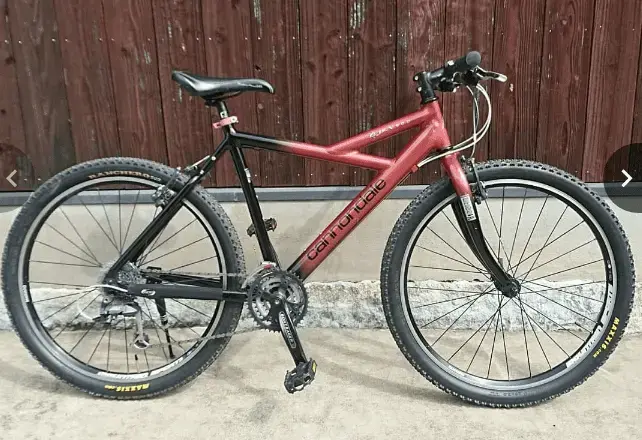

:eek: Aah, I’m going to have to check now.. Sure I read somewhere that they weren’t 1 1/4” til later on.. Will let you know.
Love your build btw, wicked choice on the forks, completely left field choice..

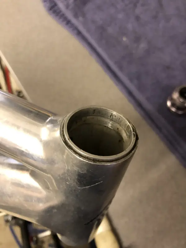

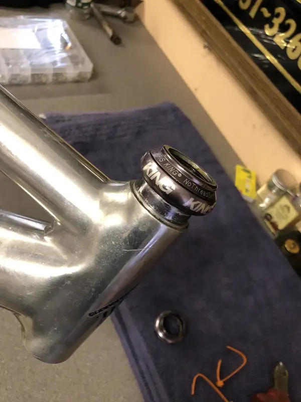

699A2258-38B1-4977-8CCC-E10A0D92A3F9.webp F3EBD434-70FA-4098-B89D-87CC2DCAB1B1.webp Deffo 1 1/8”.
Has these ‘shims’ in the headtube. But surely they’re factory? Doesn’t look to be enough material on the headtube without the ‘shims’ to mount a headset into - aluminium would be too thin I would say.
This is really interesting, I wonder why they fitted inserts, maybe it was just a transition over to 1 1/8. My 94 KV is pure 1 1/4, as was the one I owned back in 94.
