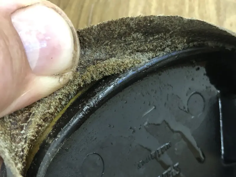

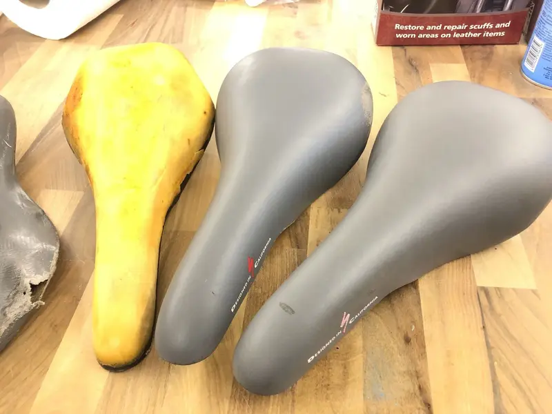

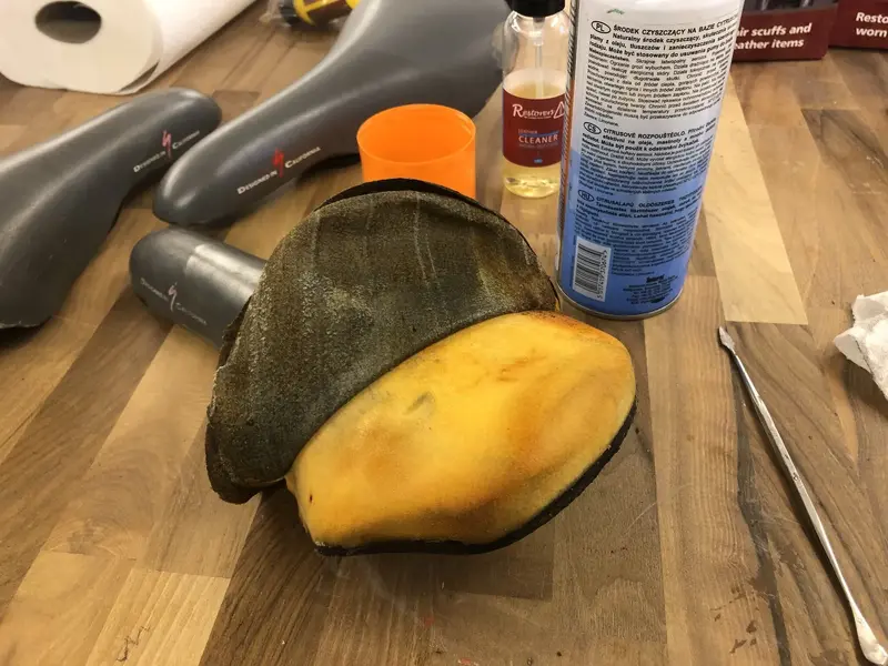

Right, had a play during lunch.
The two cromoā€™s have had deep clean and Iā€™ve skinned the Ti.
No real problems, the old contact adhesive needed breaking down first with the occasional squirt of citrus adhesive cleaner as I carefully removed it trying to save as much of the old foam cushioning as possible.
Happy with the result.

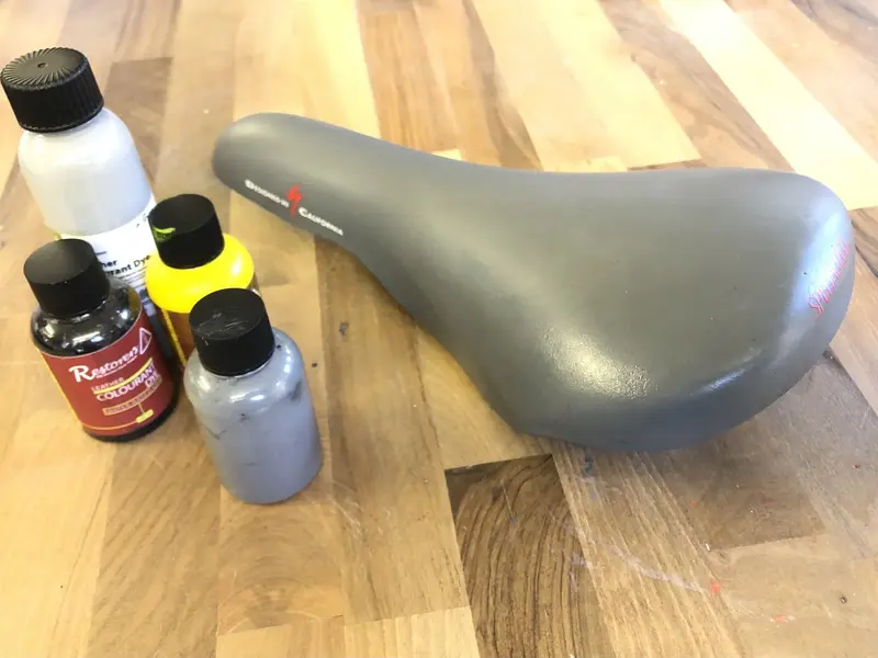

Dialled the grey in ok. Took a few attempts as first batch was too blue, touch of yellow sorted that.
Please note, the photo below is just a colour test, I wonā€™t be repairing any surfaces until Iā€™ve re-applied the leather.
And thatā€™s the warn corner, even as a tester itā€™s disappeared on the face of it.
