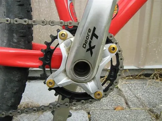

I've updated my ritchey p-650b to 1by10
Conrads
recently changed/added
Ritchey carbon fork
Shimano m987 dick brakes, m985gs shadow plus clutch rear D, m980 11-36 cluster 10spd xtr chain
Revolution components 30t single ring (NZ designed and made)
Flite TT SLR saddle
weight now into the 9.2kg range.

Fast and furious :) p-650b, is that 27.5" wheels..?
9.2 kg :shock: that's heavy for such a beauty.. are you using lead-spokes..? :wink:
lol Biocandy it's lighter than my steel SS. :)
yes you could put a 2.2 in the back but you would need to be careful of wheel flex. I've seen a few 29ers who have gone with big tires only to cut into their chain stays. Not good on a HT and no warranty either!
Yes Posh Mark the current tires are Kenda Kama 2.0 or Nevagal 2.1. The stans rims let the tire bulge a bit more than say mavic rims. 2.2 on the front no problem. but I wouldn't go bigger than 2.1 on the rear with the stans rims.
Yes Biocandy 27.5 inches :)
