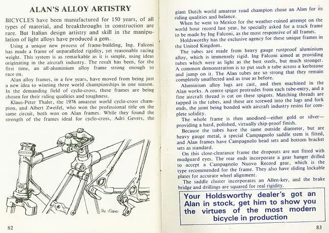

Don't the fancy engravings identify it as an early'ish one?
Also this document - which shows the engraved head lugs.

yup, we never sold the alan frames but saw a lot of them in the road races and club runs back in the 80s. they came in blue, red and black if i remember rightly. i reckon that this frame is dated around 1985/86 possibly slightly earlier by a year or two. nice frames but not if you have a belly or are over 5' 6"!!!! with mavic ssc it would have been one of the lightest bikes of the era - a hill climb special!
nice find!
