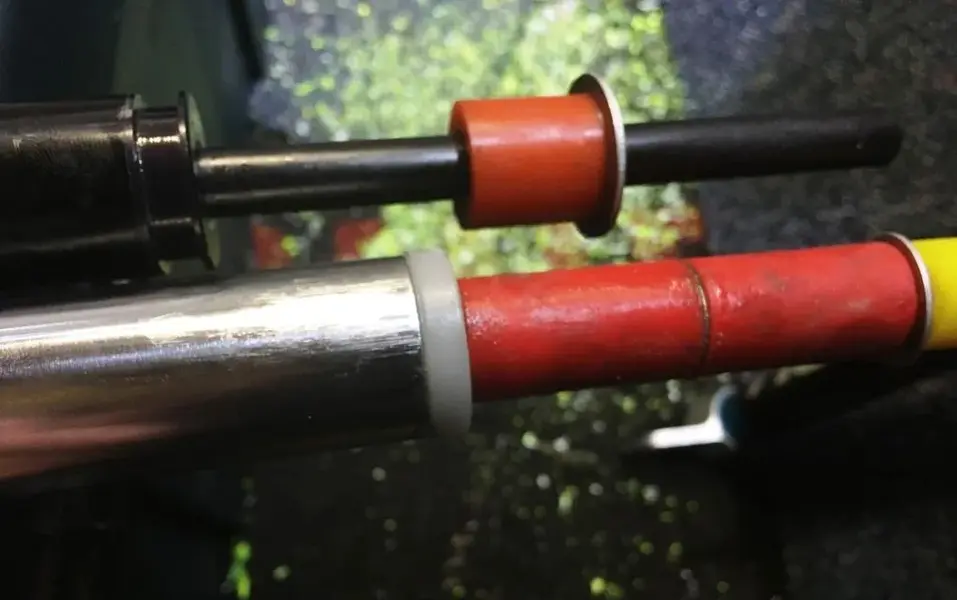

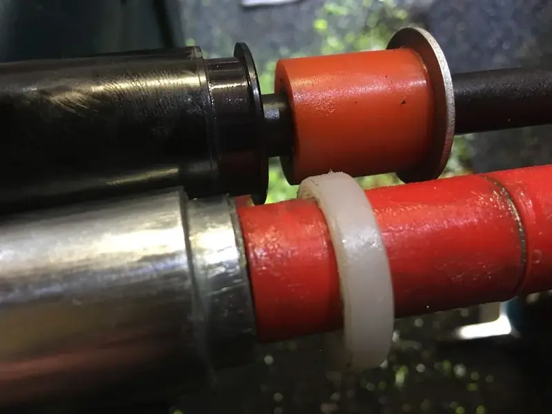

My initial thoughs regarding the semi seized legs was somebody had put Manitou 2 legs into Manitou 1 lowers however as I discovered the diameters are the same so even if they had it wasn’t the cause of the stiction
The Nylon slider were carefully removed and cleaned (which made no difference) so with nothing left to lose I gently polished the outer circumference of one using the very tiny lines in the mouldings as a guide to how much I was removing after three of four test fits and removing a bit more I finally got close to a fit I was happy with -perhaps still a bit tight but better than too much off (I accept that doing what I did by eye means in reality when magnified the bushing is more like a 50p piece than a perfect circle now) but it proved a point
Now for problem II … whoever tackled the problem before me must have chucked them back together in hurry as neither legs have the lower sliders on them, so whilst they go up and down nicely the front to back play in the legs whilst minor on the bench would create a massive amount of chatter / judder under braking
Thanks to the benefit of RB brain power it turns out Mani 1,2,3 have the same size legs diameters (Manitou III’s having different length legs) so an otherwise set of mint M3’s have been sacrifices for a greater good – and stripped of its Nylon bushings
The only thing I’m not happy with before drawing a line under this episode is how to retain the lower bushing on the leg when its in an area covered in Elastomer grease – since it slides on, it can easily slide off

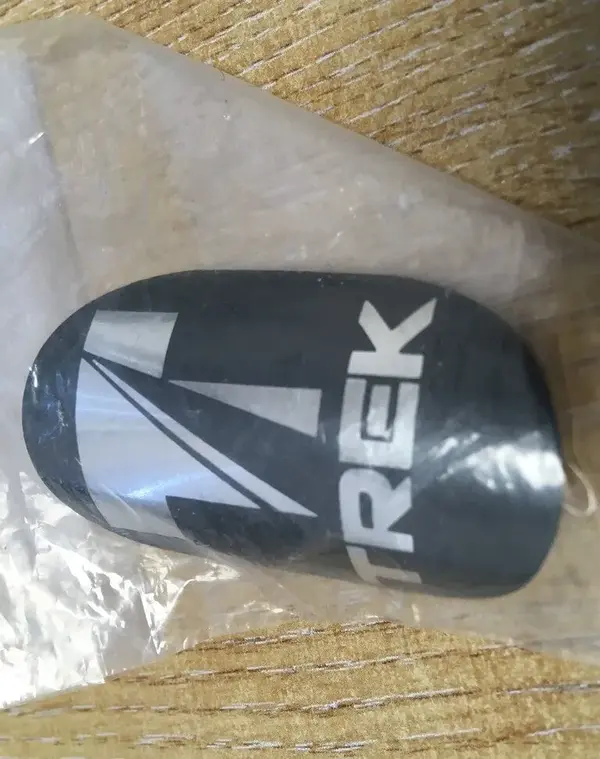

This came up on ebay for a great price and post free :D - except there isn't such a thing as truly free postage the cost is added to the item itself (obviously) however the total was still very attractive so I went for it ....so whats the catch ?
since all the cost was in the purchase price and not split with postage it pushed me into import tax zone and then followed the added £8 royal mail fee to collect the import duty :x which was more than the HMRC duty they were collecting
Anyway - one period correct Trek headtube badge

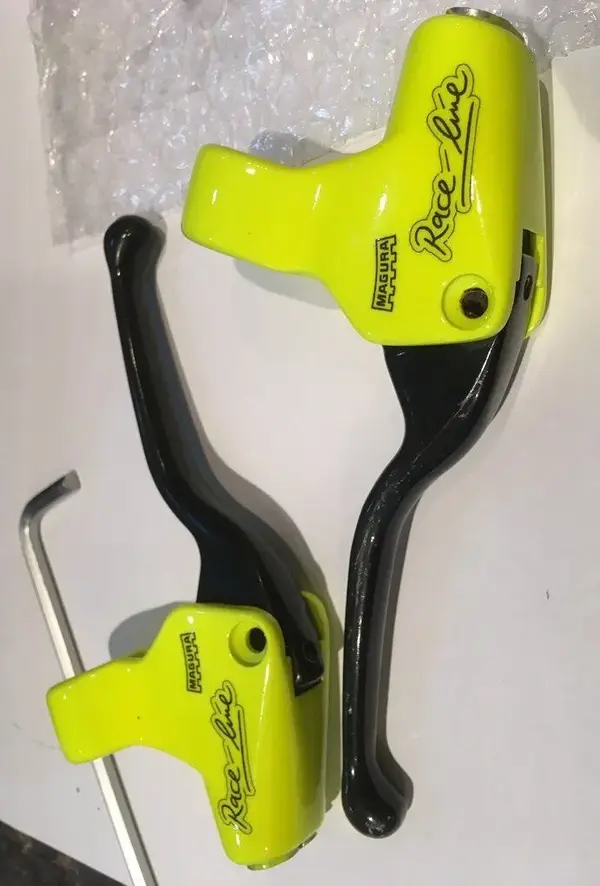

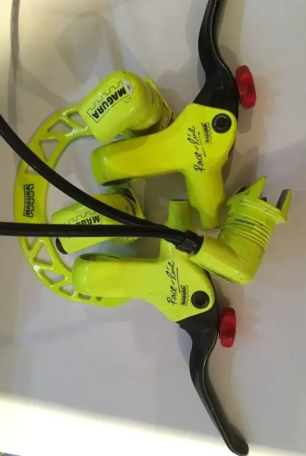

Having looked at the historical time line for Magura's and having used HS22's on my Porsche build, and HS22's being more suited to the early 90's I thought I'd swap the HS33's for 22's but where do you find them for less than the annual GDP of a third world country ?

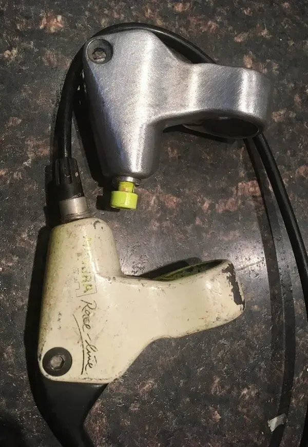

Via an eBay search I found these, advertised separately one was missing a lever and also the hydraulic piston/plunger - but so cheap it had to be snapped up (it had been stripped for a paint job at some point in the distant past)

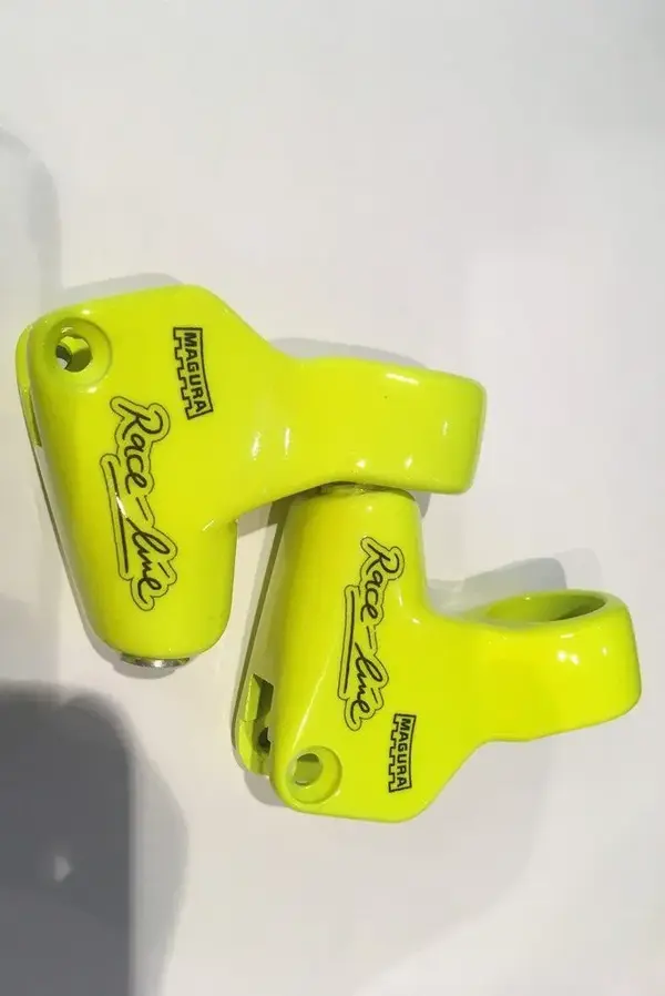

After a bit of practise/testing with various shades of so called "Neon" on a selection of bolts undercoated white I ended up with this which is suitably zingy after three coats :D
Purposely went with "not quite right" decals to avoid upsetting anyone's sensibilities about re-finishing (mine have got the black outlines and tiny Magura logo) and thanks to the left overs from the Porsche build I have a spare lever and piston

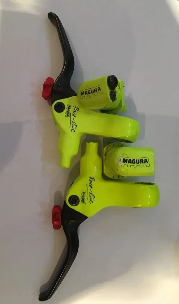

being German engineering I’m not sure what I was expecting to find inside - probably quality over engineering however I was surprised by their simplicity, one plastic piston, single rubber O ring acting as the seal and a surprisingly strong return spring.
I'm pretty please with them - whilst HS33's are easier on the eye and less agricultural looking, 22's are more antique in appearance and hark back to a golden era now long gone and consigned to the pages of faded catalogue scans along with their earlier stable mates Hyro-Stops
so these rejects (Brake levers) are going into storage and then I need to strip and clean/polish the crap out of the dirty brakes and brake arches, I've purchased two "hard bristle” tooth brushes especially for the job, just hope the results give me a nice smile :facepalm:

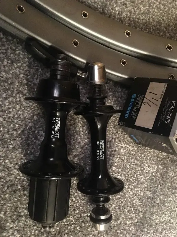

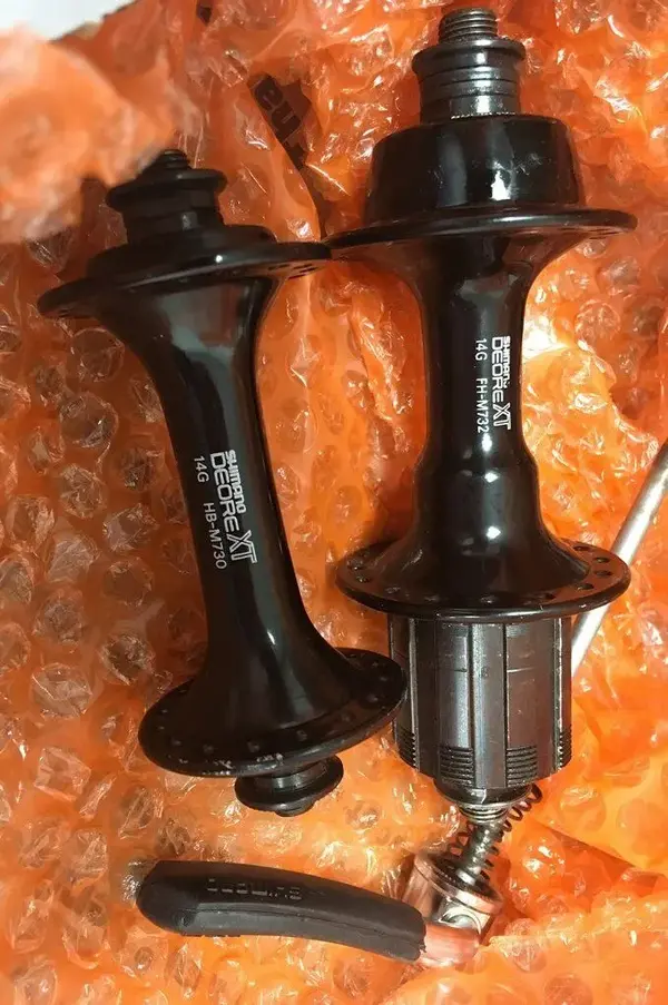

After scouring the planet for a pair of 32 hole Black XT hubs and bumping my wanted post - I realised at the weekend my Grey rims (that go so well with M1's) which I've been saving for ages are in fact odd 32/36 holes :facepalm:
it was only when the rims were side by side that I notices the holes didn't align !
So all this time I've unwittingly had these hubs in the right drilling (32 front/ 36 rear) to do the job :roll: and the ones Regan recently found for me from the States at expense of a Kidney and my first born child aren't needed (but I have plans for them elsewhere now)
fresh from the US of A
whilst I was waiting for a break I read a post from Gruff who had converted a 7speed hub to 8sp so thought I'd have a go - which turned out to be surprisingly easy * and the 36h rear I'm using is now an 8speed with the axle spacers re-aligned to compensate for the longer freehub body
* I've kept all the parts just encase it doesn't work !
To give the greatest contrast to the Zeon Yellow I'm going Black XT on this one :lol:
