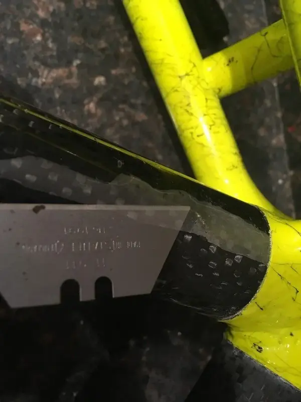

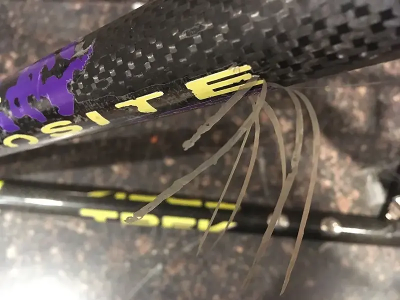

and it just peeled off like a cheese string with little to no effort what so ever. The only areas where the clear coat was still mildly stuck was under the decals where I'm guessing the UV light had not penetrated.

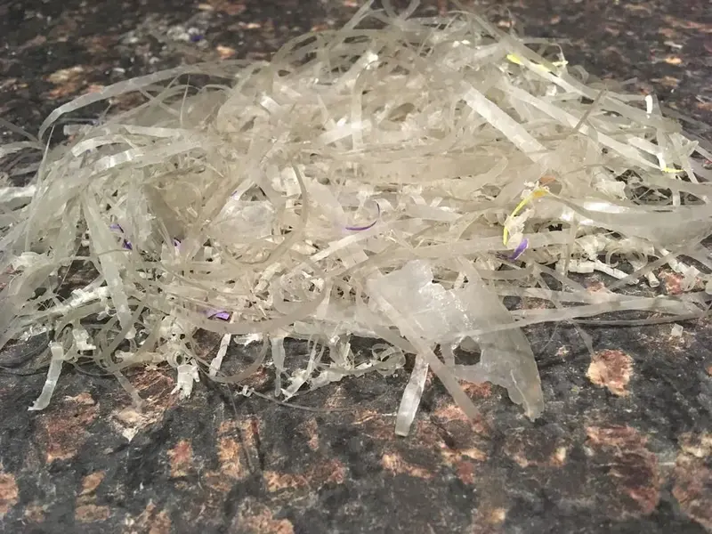

Before I knew it I had a piles of the stuff !

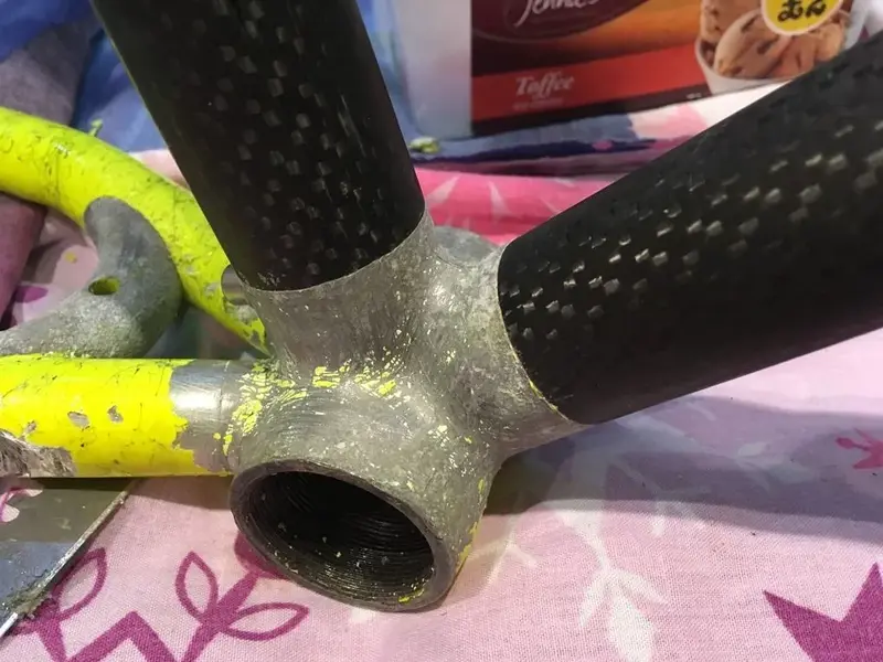

and AFTER - check out that NAKED carbon 8)

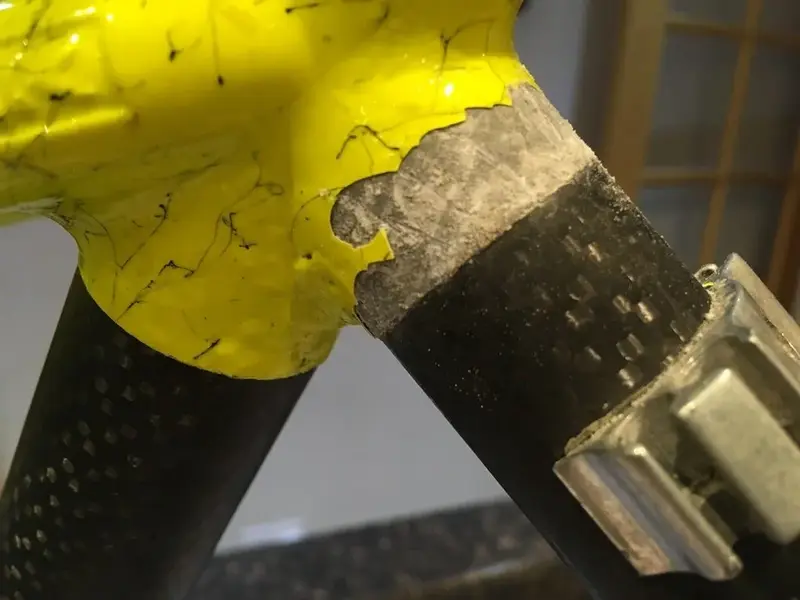

The reason for the paint coming off was..... well it just came off in massive chunks - so the lot went ! some areas need the careful application of paint stripper but only on the parts that the paint was actually stuck to the Aluminium. which was a minor blessing as Nitromores these days takes ages and does jack shit

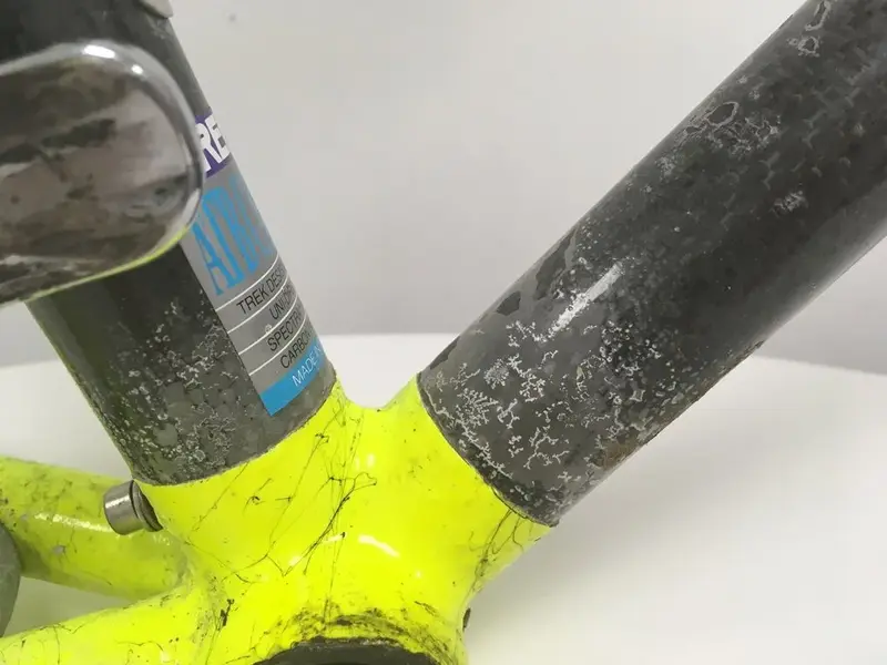

Anyway here's what was under the paint.... real patina - 28 years worth, looks alarming but cleaned up a treat with a scot pad
