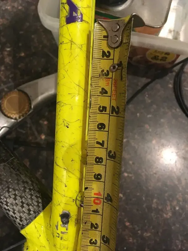

enc":3vvg1z2w said:
nice project. how will you refinish the yellow and black squiggle bits ?
That’s the biggy
My 1990 TBG Cindercone is Spatter painted and whilst I’ve read its not as easy as many think to convincingly reproduce the results, on this it’s quite different the black is more like fine wavey pin stripes/Hair etc rather than blobs – far more subtle / perhaps refined. I’ve marvelled at it, gone away - come back for a second and third look and to be honest gone away again
Rather than try to make a crude pastiche of the original I’m toying with just staying with the Neon Yellow or RAL 1026 aka Luminous Yellow on its own alongside poptastic Carbon
Not the best picture in the world but the best I have to show the black hair like random pattern adorning the yellow
1991 Trek 8900 Neon Yellow

Spud... the black squiggles are easy, you just need static electricity to give you a helping hand.
Try this on a test piece;
1st rub the tube in one direction (a lot) with something that releases a positive charge like dry human skin, human hair or animal fur.
2nd dip a brush into some black paint (humbrol enamel for example) when you get within about 10mm of the charged surface, the paint will leap off the brush in exactly that squiggle pattern, I promise.
Come to think of it, carbon fibre is an excellent conductor... so you could try linking the component to the negative of a car battery then linking with a wire and a crock clip the metal part of the brush to the positive... the paint will probably jump an inch!
