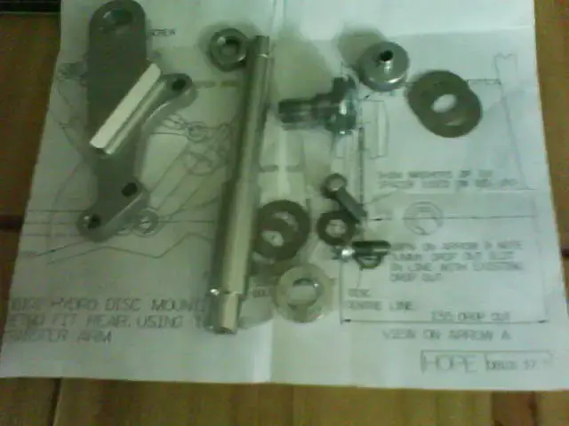

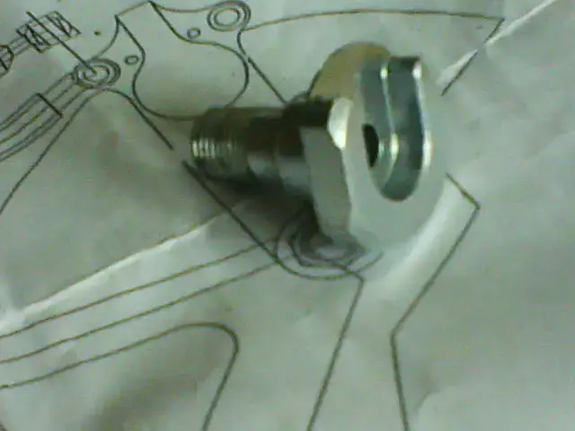

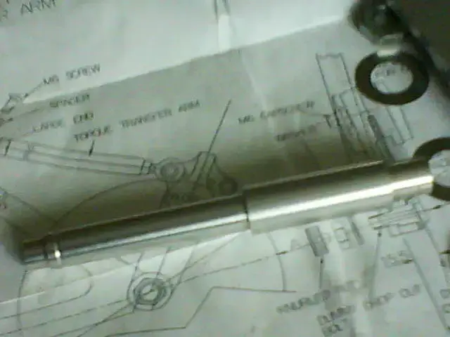

I have pics .
My torque tube is the same as the one attached to your caliper , the rest is the assorted bits that came with it . The main mystery being the dummy drop out , on the drawing i have it looks like it mounts oin the inside .
I bought the shortened axle off ebay thinking i might need it , but i cant for the life of me suss this out . HELP !!!!
BTW i'm running Hope XC disc hubs .

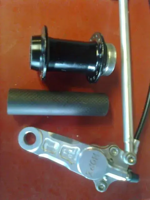

Do these pics help anyone
Twas my clockwork set up for discs

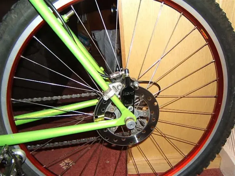

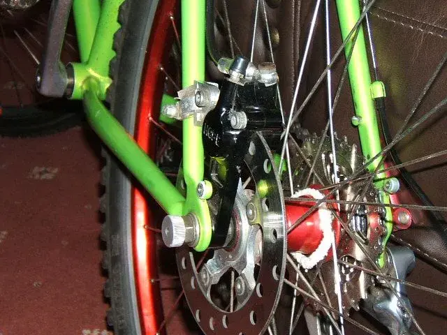

pete,
Looks like you have the version that takes any IS mount caliper. I'll try and get you some pics in the morning - I've one mounted here with an Avid caliper, and it works fine.
here you go:
fit the short axle to your hub (as long as it will fit - old hope sport or xc hubs seem fine). The dummy drop-out fits inside your proper dropout, with the big nut holding it in place, and with the slot lined up with the dropout on the other side, so the wheel can slip in ok.
your QR then threads all the way though and into the special nut supplied.
any IS disc brake then fits as normal.
This one is on the wife's XS cannondale, and I had to file the brake mount slightly to clear the back edge of the dropout. Also, make sure you use very low-profile rotor bolts, or you'll struggle to get the wheel in and out. Other than having to remove the QR completely every time, it's a very good system. Oh, and don't lose the special QR nut, or you'll be b*ggered.
