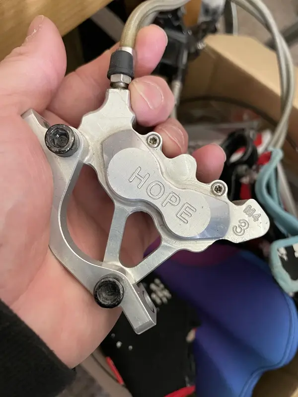

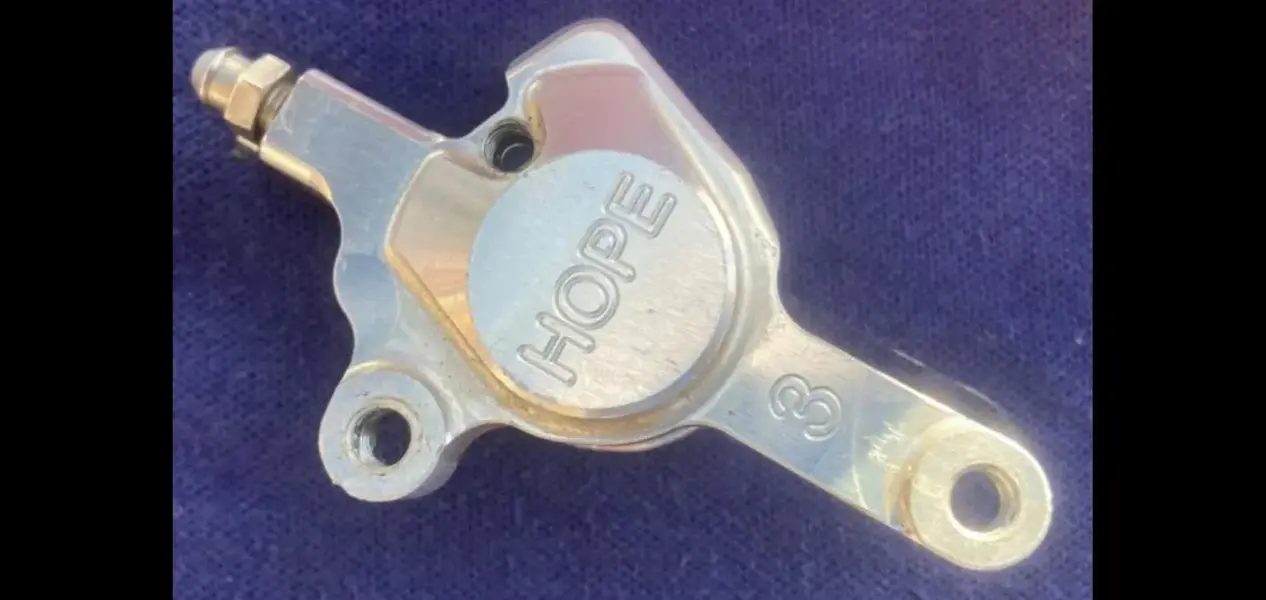

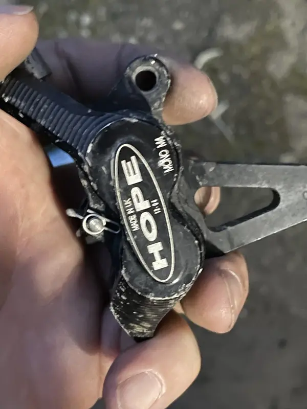

I don't remember mono minis coming in fittings other than IS/PM, but there's mention on this thread of a 5mm difference in disk size
Examples attached here.
The silver came with a Hayes 203mm rotor and a Hope Mono Mini / M4 180mm
The black set came with no rotors at all

A Mini caliper & all previous Hope hydraulic calipers are made of 2 halves held together by Allen bolts, the Mono & later caliper are machined from a single piece. The silver caliper is a Mini M4 & the other is Mono M4.
Yeah I know that bud. It says that on the calipers 😉
What I was asking is ;

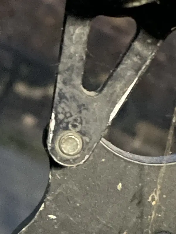

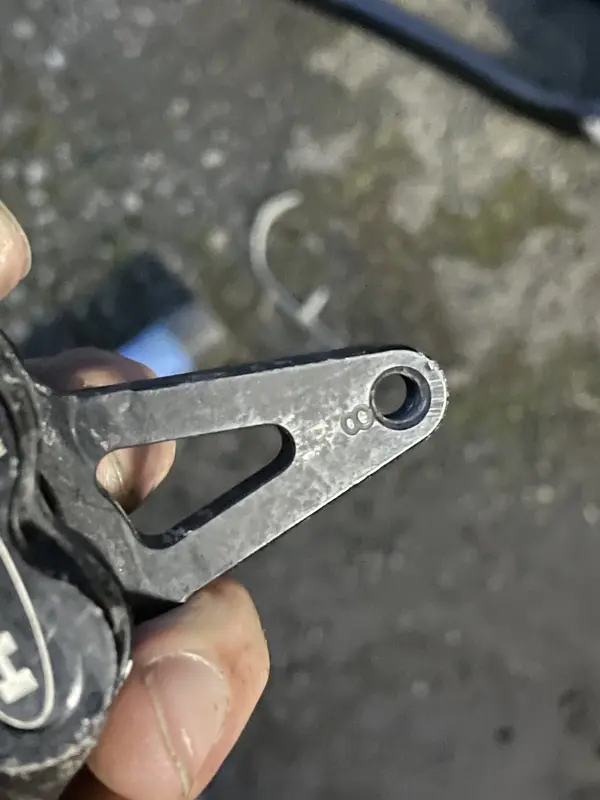

If that list doesn’t apply to my Mono mini’s because they are Mono. And mono seem to run 5mm smaller. Does that mean my Mono M4 should also be 5mm smaller than that list and my M4 should be exactly as the list describes.
Apparently yes the Mono disc sizes i.e. 200/180/160 apply to Mono M4 also, you may get away with that 203mm on the Mono too.

Thinking laterally here I'd suggest going for a post mount version which is based on a 165mm rotor and then space it out to suit using the Avid style v-brake conical washers (which would take up any mismatch between the two bolts if one needs to be spaced out more than another) up to the 185mm rotor you have. It might not be as neat as you'd like but the rear disc mount on that bike should be IS and seems not to be, so it might be your only choice.
