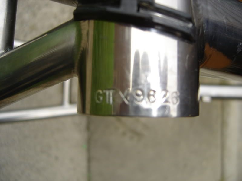

My Xizang has no serial number on it. I got the frame of a friend in 2000 who owns a bike ship in Chicago, who got it from the local GT wholesaler when they had a clearance sale. The only identification on the frame was 3 letters (initials?) written in felt tip pen on the top tube. My friend seemed to think it was an un-issued team frame.
Another thing that is different with this frame is the brake bosses. They take a U brake stud but are in the right place for cantis (U brake studs have a different thread and are thicker so a canti/ V brake won’t fit on them). I got a set made up with U brake thread with the thinner and longer canti stud, which has worked perfect with maguras ever since.
I too had one about 4-5 months back that was mint, very few miles and had no serial number on it. LQQK did you look under the bottom bracket cable guide? I've had a couple that where the serial number was totally hidden underneath it.
Out of curiosity I just took the bottom bracket cable guide off, no serial number there.
