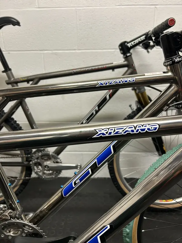

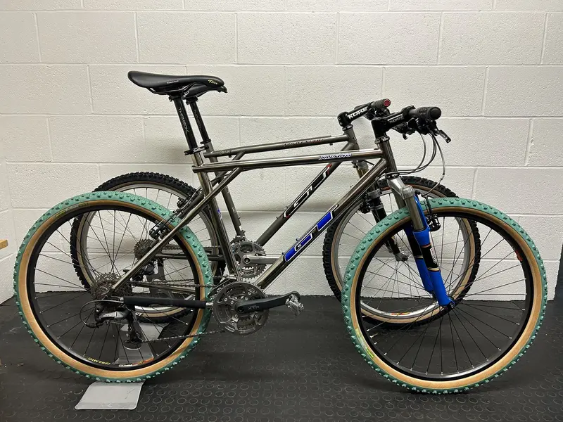

They don't half look pretty though🤩
Yes Jamie Lynn has one. It’s truly a lovely thing and very rare
And don’t forget the steel Xizang of 89. Complete with browning bits.
It should have won the Show and Shine. A tremendous build with the most eye-popping fluro I've ever seen on a bike.
Were the Lightning decals only in red for the 1998 and blue for 1997? Mine are blue but I’d like red, don’t want to lose it’s originality though.
