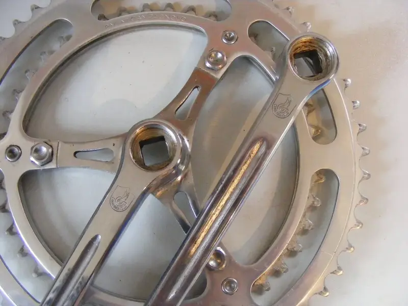

top advice chaps, Im about to restore an old Claud Butler for a friend and it has an old 3 arm campag sport chromed chainset on it with rust , I'll try the aluminium foil in vinegar.
ah! I found a bike with one of those cranksets, rare as rocking horse poo , polished with alu foil as seen in pic and sold the crank for 100 squid a collector in Taiwan and used the money to pay for the restoration :) result!

Yep that's the one ,won't be mine I'm afraid as I'm doing it for a friend. Do you rub the cranks with the foil?
Yep, foil with vinegar on the rust...if the rust is bad you can also use a copper wool scouring pad :)

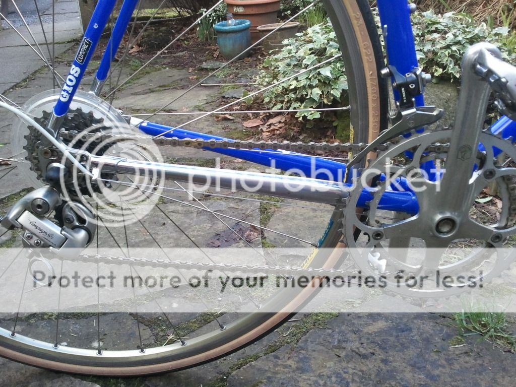

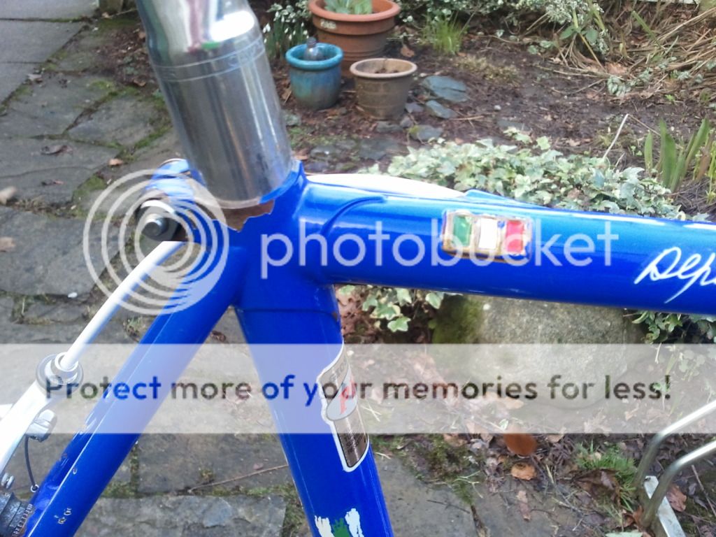

All pretty much done now. A few things I 'could' do to it, but can't be bothered - I'm riding it!! DoubleDee was kind enough to through me a few bits to complete it. Gears work a treat (a first for my mechanical experiences with Campag...). It needs some better blocks as I couldn't toe them in very well at all, but they stop me, for now. I might have a crack at sorting some of the chips out, but I actually think it gives the frame a bit of character. Let me know what you think...
use a touch in primer first on the chipped areas, a few small coats and flat between when dry with small strips of 800 grit glued onto coffee stirrers :) then add the colour in the same way until the thickness is built up to the level of surrounding paint. Then 1200 and soap for final polish, add some clear coat and 1200 and soap when well dry ( 48 hrs) then T cut and wax...ker-ching...
