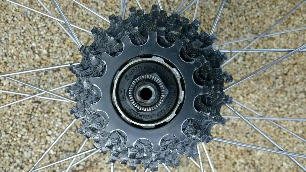

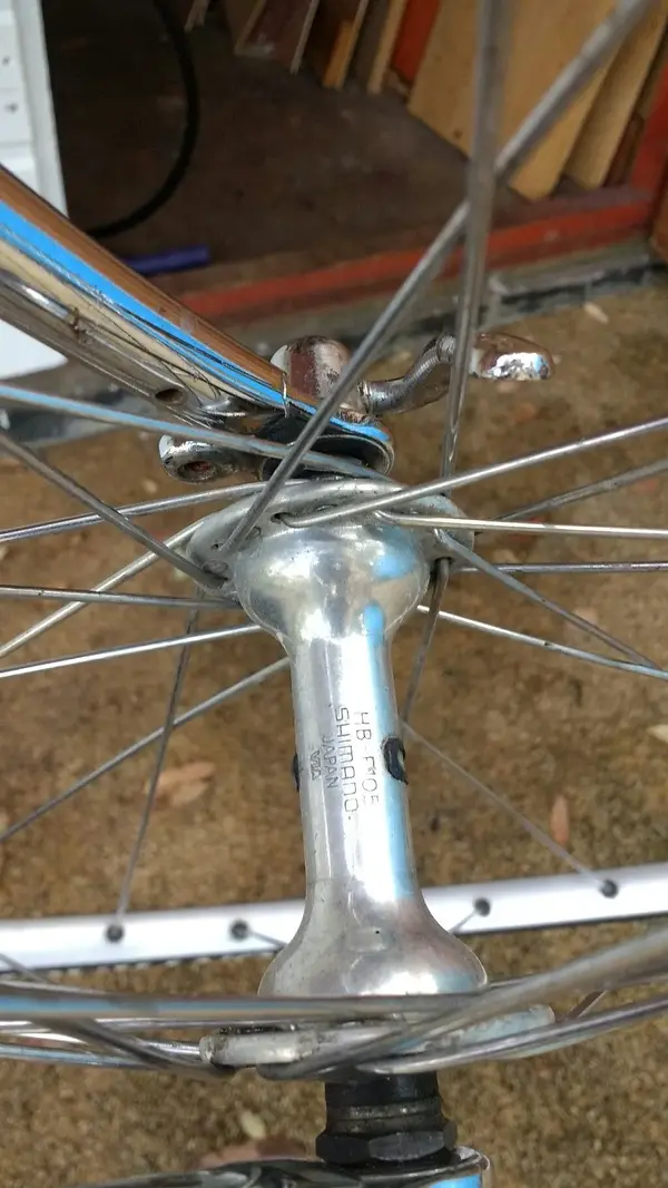

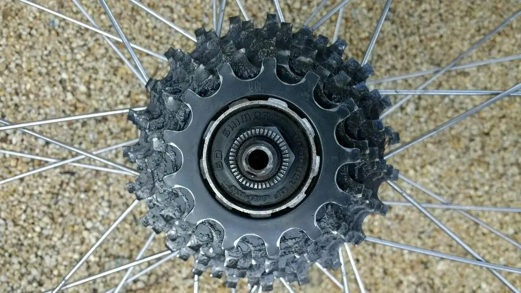

Took off the rear wheel and took some photos. The hub feels a bit gritty, the bottom bracket a little play.
I'm thinking is should order some new balls from simply bearings, what size do i need for the hub's and crank?
I'm off to measure the drop out gap, cheers.
Ian

You are reaching the parts where access to bike-specific tools is likely to significantly decrease your quantum of frustration.. I dunno if you've got 'em- chain-link extactor, crank extractor, BB spanners, cone spanners, spoke key..?
127mm should not limit your options too much- not around here in retroland, anyway! But, rather than a screw-on freewheel, that sure looks like a 'cassette' to me, which is outside my zone of familiarity, even with six cogs. With six cogs, I guess it is from a time when cassettes were still a novelty, possibly subject to yearly innovation, so there might be compatibility issues with trying to get seven cogs on there, or availability issues with the seven (obsolete?) cogs that will fit on there? I don't know. Someone does....
Outside my tiny comfort zone too - freewheels are all I know(ish). Your hub and bb might just need regressing but as torqueless says you're gonna need the right tools. Regreasing hubs is fairly straight forward with the right spanners but I'm ashamed to say when my bb went I got the LBS to do it. As much as I'd like to do it myself it made more sense to pay the 30 quid or whatever it was than buy the tools. Also, if you end up swopping your old bb for a modern sealed bb you'll need one tool to remove your old one and another tool to fit your new one.

Found this picture of the hubs, does this help identify tool and freewheel / cassette?
http://velobase.com/ViewComponent.aspx? ... f&Enum=110
States the rear spacing 126mm, does not mention the bearing ball size?
The BB is marked 187X24T and Crankset described as Shimano 600 when I bought the bike.
I like the idea of replacing the BB with a modern sealed BB.

Cross referencing between Velobase and the often mentioned Sheldon Brown website should have all the information you need for servicing both the BB and hub /cassette. Looking at Sheldon it looks like a “Uniglide” (http://www.sheldonbrown.com/k7.html). Uniglide was a transition point between the traditional screw-on freewheel and the now standard Hyperglide. It only lasted a couple of years(?) so I believe the parts can be harder to find (when searching ebay typing Shimano UG seems to bring up more results than Uniglide).
Might be worth doing a shout out in the wanted section on here and the LFGSS forum for replacements?
If you’re swopping from 6 to 7 speed it might be worth thinking whether you’re after a smoother transmission (13-14-15-16-17-19-21) or a wider ratio (14-16-18-20-22-24-26). Because if you’re just after a say a bigger big cog you could just stick with 6 speed and stick a 26t on and save any unforeseen complications of switching to 7. Although you’ll need to check velobase to make sure your rear derailleur can handle the bigger cog. Ah - so many variables!
If it is Uniglide it might also be worth starting a new Uniglide specific thread to attract forum members with the relevant knowledge. Oh, and use the search tool at the top as there's probably a fair bit of information on here already.
