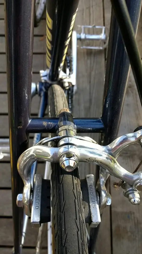

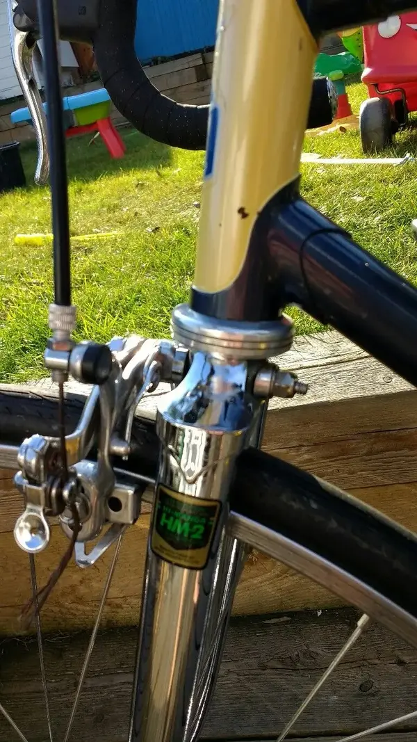

I have taken a photo of the brakes, would the drilling method you described work ok?

I have been reading http://sheldonbrown.com/calipers.html,
Its recommended to buy two front calipers due to the longer centre bolts, I cant see the 5800 bolt length specs listed anywhere?
Current centre bolt length. front 8 cm, rear 6.5 cm, total length including nut.
Do I understand correctly, I need to drill the rear of the fork crown and rear brake bridge from 6mm to 8mm to take the allen bolt?
Cheers
Ian
That is because a front bolt which is the right length for the the Allen key nut is fortuitously about the same length as the old-style rear bolt intended to take a conventional nut, so if you can get two front brakes, you don't have to drill your rear brake bridge at all. (i.e. you use a conventional nut)
Well, without any particular endorsement from me as to the wisdom of modifying old frames to accept new components, technically it is the Allen key nut that needs the 8mm diameter hole rather than the bolt. The free end of the (6mm) bolt flops about in the 8mm hole until the nut goes on. If you do drill the rear bridge, bear in mind that the line between A)drilling deep enough to accommodate the Allen nut and B)accidentally drilling all the way through and having to bodge a repair, might be pretty thin, but, given that you will be attempting to operate a drill in the constricted space between the seat tube and the brake bridge, there is not so much opportunity to go crazy with power tools, unless you are much better equipped with them than I am.. :)

I think Retro Guru meant if I buy two front calipers I wouldn't need to drill, is that correct?
You would still need to drill out the back of the fork crown. The arrangement would be: Front brake fitted with allen nut. Rear brake fitted with conventional nut.

I'm going to order two front 5800's and fit them at the same time as the cables.
I have a pillar drill, so the front forks should be ok. It was the rear that was troubling.....

Aw..we was both hopin' you'd buy that bolt.. :)
If you go the drilling route, once the brakes arrive you might want to do a 'test drilling' on a piece of scrap metal to confirm the hole size best suited to the Allen nut. In this case, imo a snug fit is better than a loose one. 'Snug' not being a synonym for 'tight'!
Don't automatically assume that an 8mm drill will give the best size hole.
I mention this because I just measured a pair of those Allen nuts that I bought years back to put some pivot bolts with f*cked up threads back into service, and they seem to be 5/16" (7.8mm) diameter rather than 8mm. And they are still unused- it is not like they've been worn down in use or anything..
