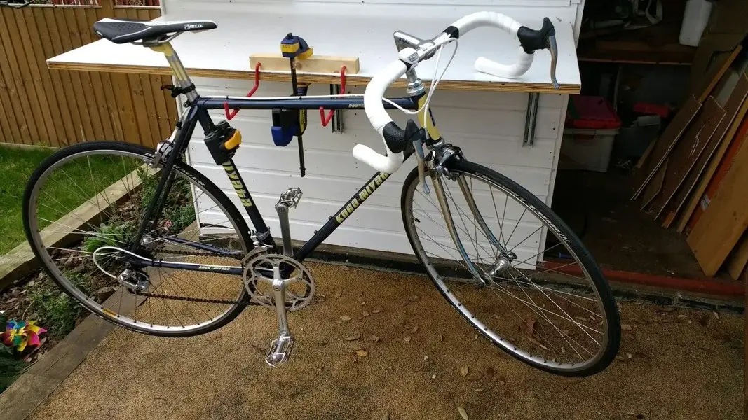

Here's a pic with the new parts fitted.

Nice, I'm a fan of white bar tape and have it on my '85 Raleigh Competition. I think it brings out the shine of the chrome.

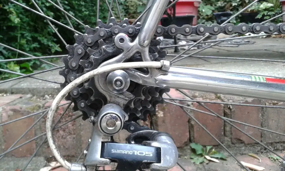

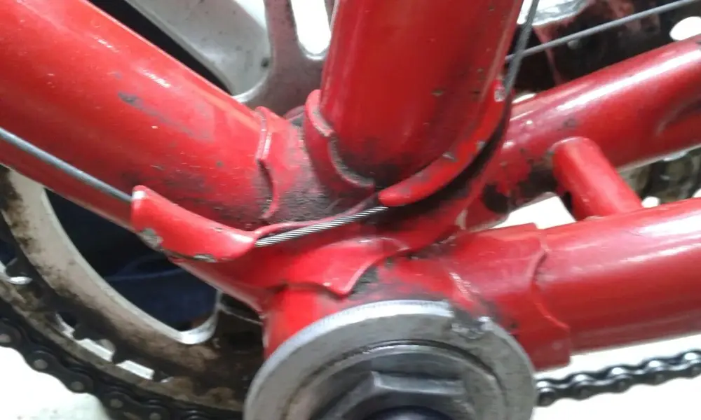

With the rear mech cable the convention is to run bare cable until you get to the cable stop like this (which I guess is to maintain the tension):

I'll shorten the gear cable if I run into any problems, thanks for the photos.
