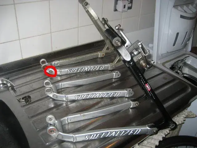

Tried to get hold of a new chainstay to replaced the cracked one. Specialized replied back saying that they no longer have any parts for these DH frames anymore. BETD also through up a blank for parts but said his friend has a white FSR DH 99, full frame for sale for £250..
So I bought the FSR GC frame from inittowinit from here as it came with a bare chainstay, the same one as I needed, as a spare.. I then also bought the rear clip from SEANSTEPHENS as it was complete with bearings.
So that chainstay was attached to the stronger DH seatstay, and I now have a spare chainstay and a GC frame for sale ; - )

The chainstay with the smaller hole (circled in pic) nr the main pivot is the stronger revised one.
When I got warranty replacement on my chainstay they sent a new one with a smaller hole.
You should use the one circled if you can as its going to be less likely to crack.

The chainsaty with the smaller hole is the cracked one. See how it goes with the other + have a spare ;-) Might try to get the smaller holed one repaired too.
