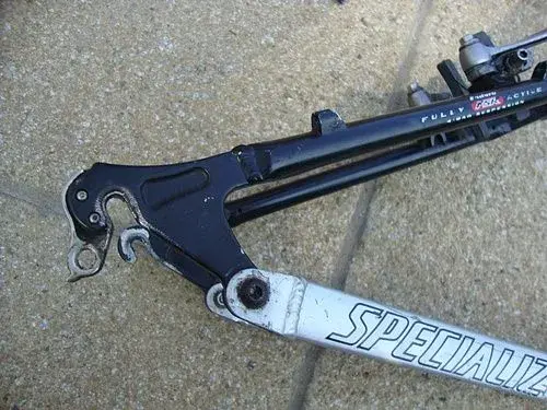

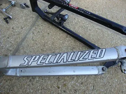

Those chainstays look EXACTLY the same as the ones on my old 1999 FSR XC Comp. Your seatstays are different but the disc mount is the same as I had.
Mine cracked in the same place as this pic - across the hollow part behind the main pivot in approx 2004. My bike was pasted across the Alps a few times and ran a BETD travel upgrade, but not approaching the abuse some DH bikes get.
I rang them up and Specialized sent me a replacement set in black for free despite the bike being second hand and out of warranty. The replacements had a smaller diameter hollow part, so it was clearly a known issue as they had an upgraded replacement to send me.
You may no be so lucky as the wear from the tyre suggests less careful ownership - misuse may invalidate any good will.....

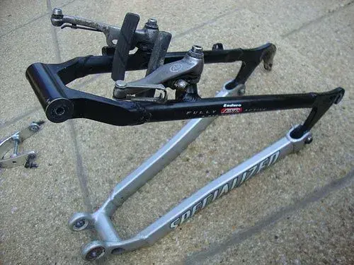

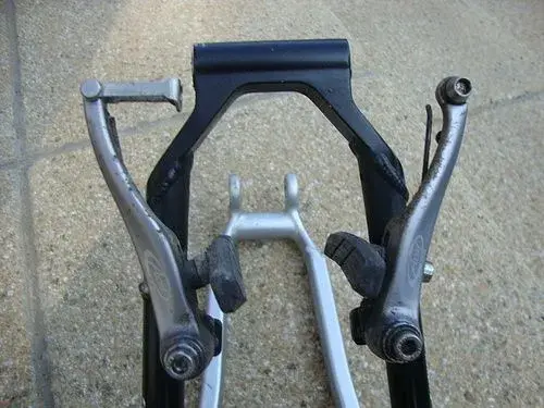

i may have a rear triangle for sale if your interested? to replace that cracked one. though i'll have to check if it will fit. it came from a '99 enduro fsr
i'll get pictures if you want
here you go
the brake would be included (cos i cant get it off)

SEANSTEPHENS thank you for the photos. Yep, the chainstay looks identical, the seatstays are slightly different. What condition are the bearings? I've also sent a pm.
