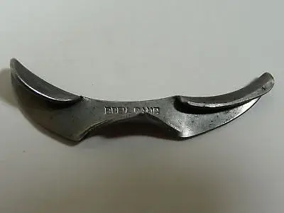

As for the Bottom Bracket (BB) cable guide. Most 70's bikes had a brazed on cable guide on top of the BB through with the cable runs to the rear mech. Something like this...

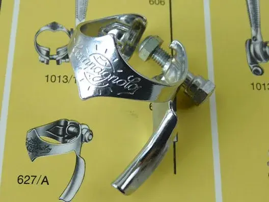

If this is not present then you will need a bolt on one such as this Campagnolo one which bolts to the down tube....
Or if you go the front mech route then one such as this Campagnolo one which bolts to the seat tube and has guides for both front and rear mechs....
