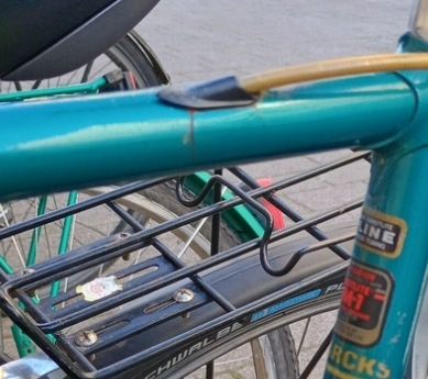

Bike spotted in the
out-and-about thread:
https://www.retrobike.co.uk/threads/spotted-on-the-street.488998/page-3
Koga Miyata Randonneur or Grand Randonneur, i think, but without the stickers. Has a bb dynamo.
These cable holes fail like this surprisingly often.
I wonder whether the hole was stamped, leaving some unevenness (stress riser) and increasing hardness (more prone to fatigue).
The frames themselves are often fairly basic, not much prone to other failure styles.
