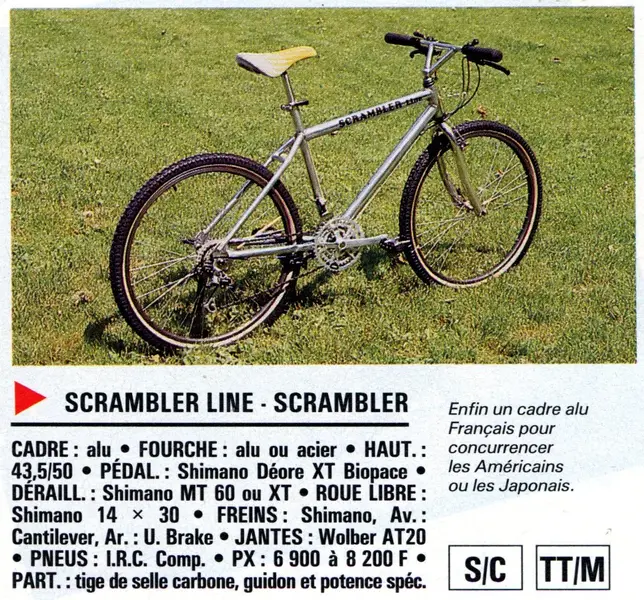

I do have the same with a steel frame. I will cut the seattube and extent the slot. I can do that because the seattube extends quite a bit above the toptube and seatstays.
"Luckily" enough, the seat tube extends "quite a bit" above the top tube on this frame (random picture of an older MY with U-brake mounts):
