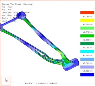

I was thinking about his Castellano. I also wondered how the aluminium plate chainstays stand up to flexing. Is it just accepted that they will have a finite lifespan then crack?
The Castellano flex plate was designed so that it flexed over a fairly long distance so the stress per mm³ (ksi/MPa/psi etc) was kept very low and well away from any welded areas or stress raisers.

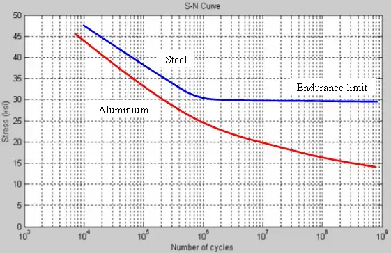

The highest modelled (Von Mises) stress is the few pale green patches on the yoke area, so 17,500psi, or 17.5ksi. Looking at the chart below, the aluminium material here can be expected to handle 15 x 10^7 (15,000,000) cycles to that stress level before failure.
This whole thing about aluminium not having a fatigue limit is often mis-represented by bike journalists, keyboard warriors and such.
This comparative Stress Life curve (off Wikipedia, of course) that's always trotted out in these arguments does NOT show the cumulative reduction of strength (Y-axis) over repeated stress cycles (X-axis)...The "gradual inevitable fatigue failure of aluminium vs the infinite life of steel" as it's portrayed
Any point on the line actually indicates the likely number of cycles to failure (X-axis) of material at a given stress level (Y-axis). ie: how many cycles at a set stress until a sample typically fails. It does indeed show that steel has a clear 'endurance limit' below which it can handle an infinite number of small load cycles without any reduction in physical properties. This point is around 1,000,000 cycles at 30ksi for 4130 steel.
Aluminium does not have this inflection point, so will still experience fatigue from loads down to lower levels. However, generic aluminium is still found to endure 1,000,000 cycles at 25ksi....and infinite numbers of cycles below 15ksi.
Unlike many engineered structures, bike frames are subject to a wide and unpredictable range and frequency of loads, so the S/N Curves are interesting, but not particularly useful indicator of likely fatigue life. The question of course is will a bike frame of given material ever actually experience cumulative stress cycles at a sufficient frequency to fail in normal use. This is inevitably a trial and error/ finger in the wind assessment. Most likely it will be a low number of high stress cycles that will kill a frame. Crashes, bad landings and heavy pedalling cycles, up and over to the top left of the chart, well above the low load and high cycles associated with the endurance limit of steel.
Good frame design and construction should aim to reduce localised stress (in any material), which will always extend the life of a frame. Unfortunately, the easiest and cheapest (so most common) ways to do this with an aluminium frame is to stiffen it up (which reduces stress) using fatter tubes, or thicker walls, which usually for a lousy ride on a non-suspension frame...
