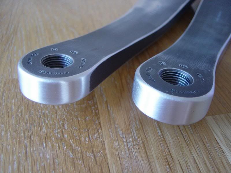

The light grey underneath is not paint, its either coloration from heat treatment or ano. If it's ano I think its fairly easy to sand through (based on other ano finishes I have sanded off). The cranks are full of grinding marks / dressing up marks underneath the coating, probably from the shimano factory processes ?

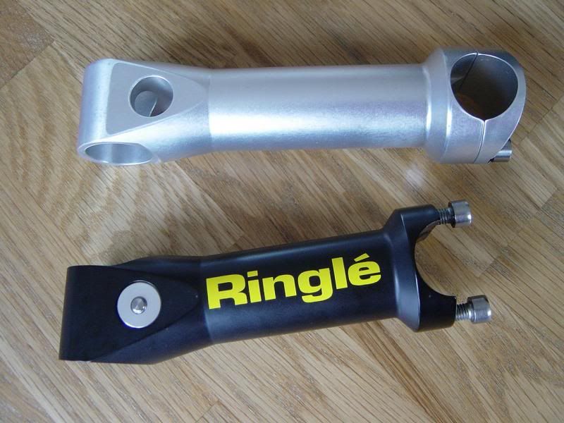

I picked a nice stem option up from Kestonian, a bit shorter and more rise than the other options I have :
Although the faceplate is missing it was cheap, the clamp parts aren't cracked and the long bolt was the OE Ti 8) This will be going purple ... :D

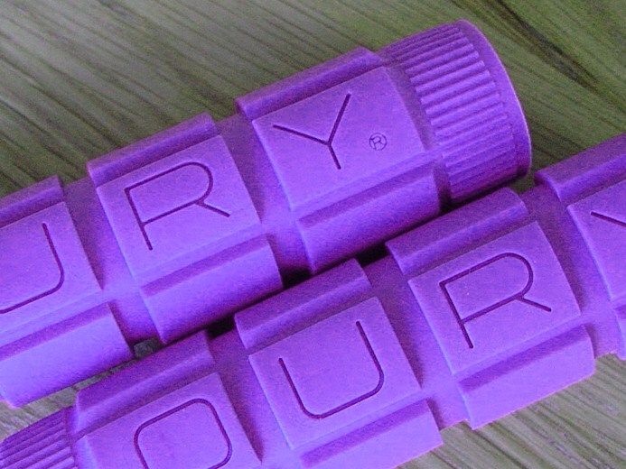

Grips should go quite well with frame colour (team violet or a variation of it) :
I know they look blue on that photo (Sony camera !) :lol: My first go at colour correction, this is what they actually look like :

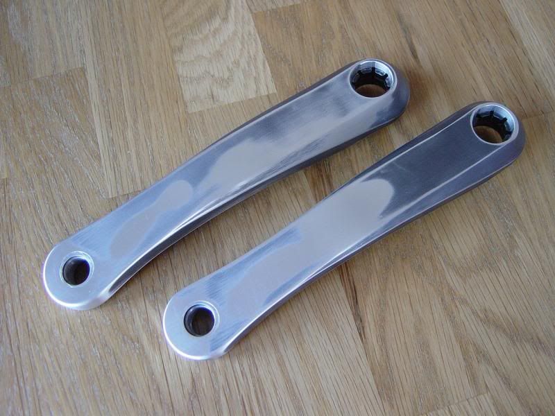

I finished stripping the crank and have sanded out all the scuffs :
I just need to see what kind of a surface finish I need to prep it to ready for coating.

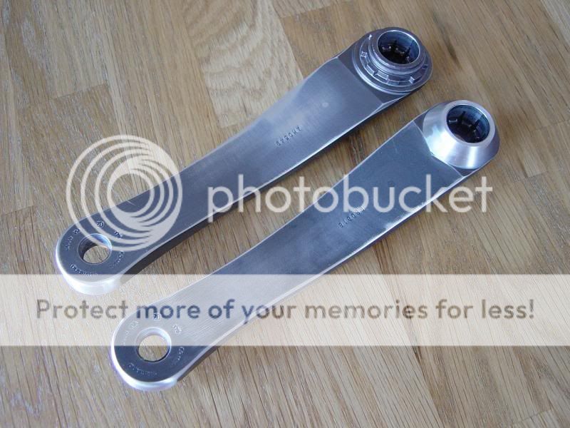

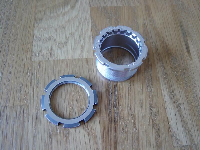

I swapped the rings for a 952 BB :
I think it's had very little use as it is still quite tight and very smooth. I pulled back the non drive side seal (as it's the easiest one to get to) and the grease was clear yellow / looked like brand new standard Shimano stuff :D
I fitted the BB to clean up the burrs on the splines. It fitted well and I am happy they will be OK :D
