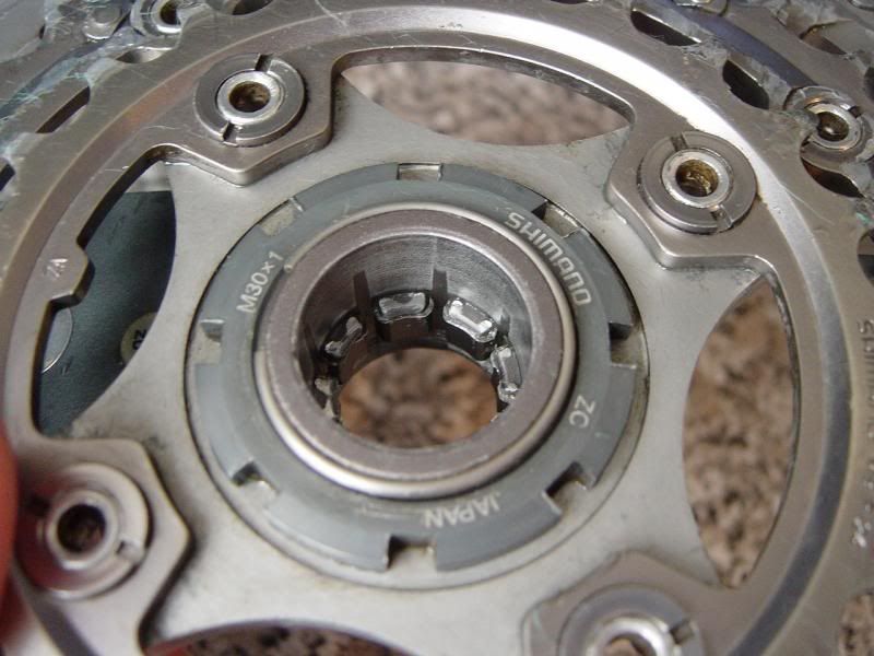

These arrived today :D
They need a bit of cleaning, but I am sure they will come up OK ... ;-)
I haven't had octalink before and I was a bit worried about the splines :
So I asked here : viewtopic.php?f=1&t=267122 and it seems they are OK :D
The rings will be replaced so these will be up for sale soon if anyones interested ?
WD :D

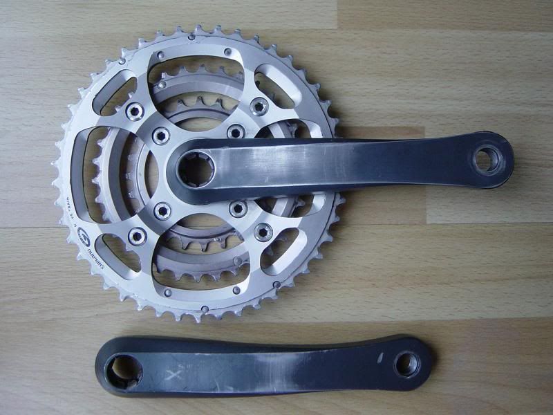

The GF was out last night so I started on the crank - whilst watching Coyote Ugly ;-)
I did the worst one first so I am pretty sure it's going to come up really well 8)
WD :D

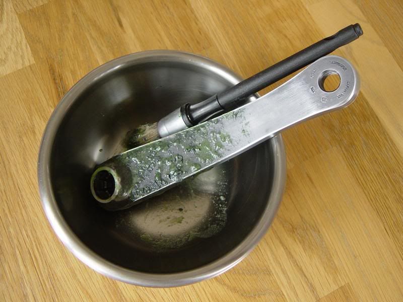

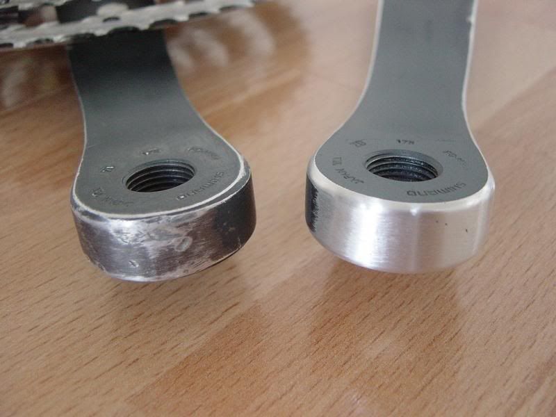

I paint stripped the crank instead :
They are actually dark grey under the dark grey paint (maybe from heat treatment ?) - the pedal end is completely stripped in that photo.
Anyone know how they made hollow tech cranks ?
You can't see on the photo but they have a witness of a patch in the back of the arm about 120 x 15mm and the small hole filled with resin (or similar). You can only see the hole on my 970's but I haven't stripped those to know if there is a patch :lol:
I did take this photo for photo of the month - this months topic is 'The Enemy' ... :lol: :
WD :D
Cranks are hollow forged I think, very stiff and reasonably light.
The coating is a super durable anodizing, took me forever to sand, then buff my set out, especially on the inside of the arms. They were quite rough.
Well worth the effort though!
