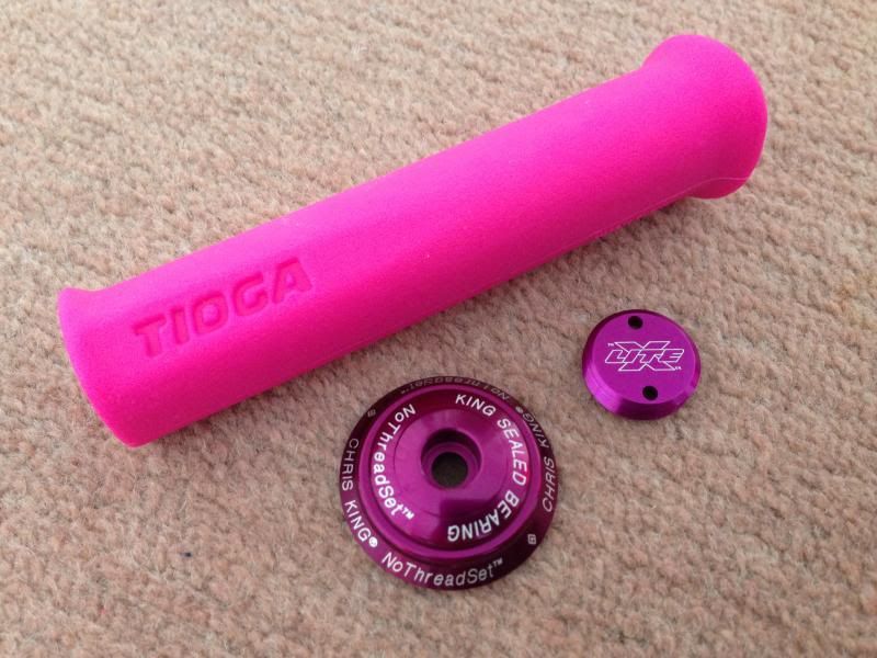

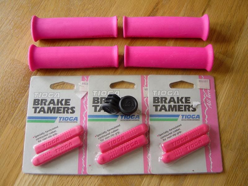

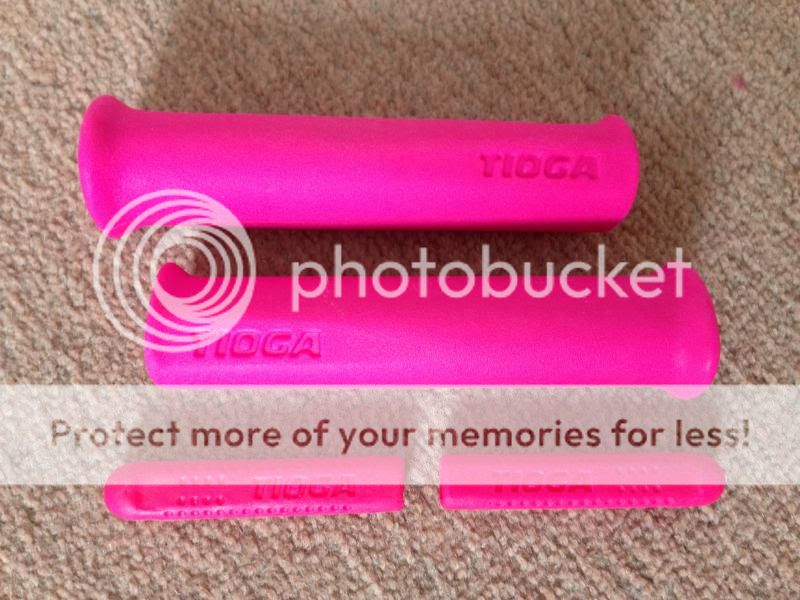

Well I spotted these from two different sellers and couldnt resist ...
The Sony captures them as a pastel shade :( but the iPhone does a better job :
That's actually how bright they look in real life :shock:
Just to see how things are going on the colour choices :
Or should I mix it up a bit :lol:
Should go well with neon pink decals and team violet :lol:

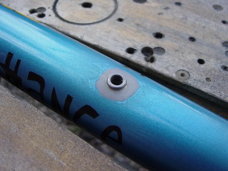

I took the paint off the bosses so I could get some good mesurements to match the replacements for the seat tube ('Rampage' is turning down the heads of the new ones) :
I also started on the chain suck, this is going to need some silver solder running in :
Interestingly, these were under the paint i.e. the paint wasnt scratched (in most places) and the scratches were underneath ? Someone had actually painted this without flatting the burrs off first ? :facepalm:

These are the steps I took to remove the bosses ...
Dremel with cutting disk :
Dremel with sanding drum :
Note to other owners - get some grease / Waxoyl / spray oil behind the canti bosses ... :-(
That's as far as I would dare go with an electric tool :-)
Wide file :
80's and then 120's :
Other side :
Both done :

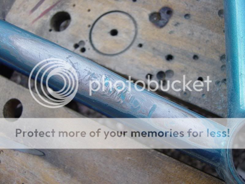

Some repair work needed here :-( Underside of the non drive side seat stay :
I don't think it will be to difficult though :D :

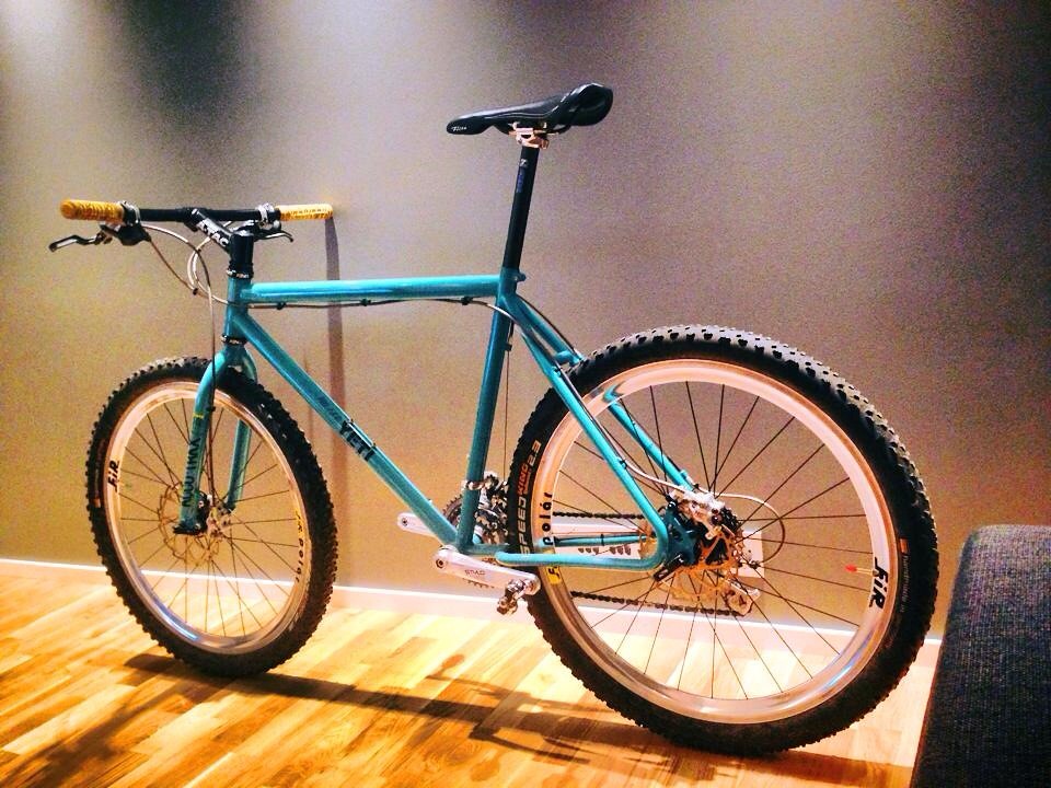

Not the meaning to hijack this thread, but a inspiration to you - I know Your feeling ...
Here is my retrofit project I did some years back on one of my Yeti Pro FRO's, bare fork/frame
Nice 8) did you get any grief for doing that ? :D

Ref the bosses - the original ones are staying, but the new ones for the replacement seat tube (bottle bosses and cable roller) need to be the same to match ;-) I am trying to save my frame builder a bit of time searching for stuff, and it feels like I am doing my bit ... :lol:
The anti chain suck bosses will be staying the standard size as A) the larger head will give more strength to the solder and B) the original fat bosses didn't match the bottle and roller bosses anyway :D
