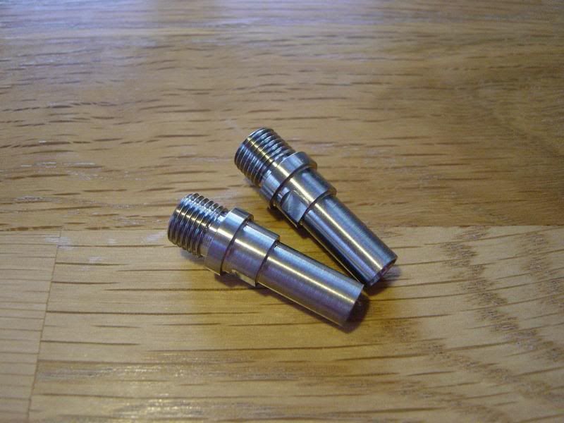

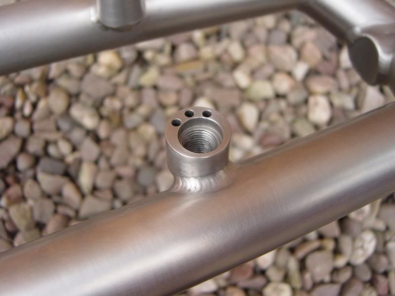

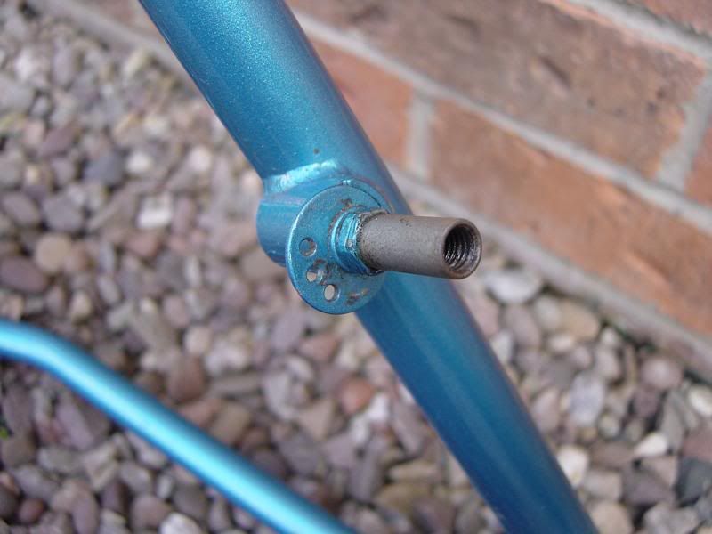

I haven't seen canti bosses like this before :
Replaceable studs with a imperial thread :

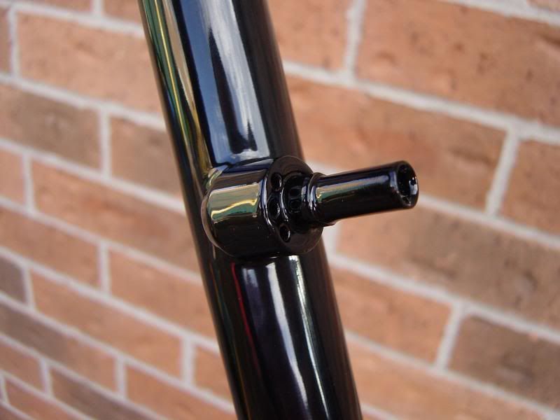

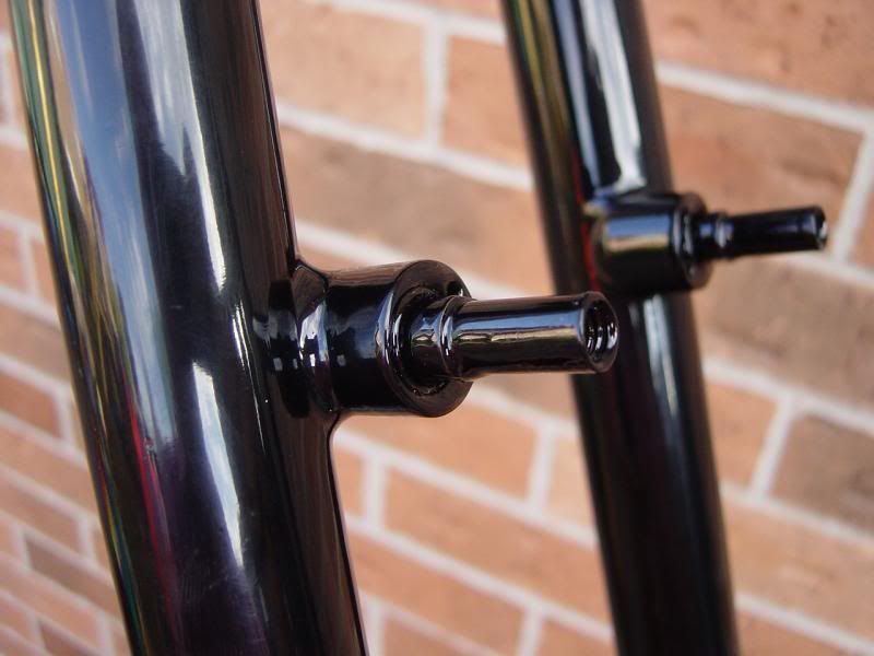

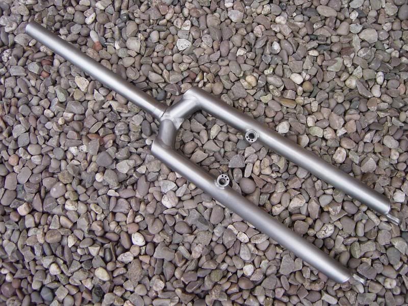

The forks were 'thick' black :

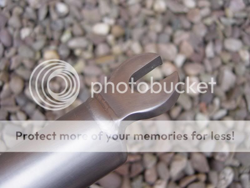

But the paint stripper soon sorted that :lol: They are quite nicely made :
I dont think they had been blasted (or only very lightly) so they stripped quite easily and left a better finish than I was expecting :

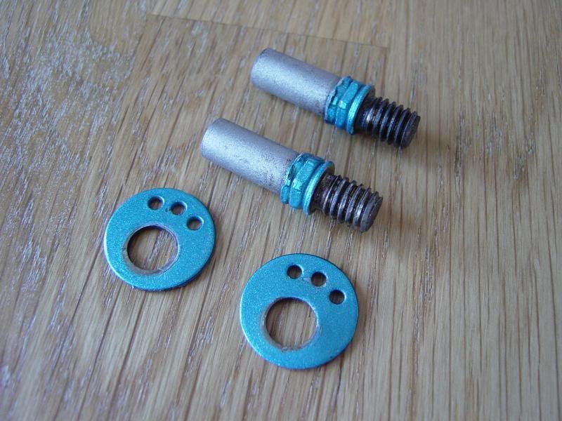

They also donated some Ti bosses for my spares box :
I dont think these have ever had a wheel in them ? :
