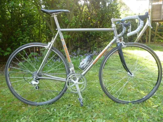

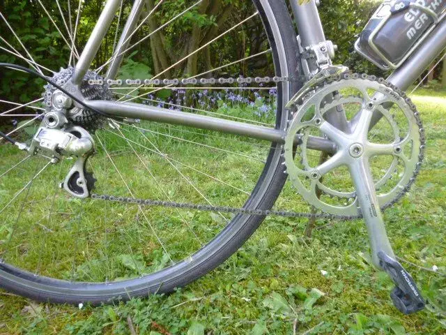

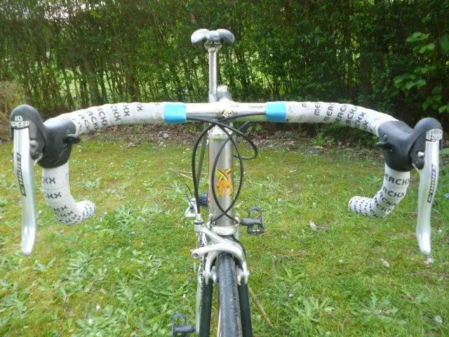

Only four year later than promised ...
Pretty much Trigger's Bike - only the frame and BB remain from when I bought her!
Still, it's been a lot of fun putting her together, and it's even more fun riding around with the sun on my back.
Cheers,
Gareth.
