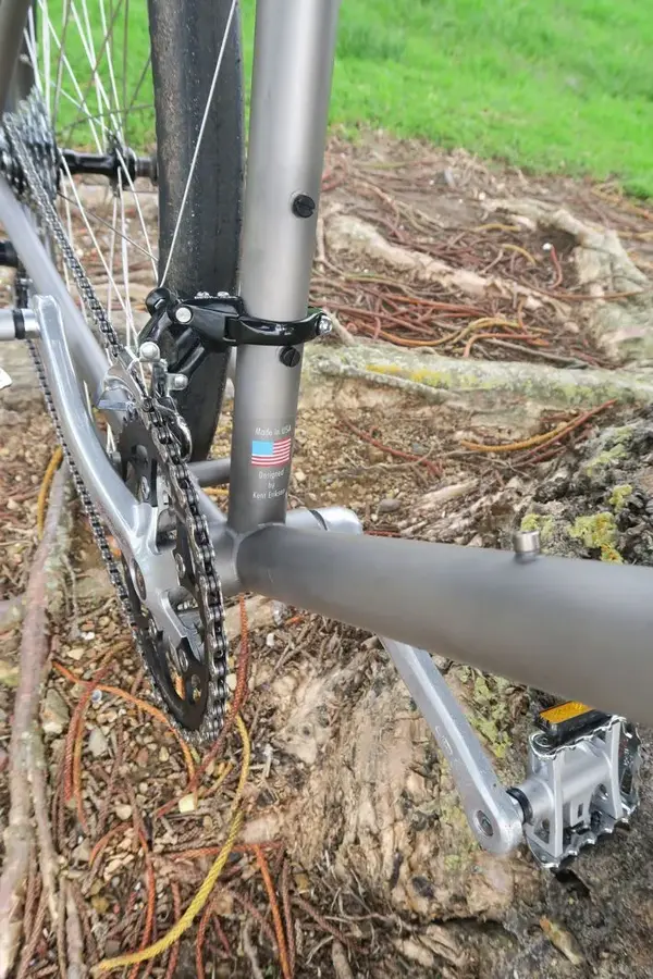

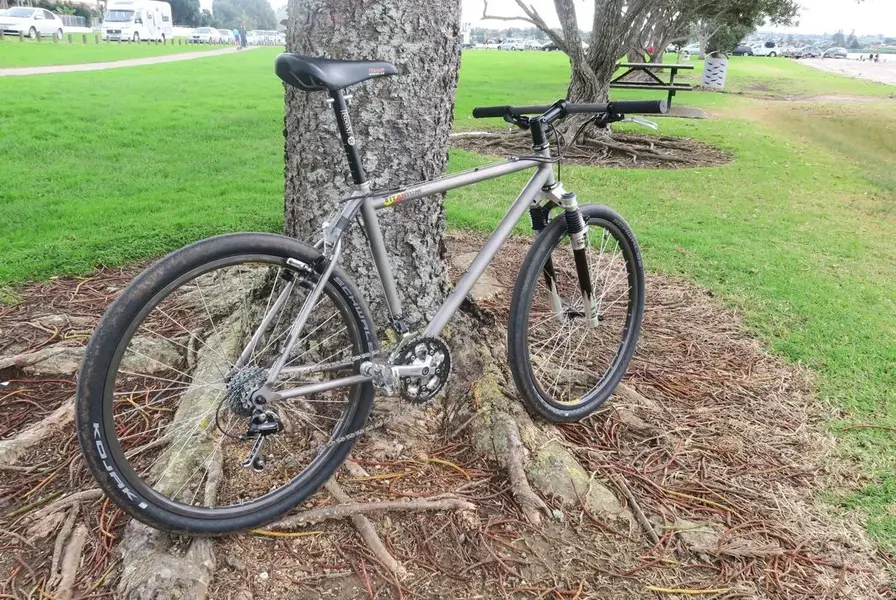

Dear all retro MTB enthusiasts!
I bought a titanium frame in Germany in 2016. The frame is made by Kent Eriksen. I got confirmation from Kent Eriksen bicycles that the frame was made for Wheeler as one of the first YBB frames in titanium. The bike was probably made in 1992.
I recently build up the bike with a Shimano LX 560 set, ROOX seatpost and stem with a titanium handlebar. Manitou 4 fork in very good condition.
Using it now with slicks on the roads in the neighbourhood.
It would be great if anyone knows more about the bike!

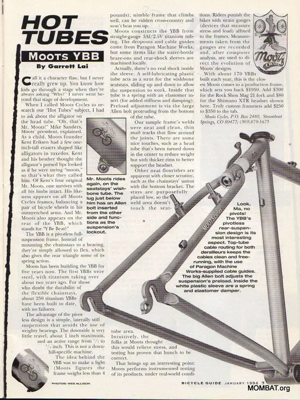

Attached a copy of an article from January 1994 in the magazine Bicycle Guide. YBB Titanium was build from 1992 according to the article.

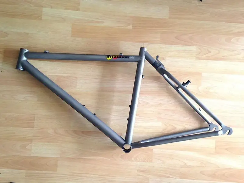

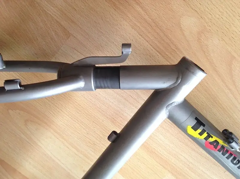

Re: Frame pictures
Attached pictures of the frame after dismantling. Frame number is W18XX.

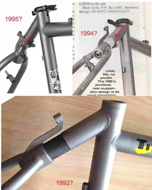

Re: changes on the YBB system
See pictures below. The 1994 Moots has a lockout screw. On these earlier versions, the whole plastic piece is fixed by a large screw from the bottom (towards where the wheel is) using the same tool as fixing the shimano freewheel cassette.
I found a newer Moots with canti brakes with another version as well. Seems like the plastic parts is fitted with screws.

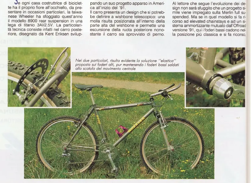

I found in an Italian magazine of 1992 the evidence of the wheeler 8900 titanium
