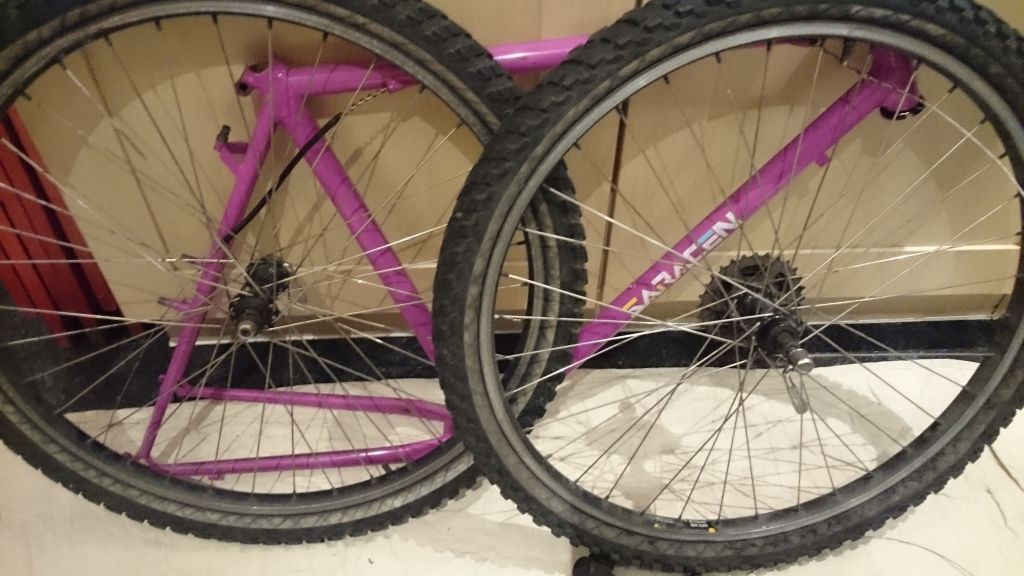

There's a pic of both wheels below, with original skewers!! Strangely the front rim is hardly worn, there's still some anodizing on the brake surface, however the back has seen a lot of braking, is this an MTB thing? I'd usually expect the front to be more worn.

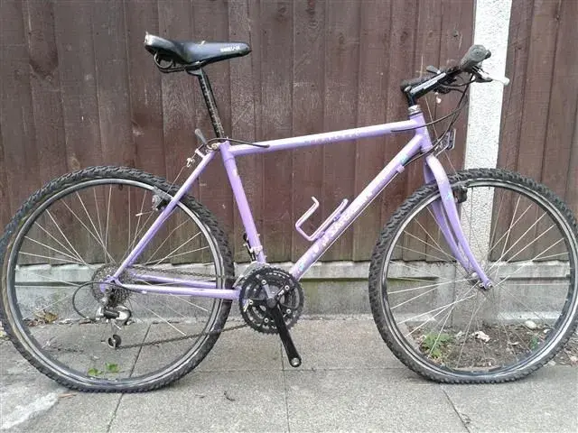

Here is a rather tired looking 89 Traverse that I picked up with the help from Retroyetirigid who picked it up for me - a big thanks to him. Needs some attention but hopefully should look half decent again once a strip down, greased, cleaned and polished :) Probably a project for the summer at the moment :roll: but thought I would share since there are not too many of these old gals around.

^ looks nice, I'm currently rebuilding my Klliflyer from the same year and its been a real pleasure, the whole thing has needed stripping down, polishing and greasing but not much more complicated than that so far except tensioning up the wheels a bit. Good luck with it.

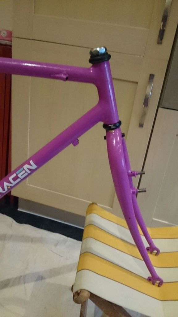

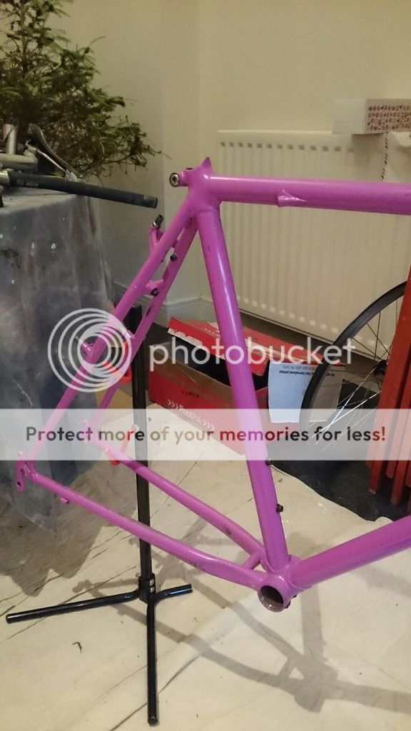

here's some pics of the bare frame
