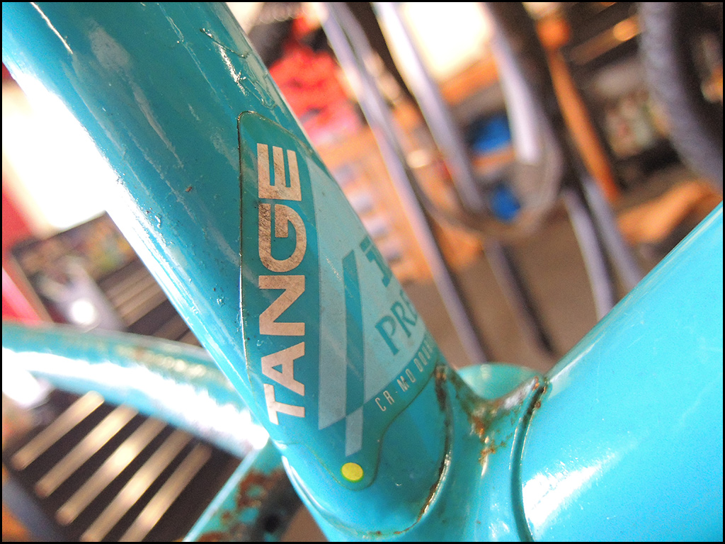

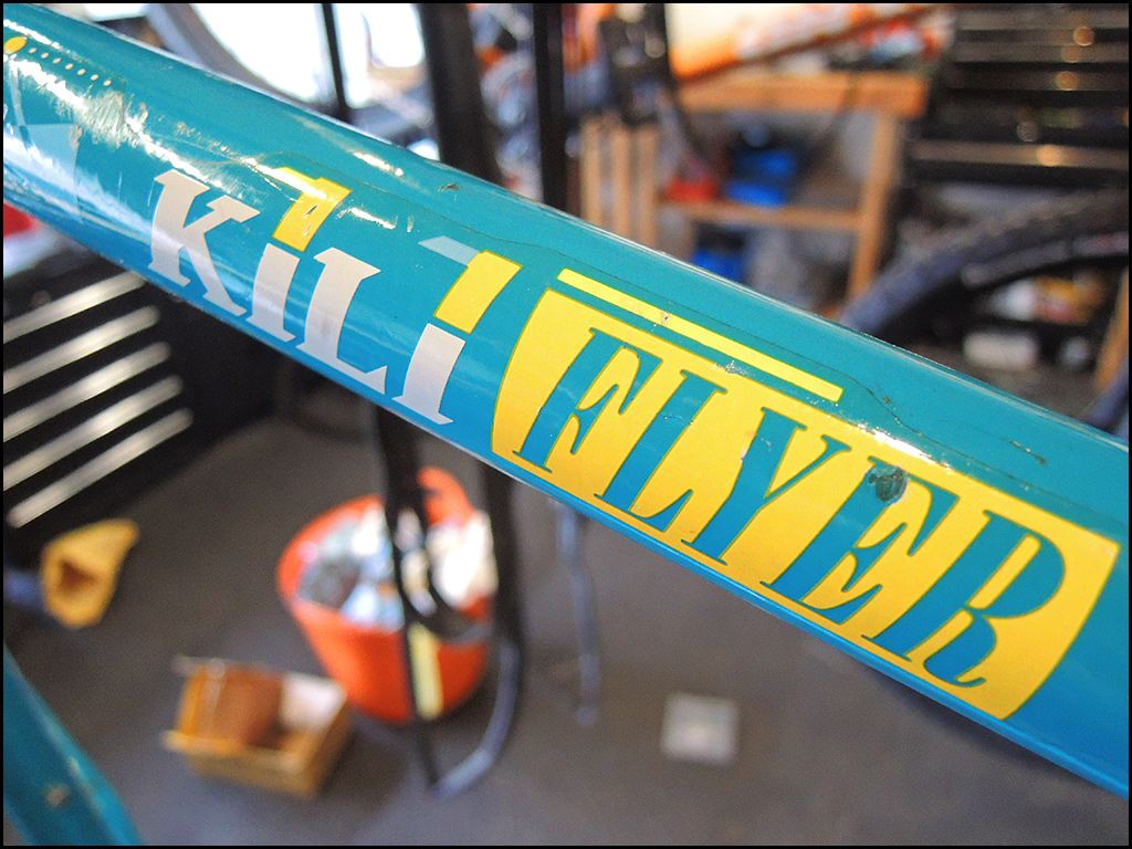

The 1989 Kili Flyer Comp is fillet brazed with Tange Prestige tubing and finished with Kingfisher Blue epoxy powdercoat.
It's a lovely looking frameset and it will suit the black XT parts perfectly.

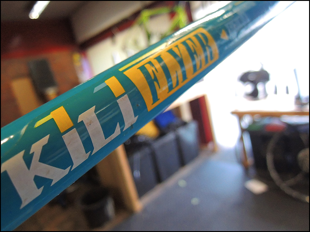

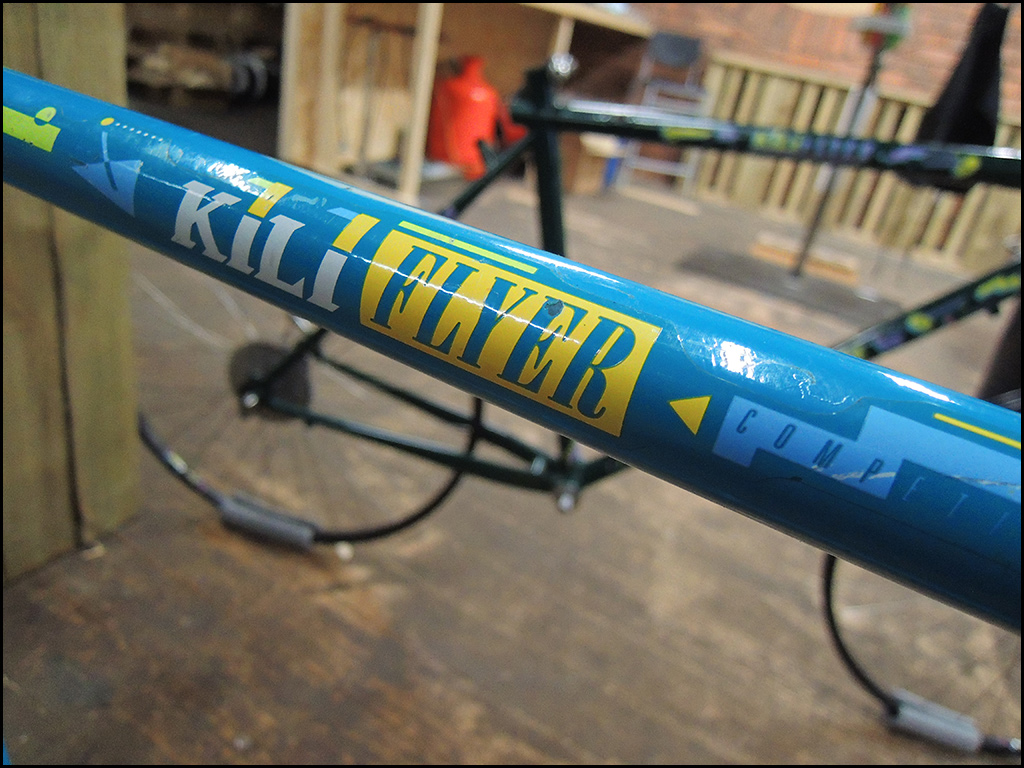

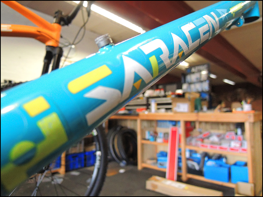

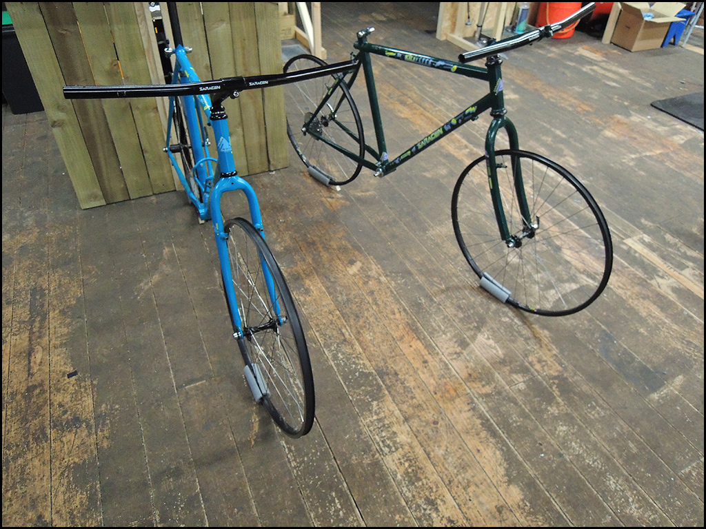

Here are some pictures from when it arrived a few weeks ago:
As you can see it was very well protected on it's journey down to my workshop, and it's in really nice condition for a 32 year old frameset.
There are a few minor scuffs and a little rust around the chainstays but nothing at all to worry about. I like some patina anyway.

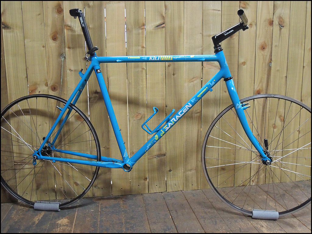

Bearing in mind I have practically all the black XT parts already, I had hoped this would be a really quick build. However there have been a few snags.

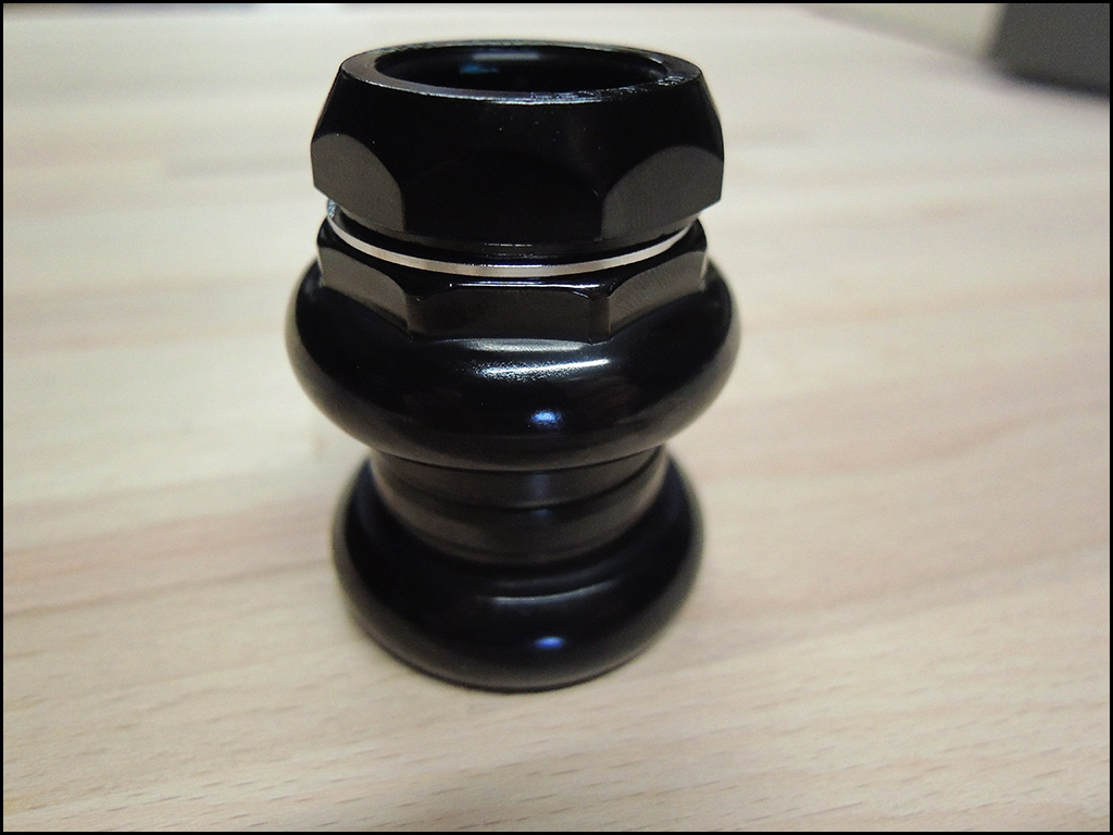

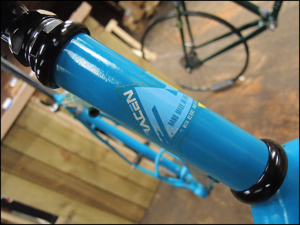

Firstly the headset is one inch with quite a shallow stack height of about 33mm. I did look for an XT M730 headset but the only ones I have seen were NOS offerings on eBay which would set me back at least £150 after shipping costs.
The original spec from the 1989/90 Saracen catalogue doesn't actually specify which headset was originally fitted so, taking my lead from the Tange tubeset, I sourced a lovely Tange Levin headset from one of my suppliers which looks great.
The headset was fitted this afternoon, before turning my attention to the wheels.

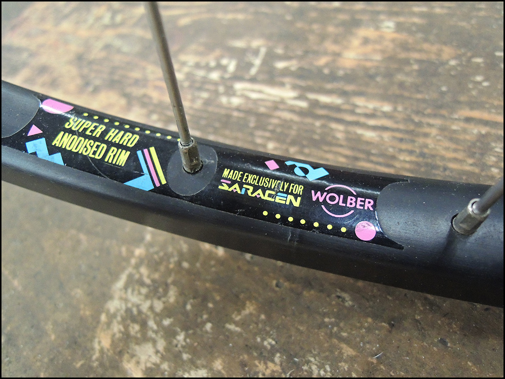

It's been a while since I sourced the black XT hubbed wheels for this. I've also got a near identical black DX hubbed pair of the same wheelset. Both have the Saracen branded Wolber rims, one pair has been lightly used and the rims on the DX hubs are unused with a perfect hard anodised black finish.
I will be rebuilding the wheels in due course mostly to rectify the fact that one of them has been built with the rim logo the wrong way round and with the valve hole in the wrong place in relation to the hub logo. I couldn't live with myself if I left this as it is.

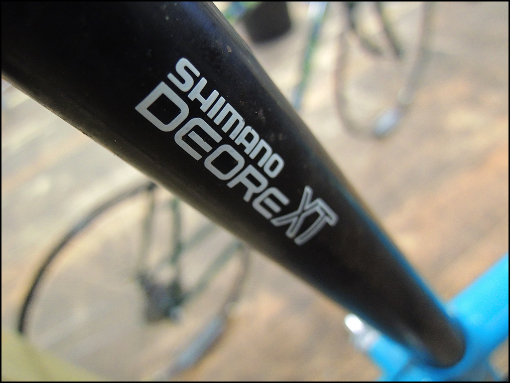

Another piece of the M730 XT puzzle was the seatpost. I knew I had one somewhere in the storeroom so you can imagine my delight when I found that it fitted the 89 Kili. 26.8mm if you are asking...
