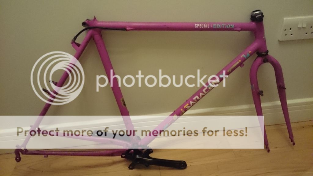

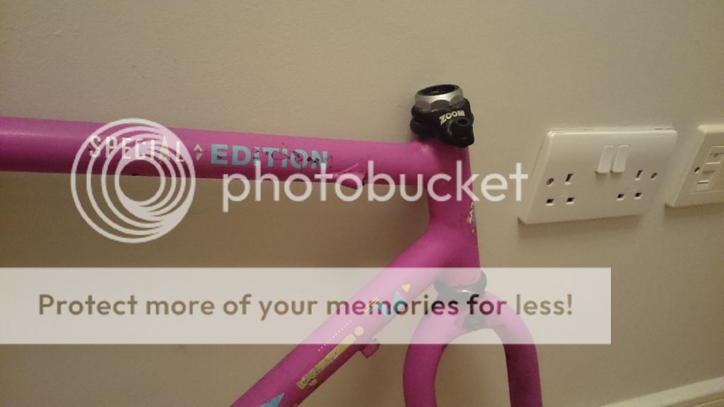

Yes I suspect you're right, here's a pic of the frame, however I note the down tube cable guide isn't the semi circular one in your pics.
Components I just stripped off include: mechs FD & RD MT62, cranks FC MT60, cantis BR MT60, levers/shift ST M071, Deore pedals with Tioga cages and straps, Zoom stem and 155gm straight handlebar, Farmer John cousin tyres, fluo green Onza bar ends and a yellow saracen bottle cage. Will turn my attention to the cranks and bb tomorrow, couldn't find the spindle adaptor for my crank puller this evening.

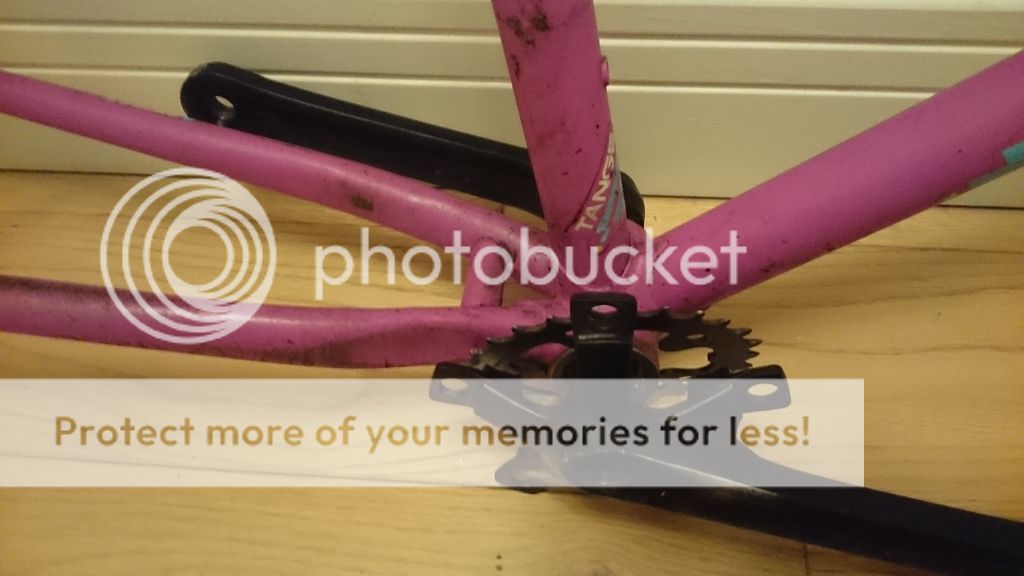

So removed the bb and forks today, going to clean the frame up this evening. I can't believe how easily the whole bike dismantled, it was as if it was only built last week, my usual experience with a 25+ year old bike is that at least one thing has to break or be stuck, well I guess there's a first for everything.

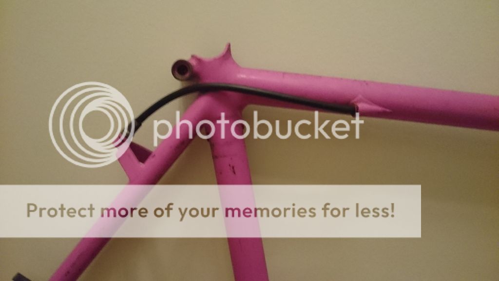

Quick question before I get on, What's the arrangment with the internal rear brake cable? I'm a bit reluctant to remove what's there until I know how I'll be putting it back.
