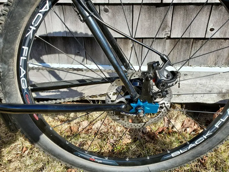

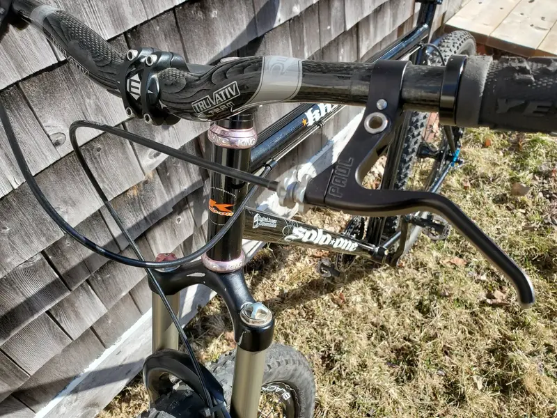

I run Spykes on my KHS (with Paul levers) because I was tired of dealing with hydraulic fluid leaks. They're strong enough and I like them but there's no way they can be adjusted to resemble the feel of a nice hydraulic disc. There's a relatively long throw to engagement and they don't feel as solid with cable stretch.

When you say long throw (at the lever) to engagement , does this also apply on the caliper side meaning lower chances of the rotor rubbing on the pads? Could you tell me more about which lever model you are using?

Put simply, I could never get sufficient braking power. Not enough to lock the back wheel for example.
Okay, not sure what's going on there assuming you followed the set-up instructions. I know that the cable discs are quite sensitive to the position of the actuating arm and amount of cable pull needed before the pads hit the disc so maybe that was it? I use Avid levers with mine BTW, had some Pauls levers on another bike and didn't get on with them at all.
I'm using Love levers for V-brakes, not sure on the model number. I'd originally planned to use the levers with V's but other project priorities left me with a disc-only wheelset for this bike. The mechanism on the caliper itself has a long throw to move the pads in but gives good pad clearance on both sides. I'm sure I could shorten up the throw by really dialing in the caliper placement but I really wanted to ride it so decided it was good enough :)
