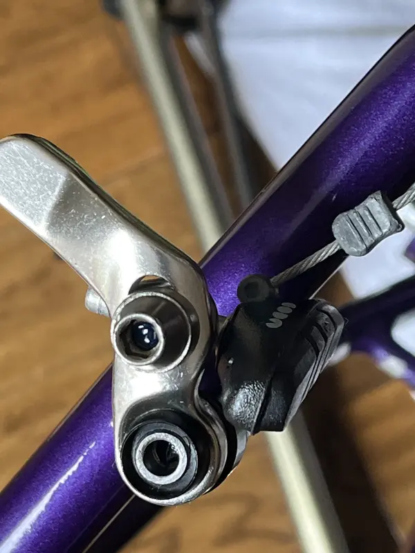

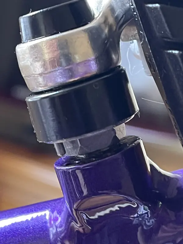

S sefton1275gt Retro Guru Today at 11:30 #1 Have I built these incorrect? The pin is too short to fit into the pin holes in the frame
Frankenorange Orange 🍊 Fan Today at 11:33 #2 You need canti studs that haven't got such large spanner flats on them. They are too fat to go inside the spring cover.
legrandefromage Bin Monkey BoTM Winner PoTM Winner GT Fan Feedback View Today at 11:35 #3 Some models don't use spring holes. They tension off themselves. What does the canti mount look like without the brake on it?
narcotitlan Rocky Mountain Fan Today at 11:37 #4 legrandefromage said: Some models don't use spring holes. They tension off themselves. What does the canti mount look like without the brake on it? Click to expand... What he said, screw the bolts in, then use a flat spanner to adjust tension. The springs don’t go into the frame.
