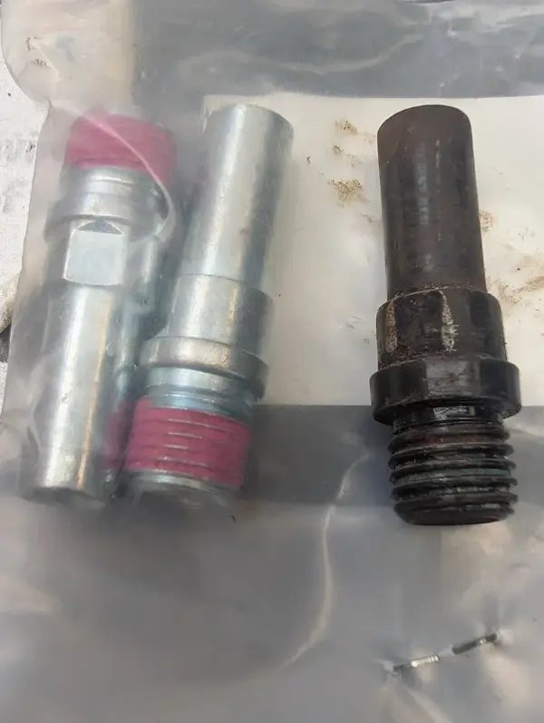

I have had a rummage and all of my frame ones have the shoulder. One set has a much smaller shoulder than the others - pic below.

Thank you @ishaw for digging those out an going to the trouble of taking a photo, and @Nothin-fancy for sharing your thoughts on the CX50s (d'oh!). Thanks also @2manyoranges for lightening the tone :D .

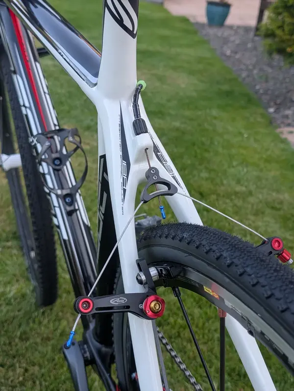

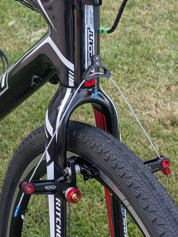

I'm sure you'll all be somewhat amused to hear I've just cracked and bought some Avid Shorty Ultimates! They will work fine with the shoudered posts as the spring arrangement is totally different and doesn't use the frame pin hole at all, and given I've spent £20 on ti posts already, I'd rather get something that works with those. Plus the Avids will look great with the rest of the bike, which is red and black.
I now use the Shorty Ultimate's. Damn fine brake when paired with Swissstop BXP pads. Easy to set up, too. The instructions are a bit silly as they instruct you to set the straddle height in relation to the top of the tyre which means the brake will perform differently between one tyre and another.
I think I'm wedded to mismatched straddle cable heights anyway, because my frame has a built-in rear hanger that is notoriously too low (Scott Addict CX)....
Here are the new brakes looking well and working nicely. Despite the wildly different straddle cable lengths, they feel good :) .
