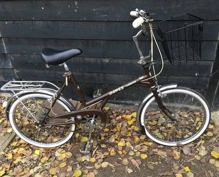

I then began looking for one of the other makes of Raleigh Twenty lookalikes and the Dawes Kingpin, with its slightly racier styling (if that’s possible on a 20” shopping bike?) made it the one I wanted. Not long after one popped up on EBay, very near to me and, after an offer of £45, it was mine.

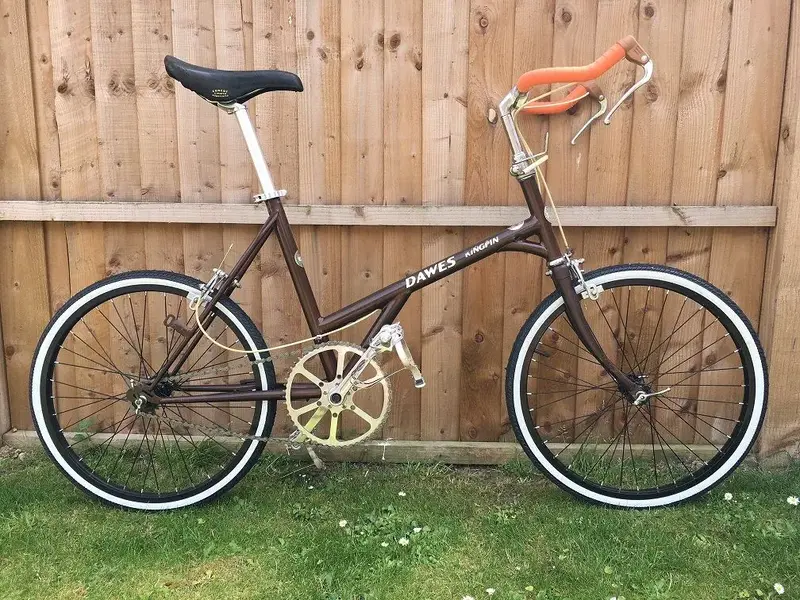

I knew all along that I wanted it to be a Single Speed, with my favourite Single Crankset, the Stronglight 49D. I handily had a set lying around, so these were pressed into service in combination with a 54 tooth TA Chainring, some modern, but retro styled MKS Sylvan pedals, MKS Toe Clips and ALE leather straps.
I initially intended to use a 14 tooth Freewheel, to closely match the Gear Inches of my Macleans Featherweight Track or Path, but I discovered, after purchasing a set of 20” x 1 3/8” (451) BMX Racing Wheels, that the smallest Freewheel I could fit without changing Hubs was a 16 tooth, so I stuck with the one the wheels came fitted with. I also had a set of Gripfast Wing Nuts lying around, so after changing the Front BMX axle to a 5/16” Road one, they were fitted.
Purely on an off chance I bought a cheap 120mm Stronglight Cotterless Bottom Bracket axle and it fitted straight in to the Kingpin using the same Ball Bearings and the original TDC Cups as both Stronglight and TDC used 1/4” Bearings.
The rest of the build came together just as easily, as the Kingpin uses Industry Standard fittings, so a 28.6mm diameter, 400mm length Seatpost and 31.8mm Quick Release Seatpost Clamp was acquired along with a new steel and alloy 1” Stem. Although the new Stem has an expander bolt I decided to leave the now redundant Dawes Stem clamp and Front Lamp Bracket in place as I just like the look of them!
Luckily the Kingpin comes ready fitted with Weinmann Alloy Sidepull brake calipers, rather than the basic steel calipers fitted to Raleigh Twenty’s, so a quick clean and they were pressed back into service after replacing the original pads with Weinmann ones more suited to alloy rims.

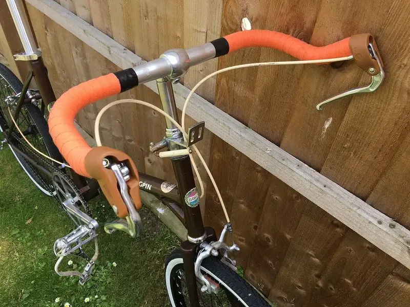

As set of Brick Lane Bikes Bullhorns where fitted along with Reverse Pull Levers, using the original Kingpin outer cable housing with new inner cables. I decided on orange Bar Tape to complement the Brown frame for a classic 70’s colour scheme.

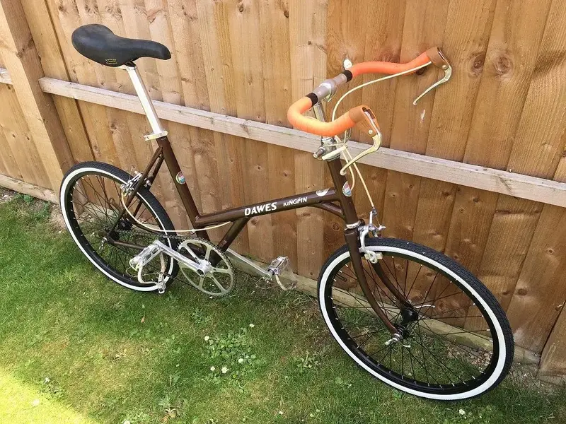

I finally had time to do the final build up at the Weekend and a few hours later it was time for a quick shake-down ride of about 3 miles. It was a pleasure to find out that all the replacement components worked perfectly with no malfunctions at all. The whole bike is very comfortable to ride and surprising feels very similar to my Macleans, both in riding position and gearing.
All in all I’m very happy with the little Kingpin and am now looking forward to some longer rides. So, let’s see more modified Twentys, Kingpins and variants out on the road!
