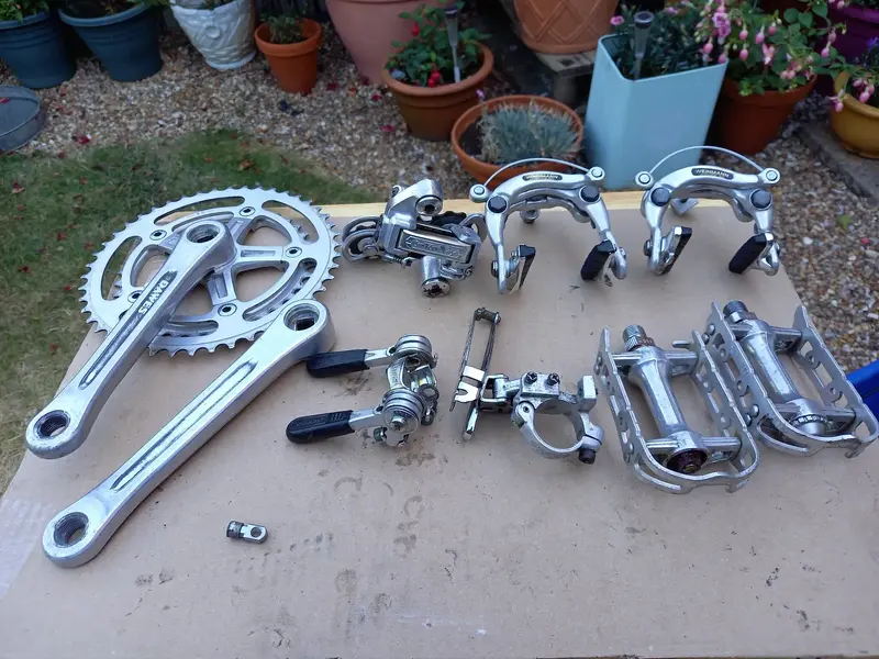

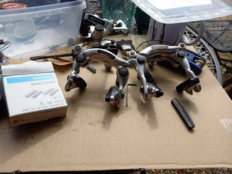

Spent the afternoon cleaning and refurbishing parts. Looks like the previous owner upgraded the brake blocks. Just waiting for the new straddle cables to arrive.
Today has been a day of small victories. As well as a stuck seatpost the allen bolt on the saddle clamp was rounded so I couldn't remove the saddle. In the end I managed to cut a slot in it with a Dremmel. The bolt was also seized which explains why the bolt was rounded. Used a large screwdriver and Mole Grips with plenty of Plusgas. Took over an hour to get it off.
Nearly everything else has been refurbished ready for the rebuild once the seatpost is out.
Just got the wheels to do now.
