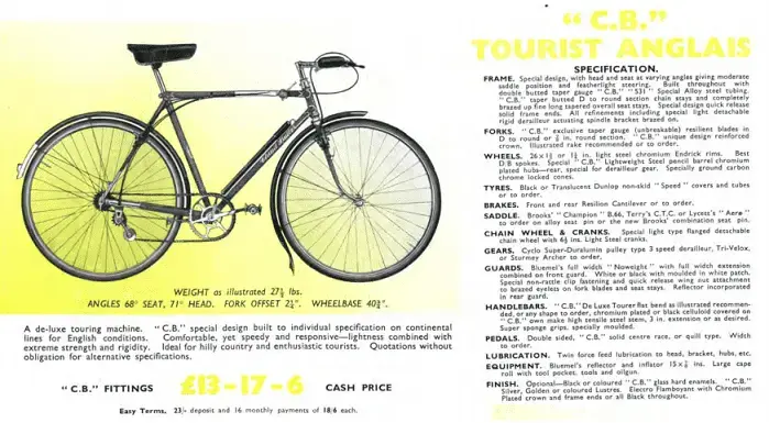

nice ! Its certainly an August 1939, nailing the model is a bit harder, as the catalogues are okay for a reference, but they are designed for presentation at trade fairs and senting out to retail outlets advertising next years models, which of course could change by the time of ordering. An allrounder is a possible and so is the tourist anglais, below is an image from the 1938 catalogue, don't forget war was just around the corner at the time of the build, so may never nail it. Terry
Is there any evidence/remains of a Benelux hanger bracket under the chainstay? If there was one originally it may have been removed to 'modernise' the frame to accept dropout hung rear mechs. The one you have looks to be a Huret Svelto which is way out of period. A Simplex or Huret Tour de France would look good - if you can find one.
Thanks Chaps
Very helpful, the gear change on the top tube is a Cyclo Benelux.
The Svelto hangs on a adaptor which clamps in the drop out.
The frame has not been modified in any way fortunately.
It looks 1939 to me, with chater cast lugs. The twin cable Cyclo gear in the catalogue is far earlier, I think originated in 1933, The Benelux was about 1950.
whilst similar to Chater Lea the lugs are C.B's own "Super-Cutaways" popular on their frames from the late 1930's
