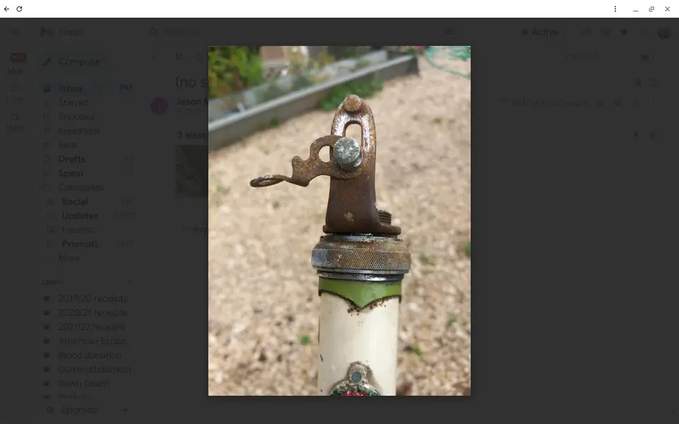

front brake hanger very different from what thought it to be
this is a product of the firm Fratelli Pietra and is Universal brand
t'is item nr. 105/A
t'is item nr. 105/A

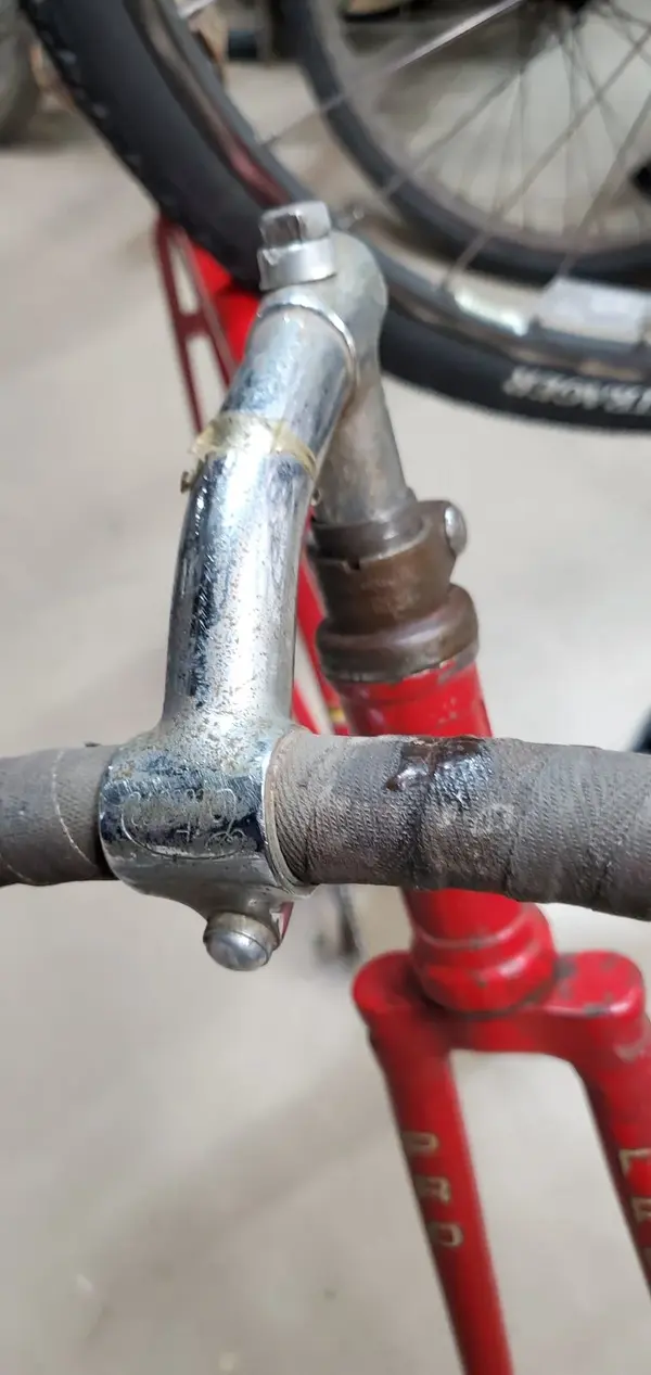

one high quality steel road stem you could employ as a replacement, either short term or long term, for a badged Cinelli would be a Titan from Belgium
unfortunately the clamp size on a standard Titan is 27.0mm rather than the 25.4mm one would wish for a GB bar
t'is possible the maker did clamp sizes of other than 27.0mm
Titan stems can be somewhat dearish but nothing like Cinelli
TITAN stem & bar poster:sign .webp
a "limp" track model

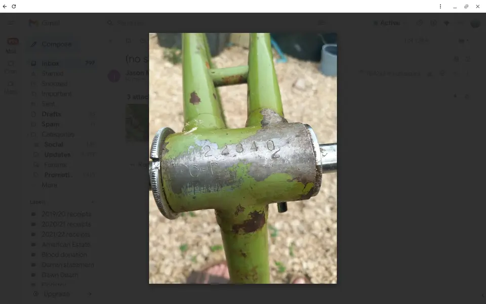

the posted image of the bottom bracket area brings up two thoughts -
a) fixed cup appears to have loosened
b) lack of visible guide or stop for a front gear cable could mean bicycle produced as one with a single plateau drive train
there may be a housing stop brazed to the non-drive side of the down tube; and/or one brazed to the backside of the seat tube
if research shows model produced as both single plateau and double it would give you a choice of how you wish to set it up
manual front mechs had been discontinued by 1964, final year for the Juy (Simplex) ones was 1961
they continued to be manufactured in Warsaw Pact lands at least as late as 1967
