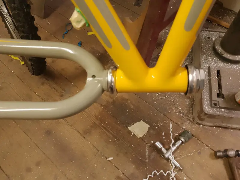

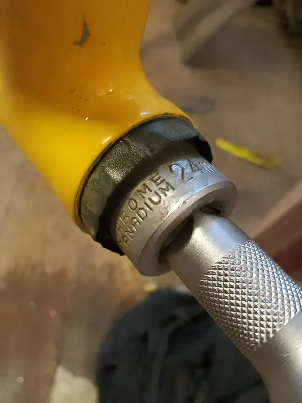

With two lots of paint touching up on the headtube there was a little two much paint in there for my liking...tut tut.
Figured this would work...and it does!
Round and round we go slowly catchy monkey....
Aaaaaaaand it's to size 😊
Took the paint off the faces greased it up and pressed them races in....then cut the fork steerer down to length....
And put em together.....
Ahhhh.... Happy days.....😁

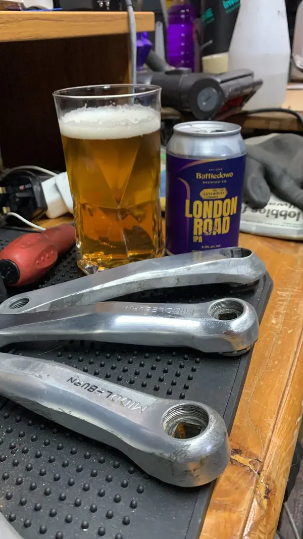

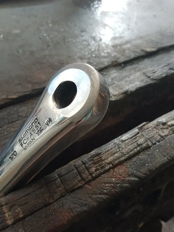

Next up a little bit of clearancing on crank arms...I'm properly chasing a narrow q here! Gotta look after those knees 🤨

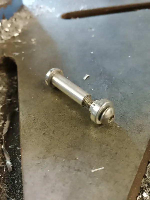

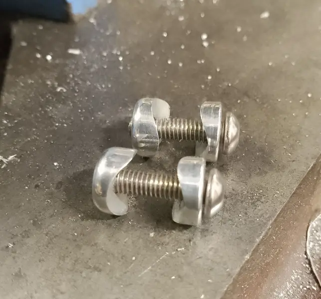

I suppose I could of just cut a bolt to length with a domed Chrome nut to blank off the fork crown hole.......
But...
I like little light things that shine...
And why have 14g when 4g is all you need?😁

But! I'm getting there....still so many little things to do...but.....im closer than ever before unlike these crank arms !!!

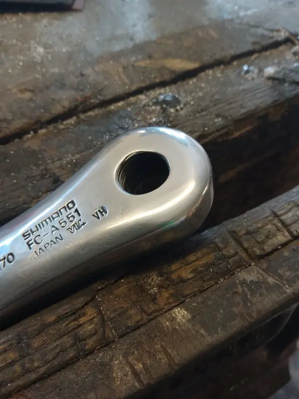

A close shave ...1.6 where it counts...which gives me a whopping gap that a London bus gets thru.....3.2mm 🤨 count the clonks and there's your cadence 😆 ...it'll be fine.
Wet flat and polish....ready for final buff...
You wouldn't know it'd happened! 😁
And to those wagging their fingers in disapproval...the final buff will soften the back of the pedal thread..👍
Aaaaand .....
From 27.2 comes 26.8....
Could of sworn I had the right size....oh well let's do it the hard way!
Next up?
Beer 😁
