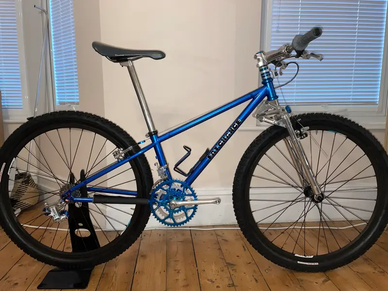

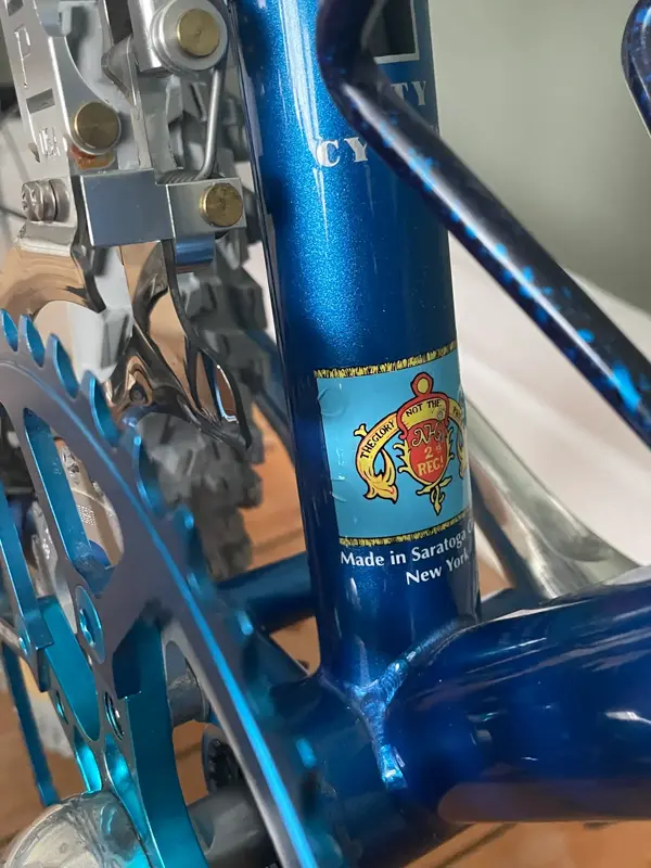

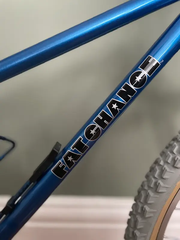

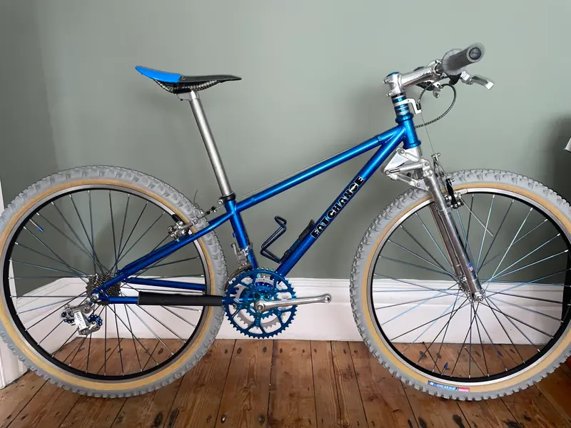

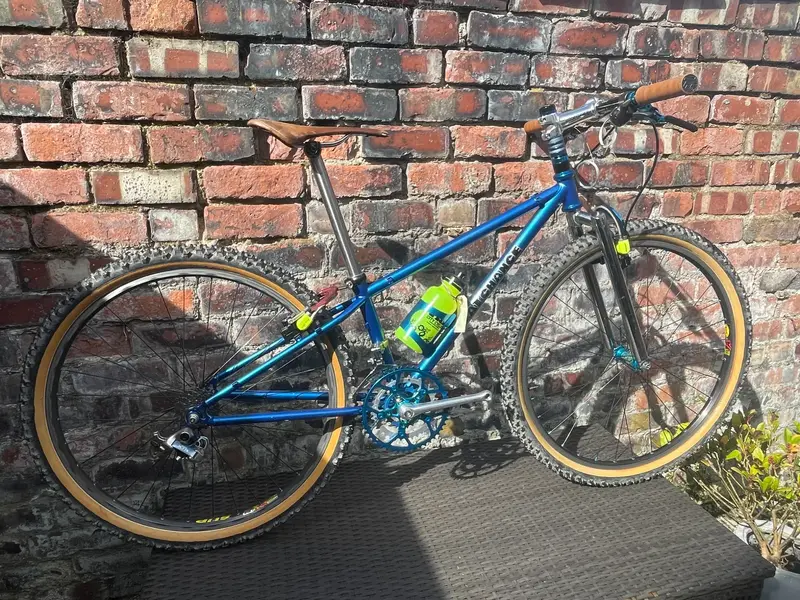

A small, and I mean tiny, Fat Chance Yo Betty in the mix.

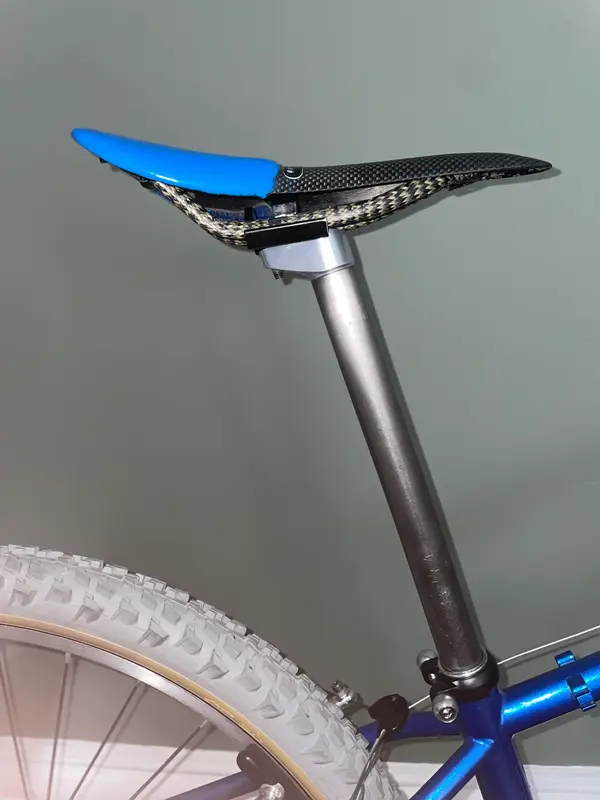

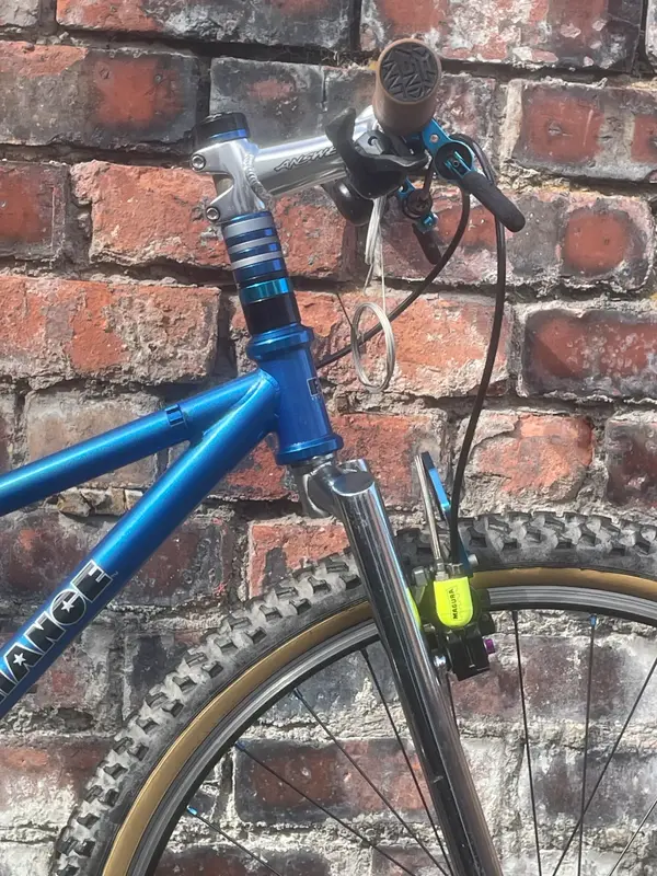

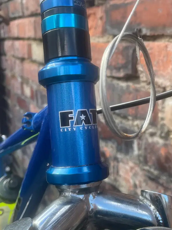

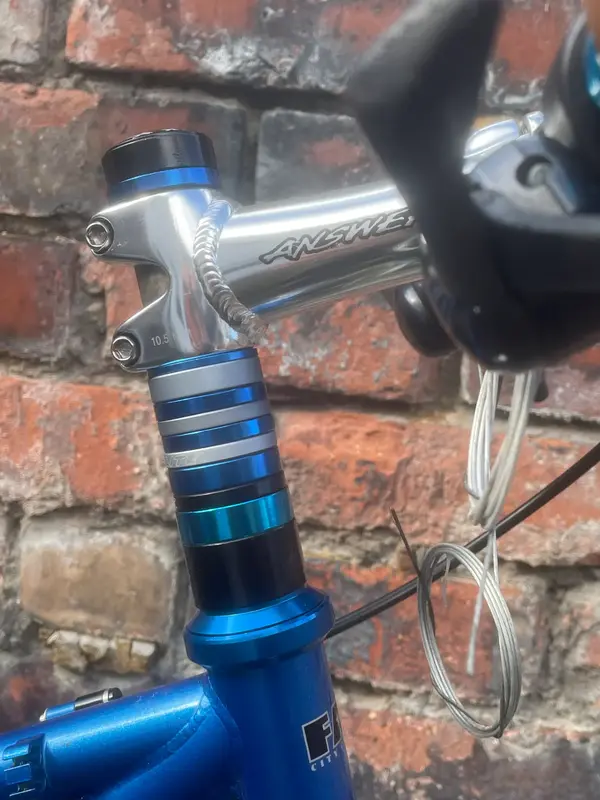

That's quite the stackage on that steer tube. I had a similar setup on a RM Titanium, but was so paranoid about cracking the frame that I sold it.
Tiny frame. Needs must. If it breaks it breaks. Plenty more frames out there.
I've just put an AMP on a P7 frame and they're just sub-zero levels of cool.
A frame that small has to have a back-story as it's super dinky!

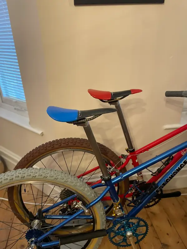

I checked with the previous owner about the Yo Betty and it appears that the extra small size was readily available back in the day and was a friends wife’s bike before it was built for his son. I joined the Fat City group on FB and there before my eyes was a red Yo Betty in the same size. Unfettered and in decent nick. Every fibre of my being wants it. 🤦🏽‍♂️❤️

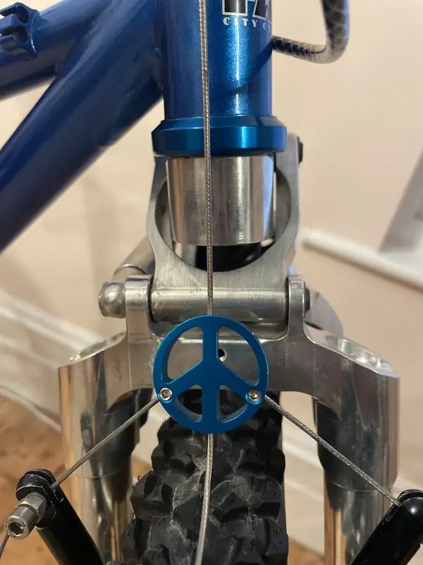

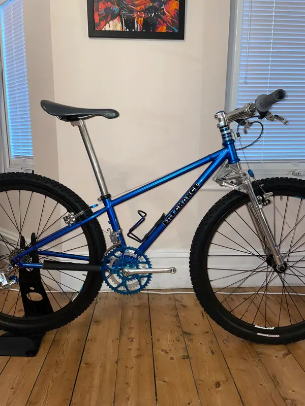

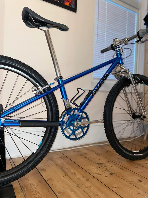

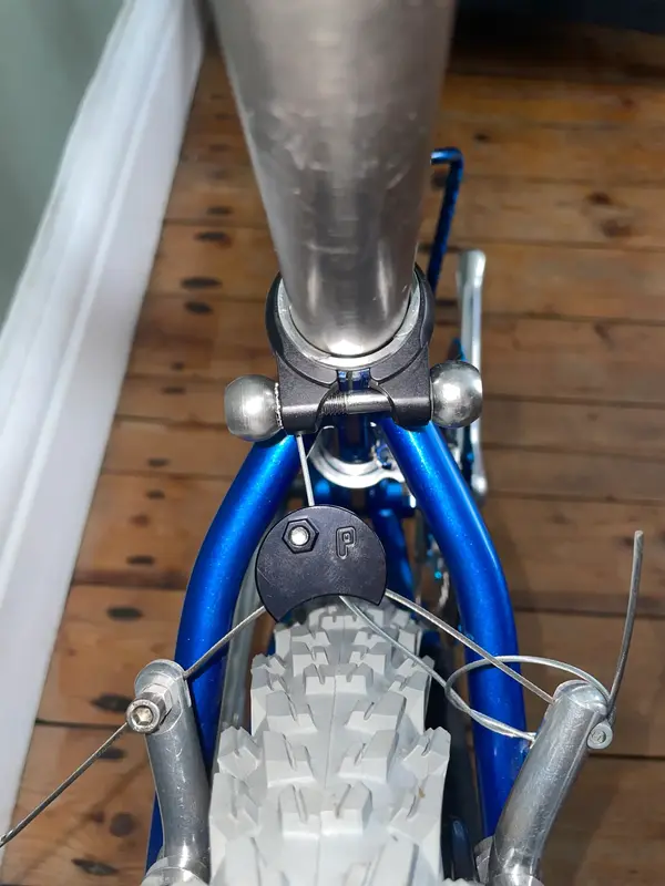

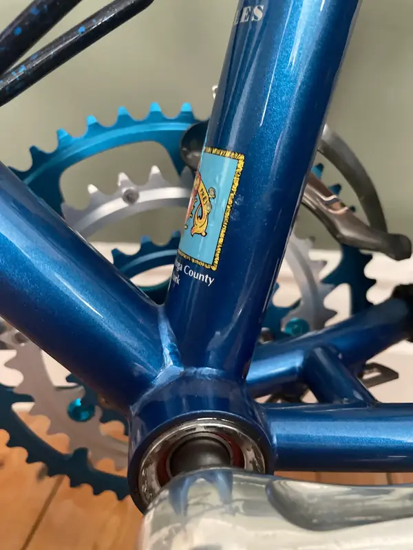

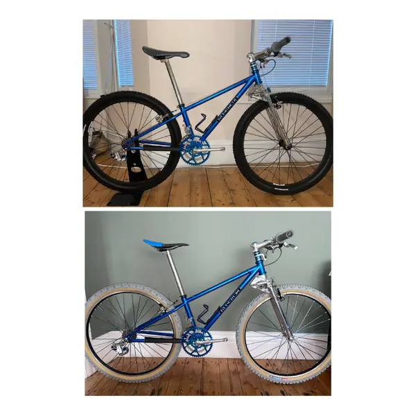

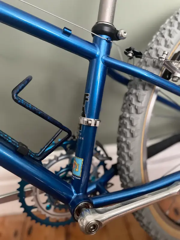

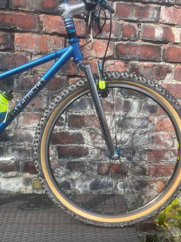

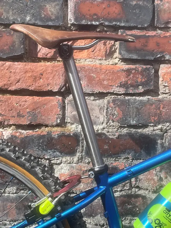

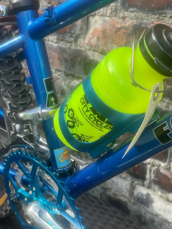

A few minutes at lunch afforded me some time to fettle. Here is the vision.

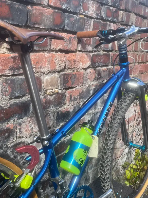

Whilst the 400mm post and long stack will raise some eyebrows, it seems to fit and I doubt will cause any major damage to the frame.

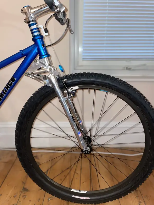

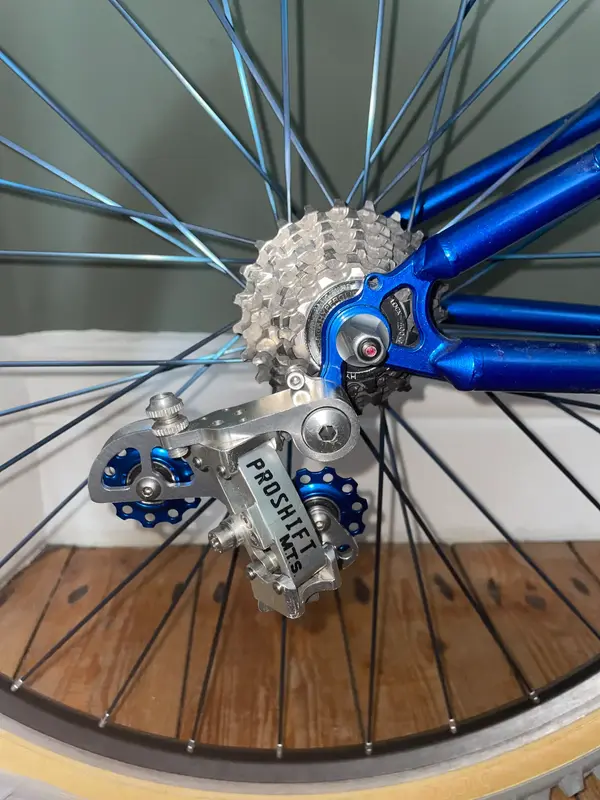

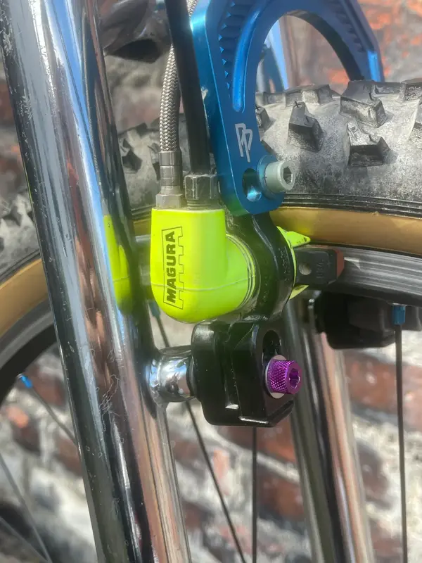

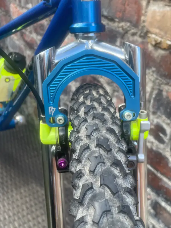

The mismatched brakes/pads opposites seem to work well. They and the moon units are from the parts bin as the other silver one broke. Cheap alloy after all.

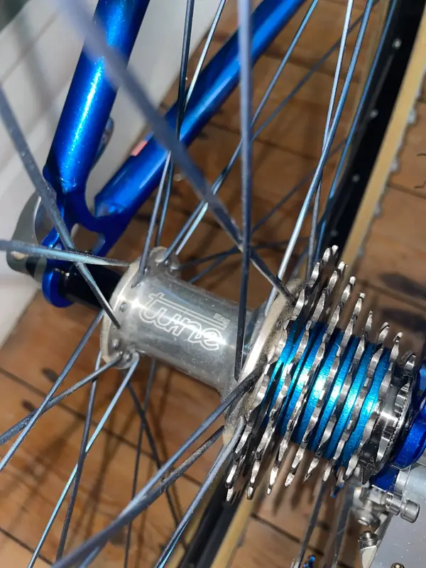

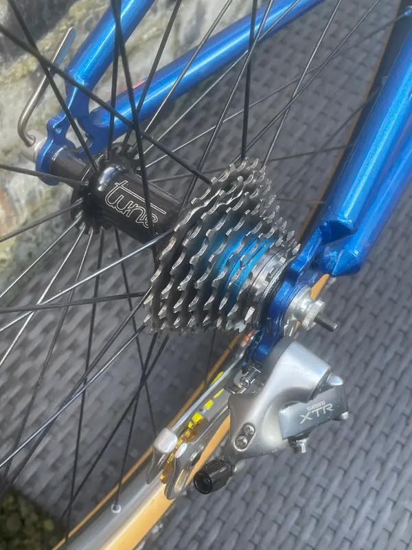

Lots of ti in this bike including the spokes if you were wondering.
Seatpost needs a scotch pad clean up which I’ll do towards the end.

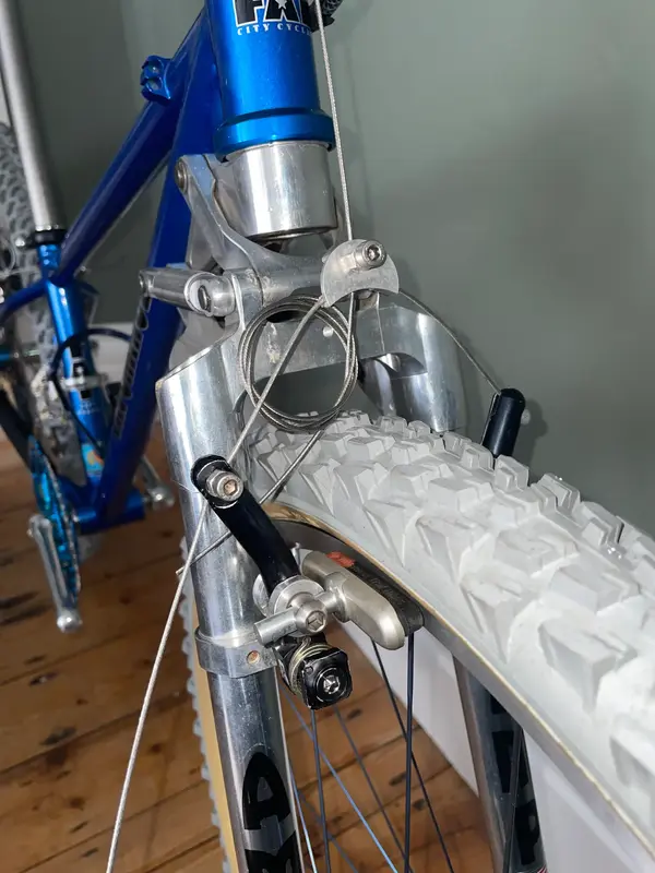

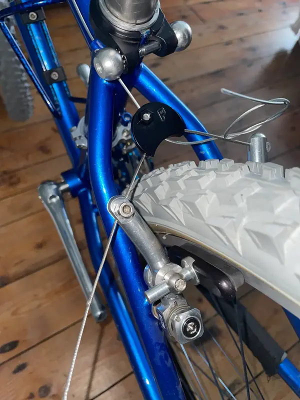

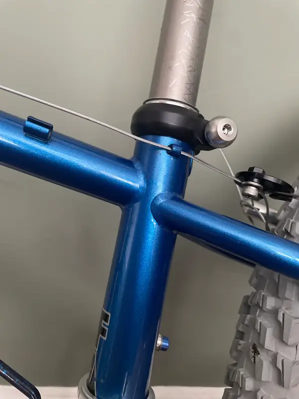

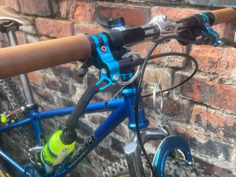

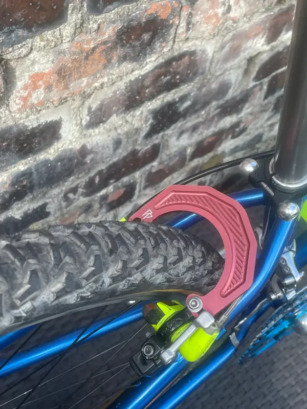

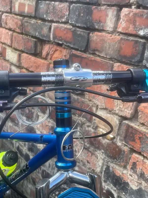

I want to run the down pull Paul front so am awaiting a nifty pulley on a clamp for the lower part of the seat tube which will allow that to work as I don’t like the idea of a top pull being so close to the cable stop. Ultimately that’s what the earlier frames had installed in the frame so that’s what I shall do here.
Some parts I’ll think to swap out but so far it looks fun.

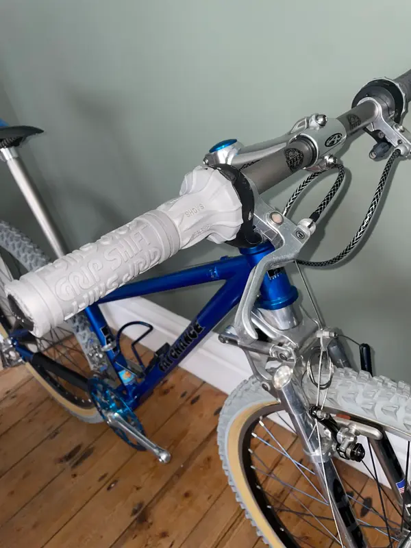

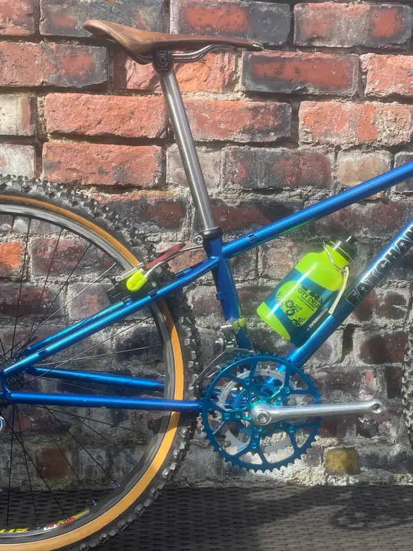

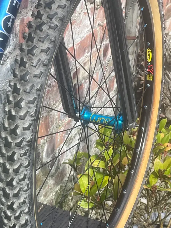

Trying out dark wheels and tyres.
More messing. Really must figure out how to manage the steerer stack. Nice though.
