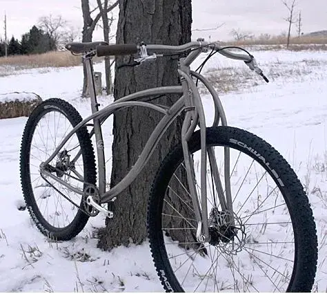

habanero - high value, welded in china but overseen by US-based distributor.
black sheep - boutique american ti from colorado
