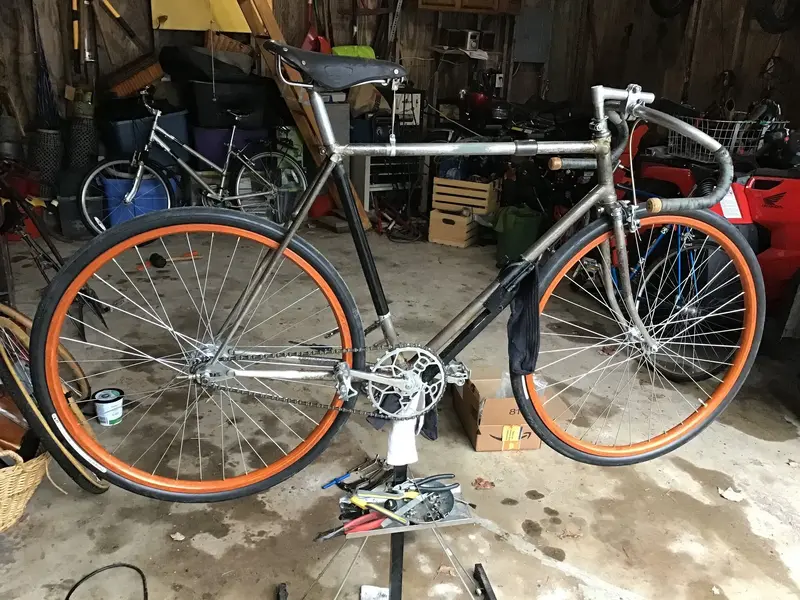

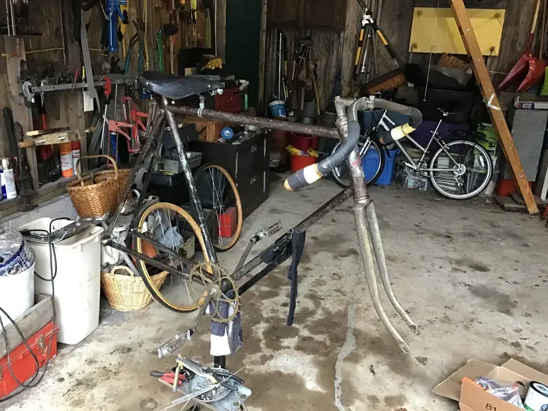

I use wine bottle corks in the end. I wrap the old fashioned way, from the stem to the plugs. It will not unwrap if you use a sealer. If you dont use a sealer your cloth tape will get nasty the first time you have to fix a flat or put a thrown chain back on. I use a very thin coat of quick drying epoxy as a sealer. Then another light coat. The light coat prevents the epoxy from soaking into the bars. You can use more coats. It can be lightly sanded if you want to. You can remove it with a box cutter and peel it. C52BE5B1-C928-42E8-A78B-AD186981D7CA.jpeg
Champaign bottle corks.
3A942F11-27BE-4AAE-8974-1B2158FAE146.jpeg 48BC4BCC-DBC1-4553-8374-5F9D99273A62.jpeg 4522C256-1DF8-47E3-8EBB-2ECB604E89BC.jpeg 79FE732C-398C-4004-8174-8E5D52F161E7.jpeg
I use wine bottle corks in the end. I wrap the old fashioned way, from the stem to the plugs. It will not unwrap if you use a sealer. If you dont use a sealer your cloth tape will get nasty the first time you have to fix a flat or put a thrown chain back on. I use a very thin coat of quick drying epoxy as a sealer. Then another light coat. The light coat prevents the epoxy from soaking into the bars. You can use more coats. It can be lightly sanded if you want to. You can remove it with a box cutter and peel it.View attachment 621587
View attachment 621588View attachment 621589View attachment 621592View attachment 621590

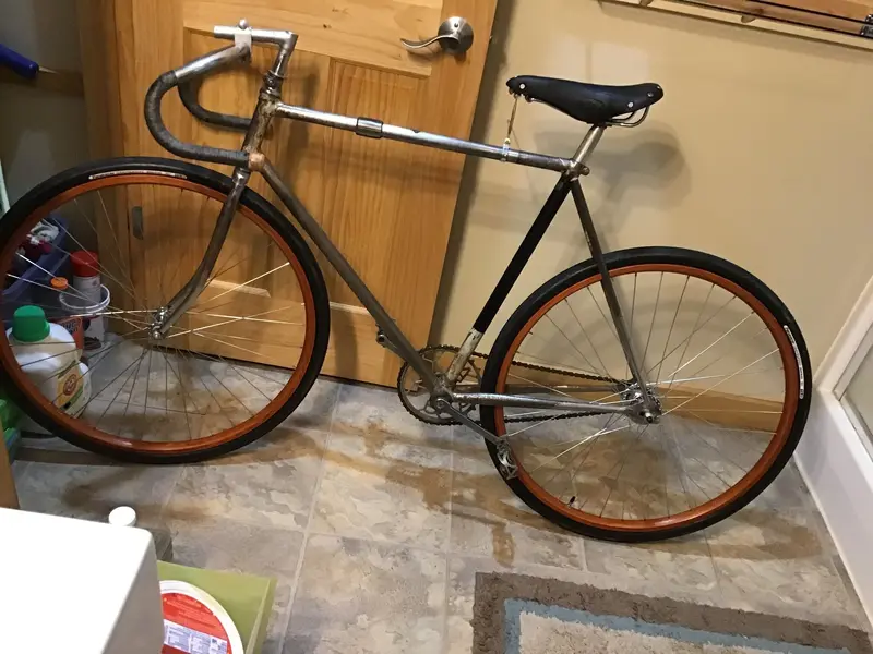

See your woodrims are spoked up 👍
You have fine taste in bikes!

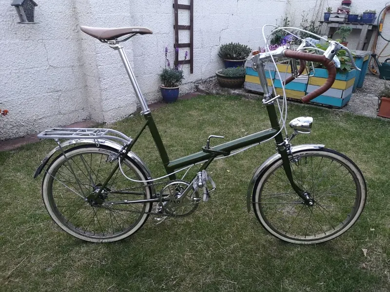

Yellow tape with brown shellac, twine and cork on my Raleigh Stowaway
