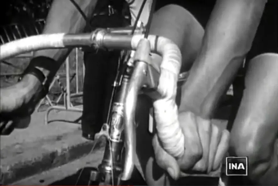

If you look closely at pictures of Jacques Anquetil's bikes you'll notice that the bottom halves of his bars were always pretty heavily padded:

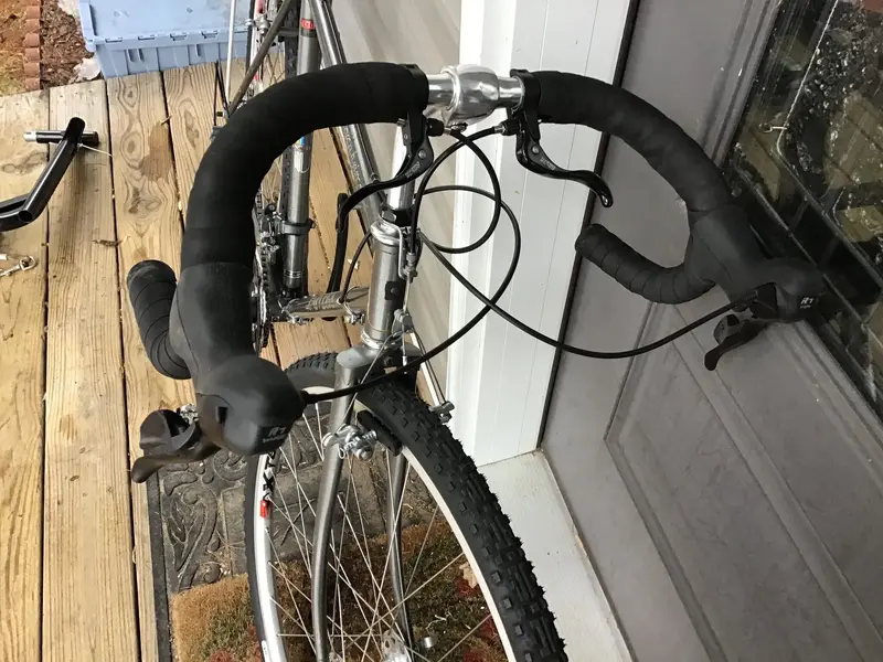

This isn’t cotton, but the concept might work for padding under cotton bar tape. I have ridden this gravel bike anywhere from 75 to 120 miles. I used fairly thick double sticky back foam insulation tape wrapped around the bars. I then put bar tape on top, compressing the 1/2 to 3/4 inch soft foam down under the top wrap. It’s a little difficult to do but for me it works wonders. I’m 76, had carpel tunnel repairs, and I can ride this arraingement all day. I use soft foam top tape to add a little extra. It’s not that thick and is as soft as foam grips. I only use this on my two gravel bikes, the chatter bumps rise heck with my hand comfort without this.0B20B294-5B5B-4384-A9C2-6AA30AD45233.jpeg

Excellent! Anything that makes you enjoy the ride more is good in my book. 👍
And Jacques Anquetil was 25 years old in that picture. Just sayin'.
