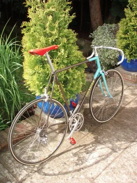

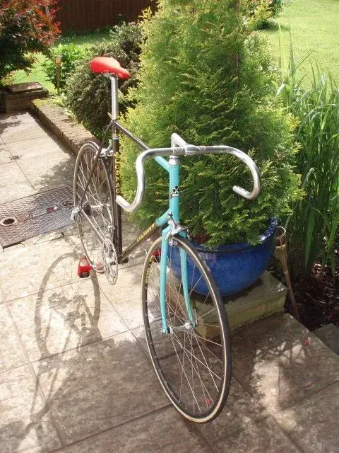

Here's what I got last night, in very semi-finished state but you can get an idea (please, no 5 bar gate comments as I will be unable to come up with a suitably witty rtiposte and so may just sulk).
It's a Columbus SLX frame that is badged Saronni (I understand they were effectively budget Colnagos when Saronni wanted to cash in on his Goodwood Worlds success). It's been resprayed (plus a new b/b fitted and mudguard eyelets, very practical) and the condition is fantastic.
Heretically I intend to build it up with Dura Ace 8, although I think that is the last stylish Shimano road group with nods to classic Campag plus I'm going downtube shofters and aero levers for a suitably period feel. The other point is that it uses the stuff off my Merckx (still available and smaller than this beauty, hence my change) so keeps the cost down - it's crying out for Super Record, maybe one day.

Looks very classy Ed. What vintage is the frame? And do you really ride your road bikes with that much post :o
Thanks John.
I think that the frame is mid 80s or so although I can't be sure of that.
And yes, I do ride road bikes with that much post! I seem to fit a 60cm on all the fit charts (this one is actually a 61cm) but then need to use a long post to get the saddle at what feels like a good height. Possibly my saddle set up is too high but it feels comfortable, seems to work ok even for long distances and in the mountains and any lower feels sort of strange.
Incidentally I use the same saddle height give or take 0.5cm or so whether on or off road and irrespective of bar height.

Thanks Tony, great extra info and certainly adds to my understanding as well as confirming that mine is an SLX.
Best of luck with your sale - no forks?
