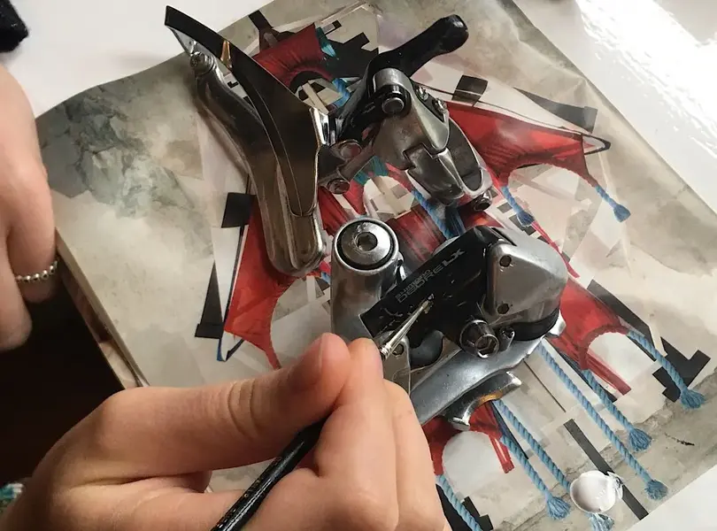

Scarlett wanted to do a bit more colouring in, so who am I to stop her?

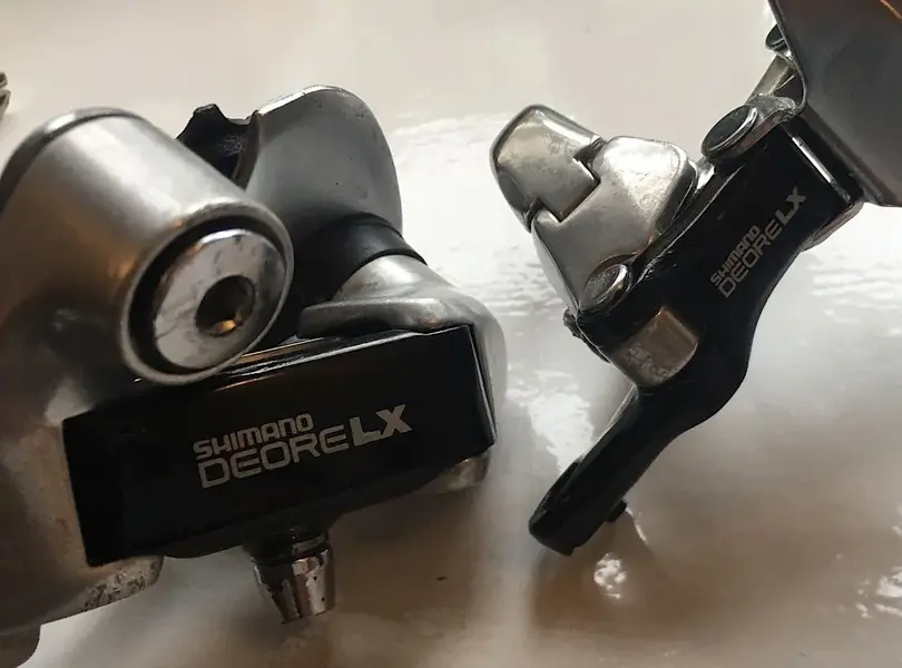

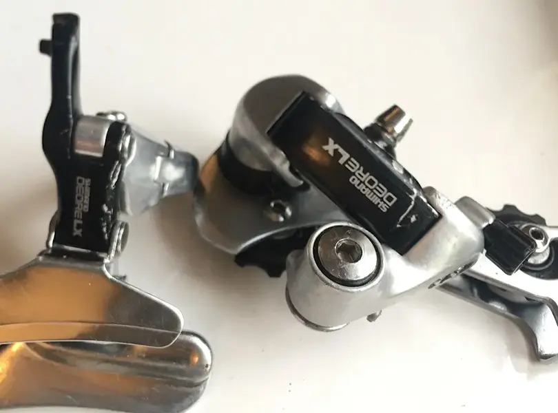

This pair of derailleurs, RD-M550 & FD-M550 are both stamped late 1990 have been stripped, cleaned and serviced, now just need the scratches touching up. Yes I know this won’t pass muster in a concourse competition, but for this fun build I think they look fine.... :D
