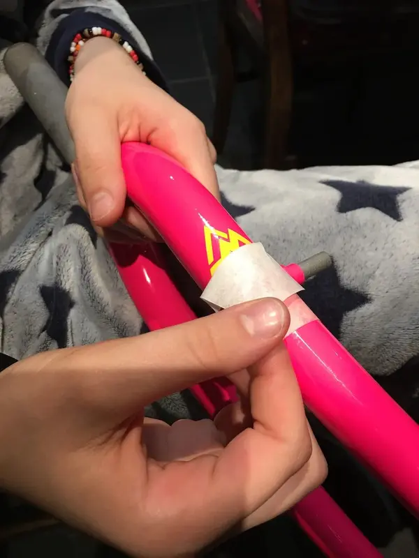

As promised, progress shots of the decal/sticker application..... :D What can I say? chip off the old block, me thinks..... :cool: (NB Jimmy in the background making sure she does it right!) :roll:

Re: Father & Daughter Claud Butler Shaman Silver DofE project
Wow! That is looking really nice. That pink and the decals make it look so much classier.
Watching to see how it builds up but well impressed so far. Job well done to Ms Peachy.
Jamie
Jamie
Cheers Jamie.

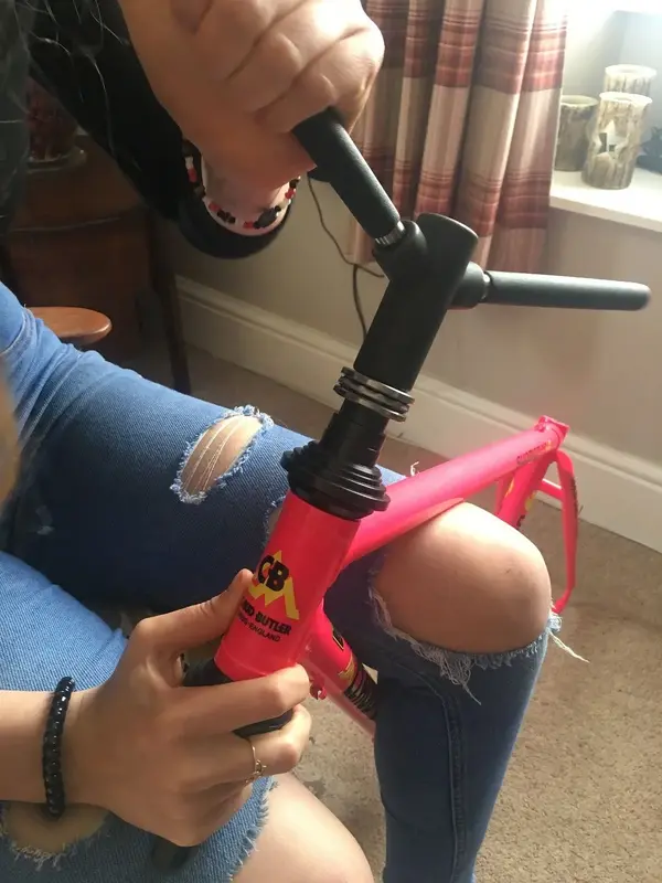

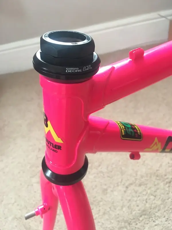

Finally got Miss Peachy to make the next step, fitting the headset… :D
I know the 1 1/8th HP-M564 was a couple of years latter and more a mid-90’s piece of kit, but NOS ones are still around at reasonable prices, so that’s what we are going with.
The Head set clamp I have seems to have been designed for everything other than a 1 1/8th hence it flipped upside down and we fixed each cup separately.
Both went in with no trauma.

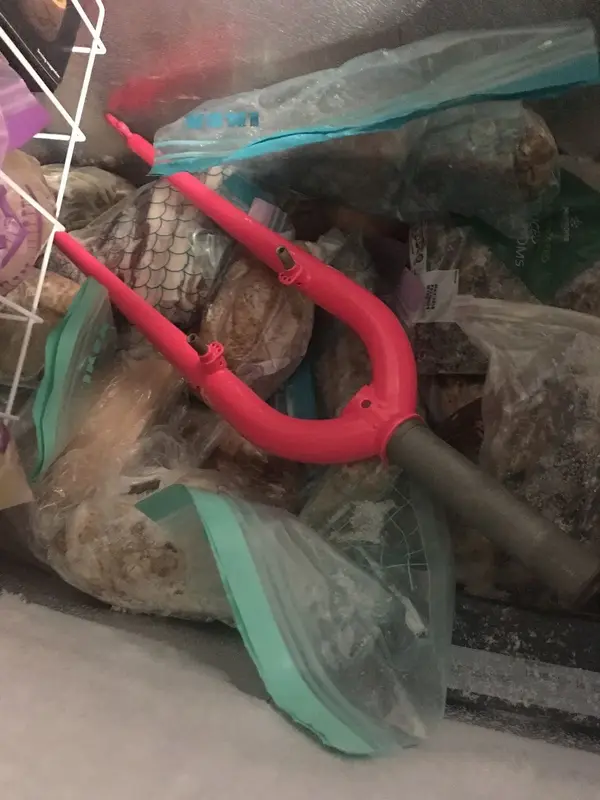

Forks went into the freezer for a couple of hours, lower head cone housing was placed on the bench vice under the heat gun for ten minutes.
Popped into place really easy.
Bit of copper grease to make sure the aluminium upper head cone housing and lock nut don’t seize, and we’re done. :cool:
Not going to push my luck today, but next job will be some wheel building. ;)
Amazing build, really nice project to share :)
Cheers, although I think a theme of only doing the clean stuff is developing! :facepalm:
xxnick1975":3flmrhsx said:
Looks good, headset looks smart
Interesting the Crown race technique.
Yup, the hot/cold routine never fails.... ;)

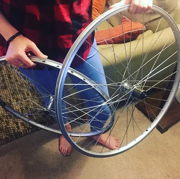

Ok, time for some proper build. :D
I placed a pair of Wolber AT18’s (recently wiped down with a pleasant smelling citreous cleaner) 🤦 a set of LX-M550 hubs, a stack of stainless steel Sapim spokes, a spoke tool and some instructions in front of Miss Peachy, then went to the kitchen to make us a brew…
When I returned, she’d already started.. cracking job too :cool: Wolber Re-build (1).jpeg Wolber Re-build (2).jpeg Wolber Re-build (3).jpeg
