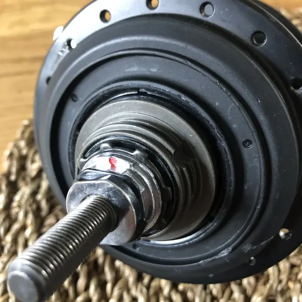

Ok, so this arrived today... I was a bit surprised by the weight!
Anyway.... could someone be kind enough to point me in the right direction of a gear (& how it’s retained)
Ta

It looks like the sprocket is missing and held on by a lock ring
