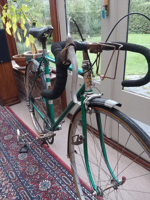

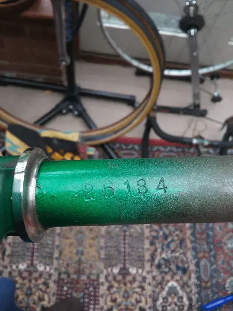

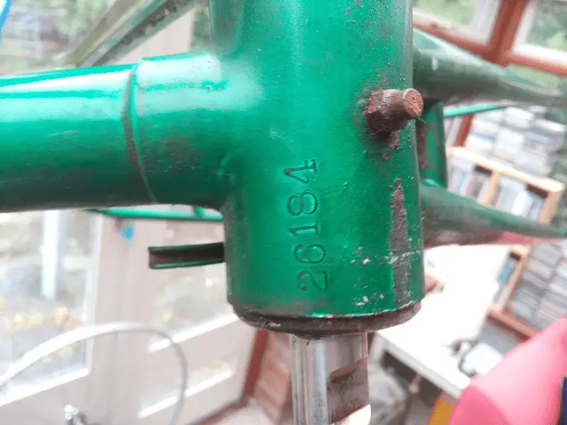

Morning,
Just recently acquired my first vintage Claud Butler, which I've started restoring. In casting about for informtion I've of course also discovered this forum, which seems to be a bit of a win.
Anyway, as I've got it in bits to clean and fix up (and because I'm going to have some proper daft questions to ask about bike restoration at some point) I thought I better get get registered and share some images of the frame numbers etc to this thread.
Bike was bought as a 1962 but now I've got it it seems more likely that it's late '65 (frame number 26184) 'European' 5 speed.
Looks like you've got lots of original stuff still on the bike.... don't forget to start a thread on the readers bikes viewforum.php?f=23
Oh, and welcome to the forum!
Thanks Peachy, yes it seems to all be present and correct, with just the cables and tires not being original / period correct. The chap I bought it from said it was his father's and had been bought new (and that his mum hadn't spoken to his dad for a couple of weeks because of the amount of money he'd spent!).
I'm guessing the bottle cage was an aftermarket part and I'm not entirely sure whether the 'quick release' levers for the brakes are stock? (although they're very neat and work well, so will be going back on).
The only significant problem I'm facing so far is that the nut on the ND crank cotter is just spinning around and not coming off, so I'm waiting to take delivery of a nut splitter to get it off so I can have at the BB. I've not dealt with cottered cranks before so any pointers about an appropriate replacement cotter pin would be gratefully received.

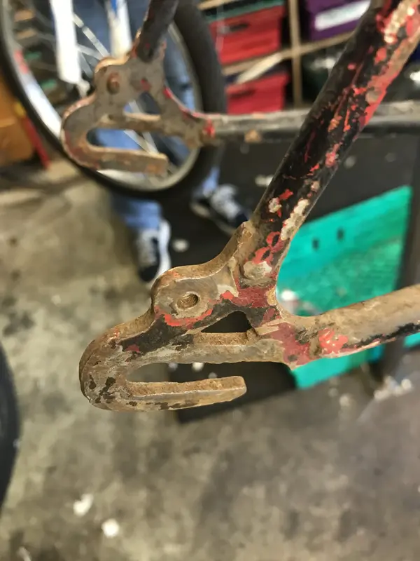

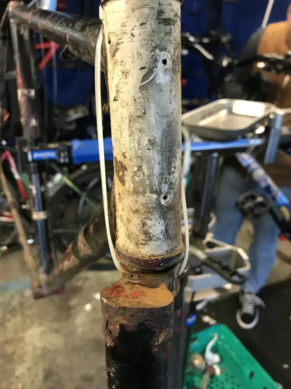

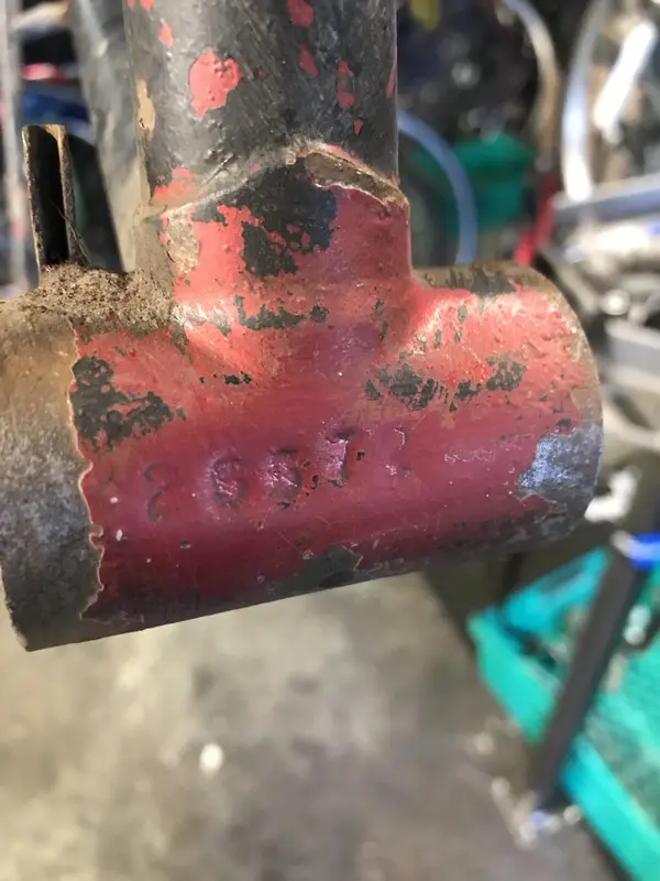

Hi there. I was directed here from the other Claud thread.
I have this frame, Olympic head badge, simple lugs (prugnat?) frame number 56672. Any help identifying would be amazing. So far I’ve been told it’s probably a 1969 model?
White painted head tube, the rest seems to have been painted black at some point over red?

In reply to my above post, first thoughts are ‘69 Electron super 5 but can’t see any in the catalogues that match this finish. Thoughts?
09woodh
Using serial prediction on first page of this thread, #26672 predicts to early 1966. Considering 1966 CB frame features, the simple Prugnat lugs point to either a Spectra, Electron Super 5 or Coureur. (They were essentially identical frames with only distiguishing features being paint schemes and kit.) Using the 1966 catalogue paint scheme descriptions and looking at white head tube with otherwise probable red frame suggest either a "ruby red" Spectra or "bright red" Super Coureur. To me looks like a brighter red in your pic. pointing to a Super Coureur. See CB catalogue @ https://www.nkilgariff.com .
Too further evaluate, was there perhaps kit still present when you received frame? Also if you carefully scrape off some more of black paint in key areas - might find an original name decal towards front of TT or distinquishing band details on ST.
Doug
edited as serial number as written was incorrect
CBguy":1zopqius said:
09woodh
Using serial prediction on first page of this thread, 56672 predicts to early 1966. Considering 1966 CB frame features, the simple Prugnat lugs point to either a Spectra, Electron Super 5 or Coureur. (They were essentially identical frames with only distiguishing features being paint schemes and kit.) Using the 1966 catalogue paint scheme descriptions and looking at white head tube with otherwise probable red frame suggest either a "ruby red" Spectra or "bright red" Super Coureur. To me looks like a brighter red in your pic. pointing to a Super Coureur. See CB catalogue @ https://www.nkilgariff.com .
Doug
Thanks Doug - i wasn't having much luck understanding the guide - AND i've mis-quoted the frame number (26672 as pictured, not 56672)
Not sure if that makes any difference? I'll try to understand more identifying features as I begin working on it.
