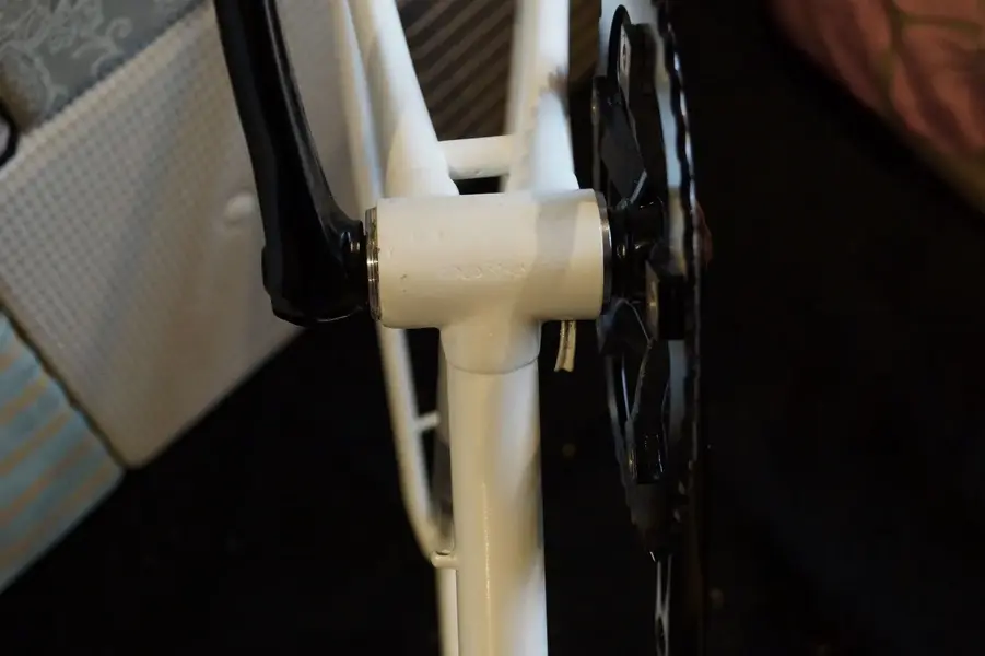

Hi experts,
Firstly I hope that this post ends up including the image that I have been trying to upload. If not then sorry.
I bought this old frame from a bike junk shop, but it had no decals or other identifying features.
It has a serial number stamped under the BB which is 69242, which suggest that it might be a 1975 Claud Butler, as per the frame number chart on this thread.
However the frame has wrap over seat stays and a rear brake cable bridge, which do not appear to be consistent with CB's.
The lugs I think are Nervex.
The frame number is stamped one number on top of the other, as opposed to side by side: I don't know if that makes a difference?
There are no other identifying marks that I can find elsewhere on the frame.
The stamped number matches one on the forks too.
Can anyone out there tell me if it is a CB, and if so what model CB?
I want to have it restored and want to ensure it is detailed correctly.
Apologies for the current paint job. Home made and probably done when I had eaten too many cakes; sugar rush.
Thanks for reading.
Kinch

Looks like a late model (1969) Top of the range Cordon Bleu. Not from the 70’s. any chance of some close-up clear photos of the number, the one stamped into the fork tube is usually clearest.
Close up of number stamped on fork and also seat stays.
Kinch

Kinch10
One of builders that used vertically stacked numbers on BB (if that is what you are describing) was Reg Collard of WFHoldsworth, Putney Shop. If so 69242 would suggests c.1970. Features suggest a custom build. How about a pic of BB numbers!
Genius. I knew someone out there would have a clue. It had always seemed to me that it may have been a bespoke build of some kind.
I will try to post a picture of the BB frame number.
Thanks for your knowledge. Much appreciated.
Good call Doug
I think that pic of vertically stacked numbers cinches it. Frame #69242 must be a c.1970 Putney shop "Holdsworth" and built by Reg Collard.
The Putney shop at that time had it's own numbering system. From 1965 the first two digits identified year of build. For some reason from year 1969 until ~1973 custom builds by Reg Collard and later Tommy Quick persisted with the prefix 69. (Tommy Quick appears to have placed his numbers along edge of BB and not vertically stacked as Collard.) With an average of 140 shop builds per year this would place #69242 as c.1970. See dwscrimshaw's Holdsworth/CB prediction.
