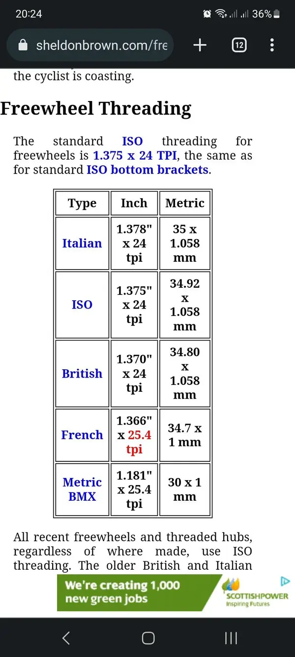

Thanks for the links @Guinessisgoodforyou do I need to consider the different iso threading standards? I noticed on the Sheldon brown website there is a list that states sizing based on country of origin?
If so with it being a British hub would I need to try find a British or equivalent freewheel?
I'll await @vcballbat to see if he can confirm your suspicions on maximum teeth count
It should be Brtish thread mate, so this simplifies things. Onwards :p Edit it may be marked at the base of the thread.

I'm pretty sure you wouldn't need to worry about the freewheel threading. I've put older Shimano Japanese freewheels on both British and Italian threads before now with no problem. If the hubs were French some warning bells would be going off.
