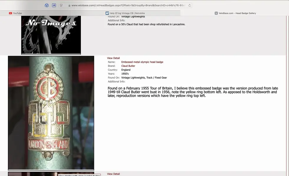

The headbadge Is shown in the 1961 catalogue (under Holdsworth ownership) with yellow bottom left ring. The 1959 catalogue states “The text implies that the Claud Headplate is already being fitted, though pics do not show it. The European looks to have a seat tube decal applied on the head tube, as on the very earliest Holdsworthy Clauds”.

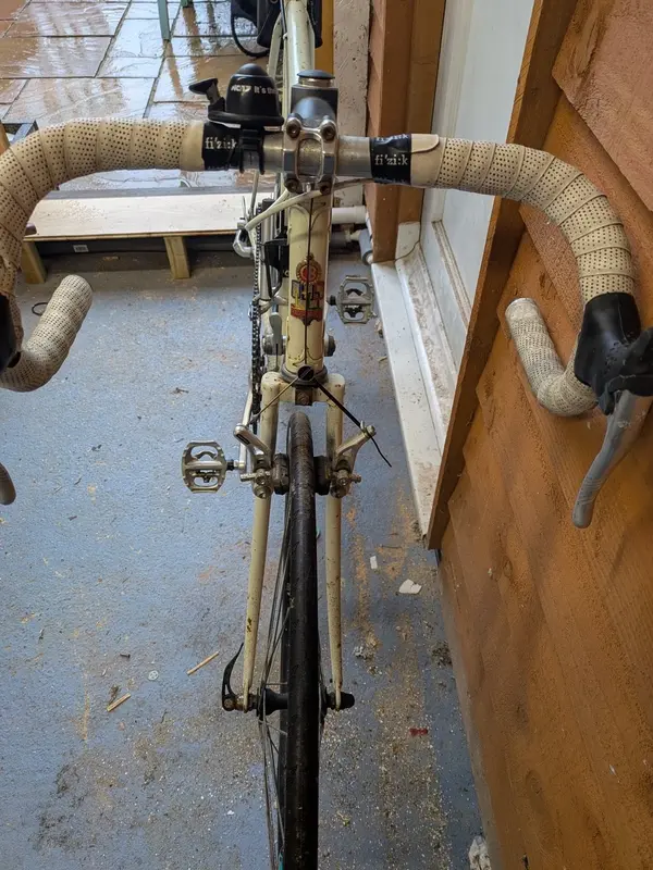

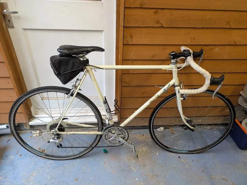

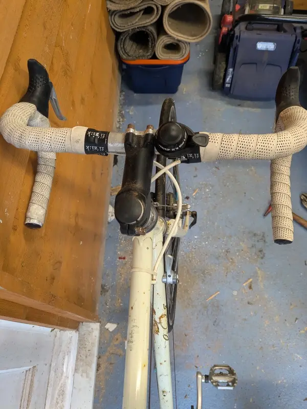

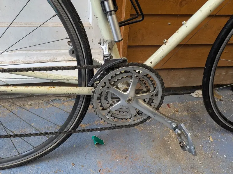

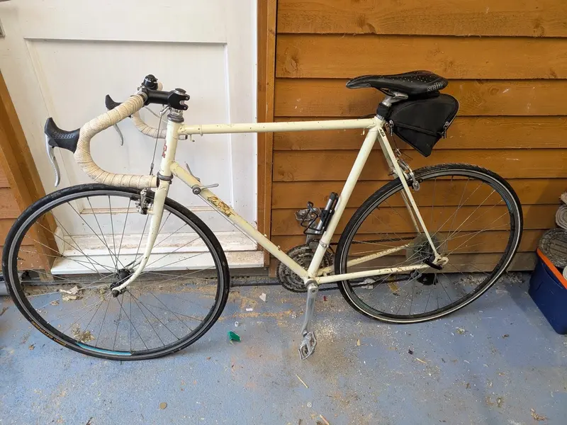

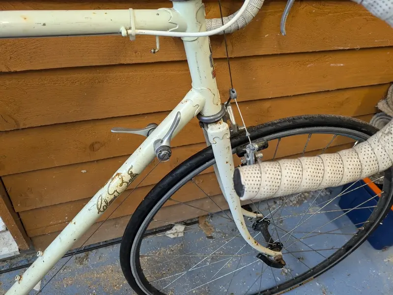

Got some more photos :) Also found another bike! Re. the white bike above, the serial number on the fork is 6246. From what I can see that dates it around 1948 but still no idea of type and value. And help much appreciated
PXL_20250209_113218828.RAW-01.MP.COVER Large.webp PXL_20250209_113229870.RAW-01.MP.COVER Large.webp PXL_20250209_113231710.RAW-01.MP.COVER Large.webp PXL_20250209_113236404.RAW-01.MP.COVER Large.webp PXL_20250209_113243742.RAW-01.MP.COVER Large.webp PXL_20250209_113252493.RAW-01.MP.COVER Large.webp PXL_20250209_113310329.RAW-01.MP.COVER Large.webp
Re your serial number on the fork, I don’t think you know that the fork is original as it has cantilever bosses brazed on. Can you find another serial number elsewhere? Bottom bracket?
Hi Wings. Fairly certain they are the original forks. My dad had someone do a bit of "upgrade" work on it a while back (30+ yrs) which I'm fairly certain included adding on various brazing for modern fittings. I did check the bottom bracket but nothing there.
